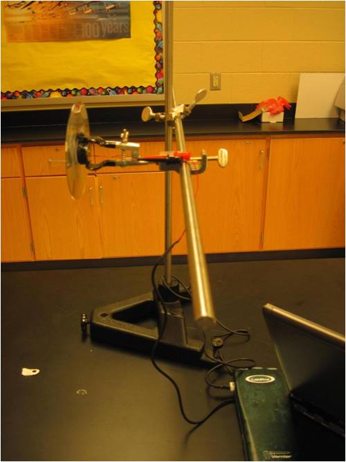

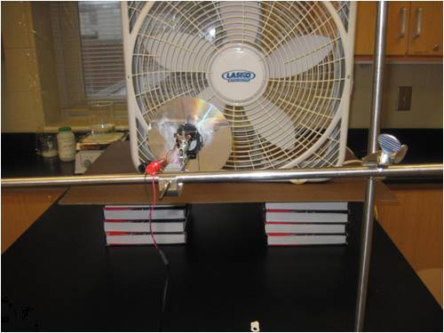

Posted: 02:26pm 25 Feb 2010
Here you have some pictures
Gaby Muino

Can you post a close up photo of the back of your generator setup.
Will check back tomorrow as late here now.
Pete.
gabymuino
Joined: 25/02/2010
Posts: 26
Posted: 07:29pm 25 Feb 2010
Mine is just the same as a standard CD player...
I just took a part an old CD player and I connected the two wires (black & red) to the voltmeter, to measure the voltage that the CD windmill generates.
Gaby Muino
