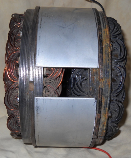

I am talking with some friends about stretching the case on a gm alternator(10 or12 si) to accept 2 stators. Is there any problem with how close to each other the stators are?
I was thinking 1/4 inch between them max?
This would make a system similar to The F & P doubles.
The stretched alternator should wind up around 2 inches longer than stock. There is one problem with the fit up but I think I can work it out.
We could use two permanent magnet rotors or make a new one long enough to serve both stators. Install magnets to suit.The GM Alternators are still readily available in the USA. I have a couple pictures on Bubs camera Ill try and get up in a day or so. This resizing the pic's is a pain.

This is a tentative Idea.
isaiah
Joined: 25/12/2009
Posts: 303
Posted: 03:33am 17 Feb 2010
MacGyver
If you get a stator for 24 or 48 volts and a permanent magnet rotor it will cut in much lower
Bub has one with the 24 volt stator and one of those rotors off ebay
that puts out useful voltage at 200 rpm.
Thus the Idea for two stators one wound for low wind the other for average wind speed.
We figure on putting the rectifier and caps or what ever down at the combiner box.Edited by isaiah 2010-02-18
