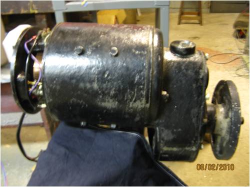

Can anybody help me identify the model and votage of my Dunlite Wind Generator. The only information I have is the serial number 10326, the field resistance 50 ohms and the armature resistance measured bettween the two brushes 13 ohms. I have had it for over 30 years and when I bought it I was told it was a 48 volt ex PMG (now called Telstra) but I would really like to confirm this before I try to put it into service. I think it coud be either a model L or M. I was even able to buy 3 brand new blades off Dunlite back in the 70's but they could not help me with any other information. I am hoping it is a 48 volt model.

Thanks for the quick reply, here is a picture, I have seen the link you mention but although it is a very good archive of information, it not help me indentify my machine.

It is either a L or M. To tell, you need to work out the gear ratio to tell. I do have a copy of the manual if you want a photo copy. If it did come from PMG, it will most definitely be 48v. Other than running it, its not easy to tell the voltage otherwise.

James, The gear ratio as near as I can tell is 3.5:1

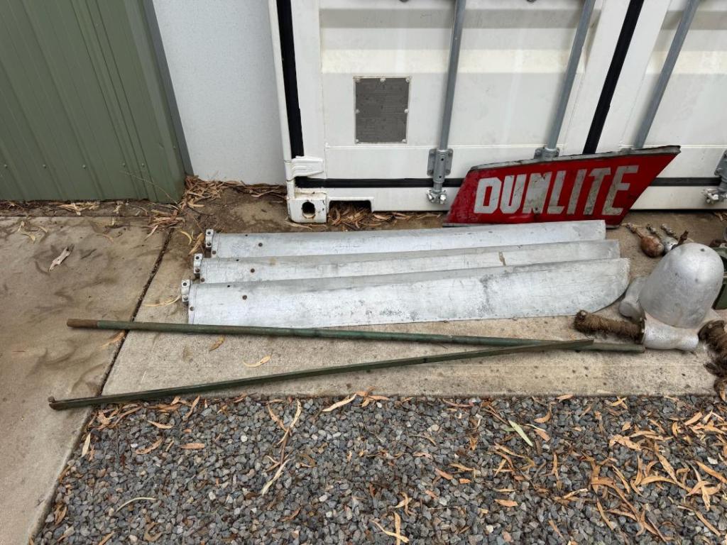

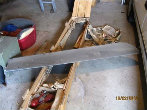

Karl, Picture attached of the new blades as requested still in their wooden crate , they cost me $265.00 in 1980.

Picture of new Dunlite blades still in their wooden crate,

Hi Don I have a old Dunlite as well that Iam giving a birthday to and I see you have some red bob weights in that crate.
Could you do me a big favor and take some measurements of them Iam missing these parts.
A weight would also be helpful.

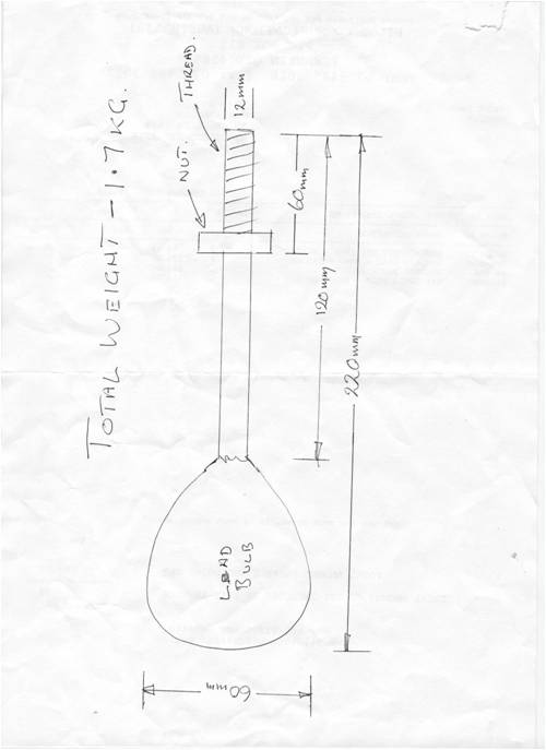

Hello Darren, Attached a drawing of one of the bob weights, you will have to make a mould for the lead somehow. In return could you do some resistance measurments on your machine for me, please measure the field winding(s) resistance and also between the two brushes in contact with the commutator. Do you also know the model and voltage of your machine?
