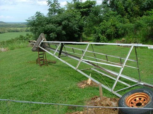

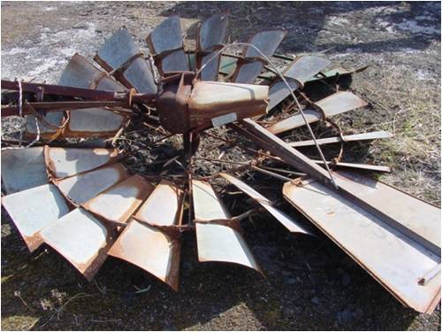

We dropped my Southern Cross windmill yesterday, literally. My neighbour Russel was over with his backhoe and we tied a chain around the mast at the 2nd cross brace down, about 4 foot down from the platform. Russel took the weight while I undid the bolts holding the tower to the concrete posts. I was a little worried the mill was top heavy, so I tied a rope to one leg and held on as Russel lifted the mill clear.
Well it was top heavy. As soon as it cleared the concrete posts it tilted over, and I couldn't hold the rope tight enough, started slipping and burning like hell so I let go. The windmill, tower and all, did a mid air flip and the turbine hit the ground.

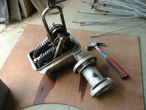

All OK, but bent turbine. The turbines on these things are made of segments that can be separated, and it only bent 2 segments back, so I can easily fix it with a vice and hammer.
I took the tail and turbine apart, and slid the nacelle off the tower. I enjoy working on these old mills, its all split pins, 1/2 inch nuts and gear oil everywhere, like working on a old car.

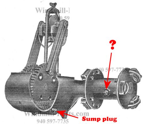

I do have a question though, there is a bung on the side of the turbine hub, and I dont know what its there for. The graphic below shows it.
This isnt the sump bung, but its the same size, on the side of the hub. Would anyone know what its for and if I'm supposed to do any maintenance with it?

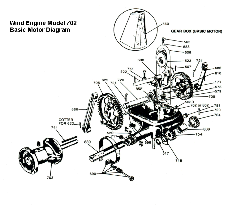

I did have a link to a exploded view of the old Z series Southern Cross, but the link doesn't work anymore.

It's the top level for the oil, you wont have a dip stick to check the oil level, this is the dip stick you undo that bung and add oil through the oil filler opening untill it starts to dribble through the hole, then replace the bung.
You will notice from the pic that the bung with the ? is just below the centre point of the cogs to the left, this ensures that the turbine shaft & the pump cogging are lubricated.
The same oiling method is used for outboard motor legs you undo the bottom bung & screw the oil can into the bung thread, you then undo the top bung & push oil in untill oil seeps out of the top bung hole.

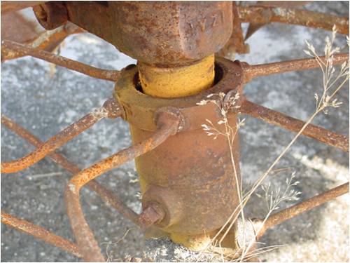

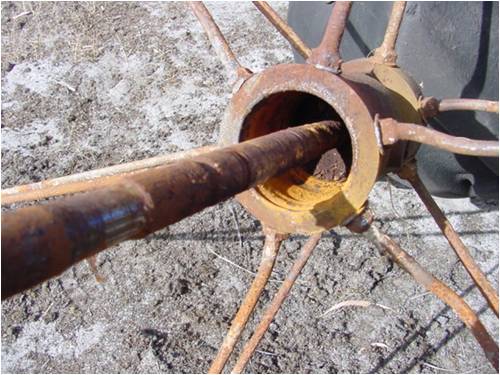

I went up the scrub and found this:
It was not well. Fell over in a storm and the owner dumped it here.
Here is the clearance from the hub to the casting. There is no way a grease fitting of any kind would be useful here. That theory is out I think.:
Here is the offending bung. It is straight through the hub to the big cavity. Note, the part of the casting with the bung, does not hold the shaft. That thinner last 2" or so is the only part that contacts the shaft steel. It has no grub screws, pins or any other mechanism to lock the shaft in. It is multi ton press fit ... and thats it. Any other system would not work, as there is not enough shaft to sensibly stabilize the hub to shaft if the fit was not very very very tight.

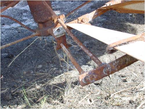

For those curious, this is how the spokes are set up:

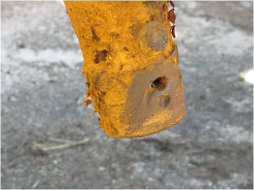

Here is the inner of the hub. 80% of it is hollowed out. You can see the ribs there. These keep the oil from the shaft rotating around the inside for reasons unknown. I suppose it does keep oil around which is good.
This next shot is the clincher. Notice the teardrop depression in the cast coming from the hole. This directs the oil away. It is this hole where the oil from the journal exits, so it leaves from the highest point, so the shaft should be floating in the oil in the journal.
It weeps out this hole, and runs down into the hub ribs.
So I think that about covers it. That bung does no more than empty whatever water and oil has accumulated since the last service.

A few posts down, Greenbelt links to an explanation of the self oiling mills.
It turns out the oil runs out the end of the journal, into the hollow hub, where those ribs keep it captured.... as I said.... BUT- It then drops down during rotation and runs INTO that rear drop not out as I stated.... and then is directed back to the gearbox.
