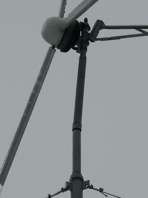

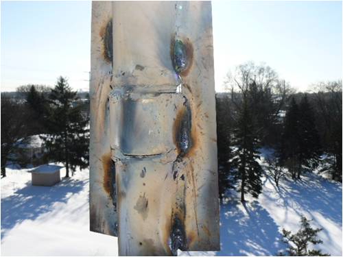

My Christmas present came early this year!!

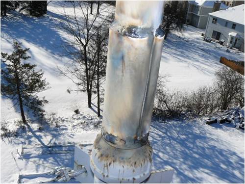

This is what I get for not using a solid mast or and not welding the coupling to he pipes.
If I am not mistaken looks like the coupling is cracked.
I am Dam lucky she's still on top of the mast and not on the ground.

After shooting more pictures I was able to see that the coupling is NOT cracked. It's just a matter of lowering it down and reinforcing the mast which should be relatively easy.
I did want to do this early thinking that this was a weak point that needed to be taken care of but of course I diden't jump on it so here we are. Hopefully the mast will hold while lowering, I think it will.

A couple quick suggestions: If you are concerned that the thing might topple while you're lowering it, if it were mine, I'd make a sheath out of ABS sewer pipe by slitting it lengthwise and forcing it over the lower part of the mast. Next, I'd shove it up and hold it in place somehow (by magic?). This will prevent that top portion from bending past its critical point and falling to the ground amidst blue words!
Also, I'm a plumbing contractor, so you know I'm not making this up: Threaded couplings come in two forms. One is a straight thread and one is tapered. When you buy steel pipe, it comes "threaded and coupled". The threads on this type of pipe are straight and won't tighten. They are there only to protect one end of the pipe. Steel plumbing couplings (called 'malleable') are tapered; the more you twist them, the tighter they get.
If I were going to use a coupling to attach the uppermost section of my mast, I'd use a tapered one and I'd for sure pin it in place just for good measure.

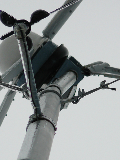

It looks like a sleigh might have colided with the blade , there wasn't a reindeer laying at the bottom of the mast because you will be pretty unpopular guy world wide if there was .
Anyway doesn't look good , I'm sure you will get it sorted soon . It's all a learning curve and I'm sure it will be rebuilt soon stronger and better .

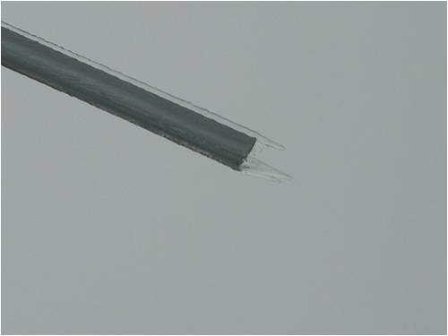

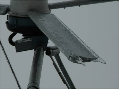

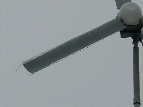

Is that ice all the way through the blade ?

FARQ.....
ICE is fantastic for breaking things, causes massive imbalances etc.
I recall flying to Coffs Harbour from Tamworth one night in a twin commanche (one of my all time favourites)
7000' Lowest safe altitude if I recall.
the ice was coming in thick and fast, aeroplane gets heavy fast, slows down then picks up ice faster as Angle of Attack needs to go up to maintain height. Then the fear of God as inexplicable smashing sounds on the fuselage every minute or so, I thought it was one of those monsters taking apart an engine from the twilight zone movie....
Got on the ground to find dents all over the fuse adjacent to the props, it was the ice getting thrown off in chunks and hitting us.
I would be Very weary of running a mill in icing conditions as otherwise flexible materials become cold and brittle.

If you are using 1 1/4 tapered well pipe for your mast. I would use what is call a drive coupling. These are more expensive than the regular couplings but they are designed for driving the pipe by hand and are threaded deeper ( more threads) than a standard coupling.You may have to find a plumbing supply house rather than a chain store to find them . But it would be worth the trouble.
Most of the pipe fittings these days here in the U.S. are made in China and we have seen a lot of them split or open up in the seem.

The type of pipe threads are tapered. NPT
Truth be told I am afraid to lower it down cause it might break away from the mast then I am totally screwed.

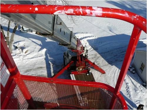

I will get my neiober to bring his crane over and do the repairs in the air.
By women says we doesnt want to hear my bitchen if I lose the mill. (smile)
Just have to wait till he has some free time.

I thought you were NEVER supposed to use those threaded couplings. At least that's what I read in Hugh's and the Dan's books. Add to that, it is placed in just about the worse position for a bending moment. They're usually weak Chinese steel and the tapping of the pipe reduces its area (strength) by about 50 percent. You were right to question this area.
I would use a length of pipe that slips over your pole to make the union. I would think just replacing the coupling is a non-starter.

The photos of the ice on blades was most enlightening as to the weather you get.Hope the above helps.
The couplings that I use are called merchant couplings and are weldable also I would have a set of guy wires just above the joint.
Ken
As good as you are and as bad as I am,I'm as good as you are as bad as I am!
Posted: 03:42am 30 Dec 2009
Considering when you cut a thread you remove 50% of the wall thickness it is not suprising it failed at this point.
Think a pipe sleave over the outside and no threads would be a wiser choice.

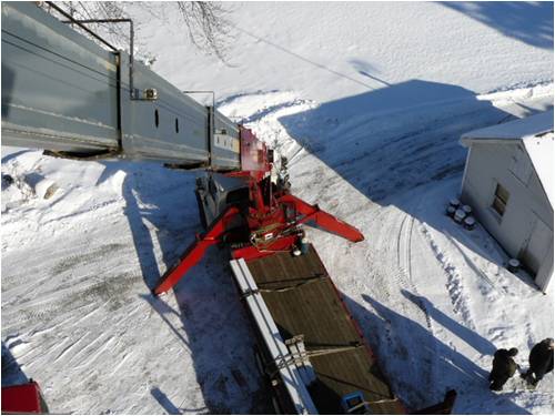

Posted: 04:58am 30 Dec 2009
!!!Up and running!!!
For now this will have to do!
Something fast and simple.
Not the best but looking but it will do the job for now.

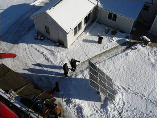

I like the panels too, must keep you busy cleaning snow off them.
is that 2KW I see? good on you!
JimBo911
Joined: 26/03/2009
Posts: 262
Posted: 02:06pm 30 Dec 2009
Karl
That is a 1kw pv setup. We've only had ony 1 sunny day in the last 2 weeks so the PVs this time of year dont produce that much hence the wind mill project.
The crane belongs to a friend of mine he doesn't charge me. I help him and he helps me so it works out pretty well.
Feels good to be up and running again.
