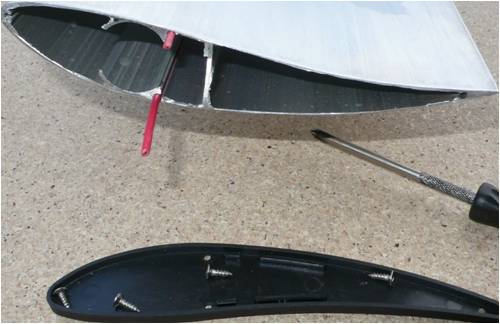

It has taken a while but I think well worth the effort , I have decided to split all this into two posts as there would be too many photos . Here I will mainly deal with my new blade spigot/mount design .
The other post deals mainly with the strength of the blade materials and my obersavations from what I have seen in real terms with regards to " How Much Force Are We Dealing With ".

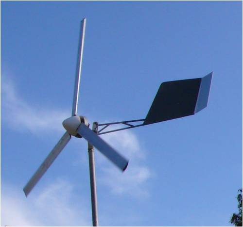

I'll start at the end and work back through all the individual steps and tests I went through to get the first set of Aluminium blades up and flying , I also took on board a lot of what was said in the "New Aluminium Blades" thread and hopefully have addressed a lot of what was worked out there and with what I have learned and observed from the failure of the 3.2mtr pvc set , I now feel confident that I have a set of 3.2mtr blades on the Ax Fx that will stand up to high wind conditions ,forces generated in rapid shut downs, forces generated by yawing & furling and centrifugal forces , but only the test of time will tell .

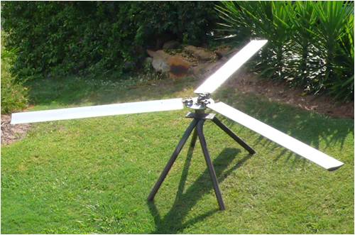

Finished , a stand does come in handy as do sunglasses with these out in the sun .

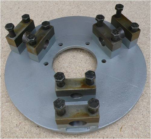

Blade Hub showing the mounts , I set myself quite a few design requirements.
1- MUST BE STRONG
2- MUST SHARE LOAD OVER 3 POINTS AND EACH POINT ABLE TO CARRY THE EXPECTED FULL LOAD
3- ABSOLUTLY NO WELDING IN STRESS AREAS
4- MUST BE ADJUSTABLE IN ALL DIRECTIONS TO GET PERFECTLY SMOOTH RUNNING ( TIP TO TIP , RUN-OUT , BLADE ANGLE )
5- MUST BE EASILY ASSEMBLED , REMOVED AND ABLE TO BE REASSEMBLED IN EXACTLY THE SAME POSITION
6- CAN BE ADAPTED TO OTHER TYPES OF BLADES IN THE FUTURE
7- CAN BE EASILY RETRO FITTED TO ALL FLAT PLATE TYPE BLADE HUBS
8- KEEP THE COST TO A MINIUM
9- KEEP IT SIMPLE AS IT CAN BE

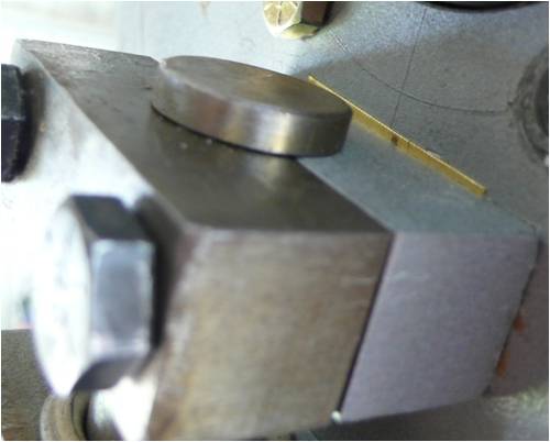

Blade tube mounts and hub , lower outer clamp block is tack welded on the outer face once tip to tip measurement was within 3mm , the inner lower block has a 3mm roll pin to keep it aligned and also allow it to be lifted for shiming to get perfect tip run-out . Not having correct tip to tip will cause an imbalance due to differing lift/pressure loading when the airfoil is working , it might not seem much but I chased a out of balance problem for a week and it came down to one blade being 1deg different causing differing lift at a certain rpm which wobbled the top of the tower.

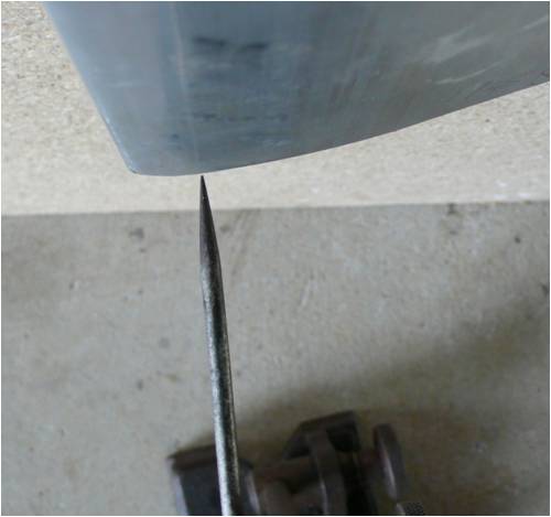

Shows shim under inner mount to set tip runout , .25mm gave approx 5mm at tip
Setting tip run out , having a set up pole and being able to rotate the blades does make it easier, I have found that if the tips are not running true ( within 5mm ) it is as bad as being out of balance and causes extra stress on the the whole structure , I was able to set these to 2mm .

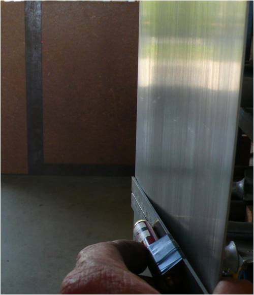

Setting blade angle , as I said above when I chased the out of balance and it came down to a blade being set at a different angle of attack by 1deg , well I did it again when I put these up , I thought I had everything perfect and when they took their maiden first run the tower started wobbleing at a certain rpm , I had set them with a pendulum protractor and probably rushed through this step a bit , so not leaving anything to sight error I taped a small cheap laser pointer to a steel rule and set the attack angles exactly , each blade must have the trailing edge in the same position .

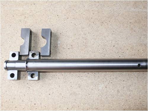

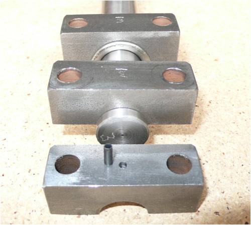

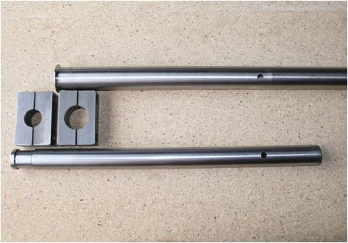

The next set of pics show the blade tube assy and clamps , the clamps are machined out of 20 x 40 - 1020 machined bar and use 4 x 3/8" high tensile bolts , the solid is 22mm 4140 machined bar and has the section cut in to lock into the inner clamp , the 25.4mm s/s tube has a 90deg flare that butts up against the outer clamp block and then the 6mm hole @ 80% of the solid to lock the blade , tube and solid as one . Each section has been load tested and the loads and testing info is next .
Shows solid in tube and sitting in clamps , the clamps can be moved further apart for bigger blade hubs and blades .
Shows roll pin under the inner mount to allows assy to piviot to align the tip to tip measurement , outer holes can be elongated with a round file if needed to get correct measurements before tac welding outer block in position.

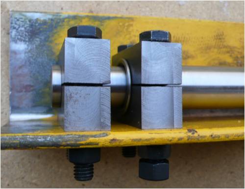

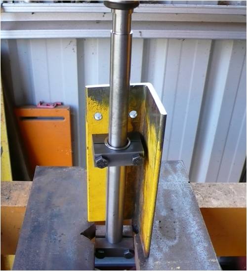

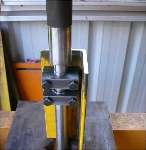

Next is the load tests in my press , first was to mount a clamp assy to a 6mm x 75mm angle , 6mm is the minium I would use for a 250mm blade hub .
The 4140 x 22mm solid shown here has been taken up to ( 6.5 ton ), no damage was evedient to the bolts , the load face of the block was slightly raised from the bolts being compressed into it.
The rear clamp removed and one of the older crimp clamps on the end of the s/s tube to stop the solid pushing through , this was taken up to ( 4 Ton ) with no sign of movement or damage to the flare , it takes up to 6 Ton to do the flare .
From tests I did with a previous design I already know that the yeild strength of a 1/4" bolt through the s/s tube is arround 2 Ton , so with all these tests I feel I have all my bases covered out to the 1/4" bolt , from there out it goes to the strength of the blade material and how it is attached , all those tests are in " Testing Blade Strengths & Forces "

did you do a load test on the assembly under tension ?
would have been nice to anchor the end in both clamps and apply force pushing the blade end away to see what the yield point was
but of course that doesnt take resonant or cyclical fatigue into account , or thermal cycling
but its good to have raw numbers to compare against theoretical calculations

do you really feel you still need the bolt hole through that tube with the flared end and clamping force of the half clamps used ?
if you say the flare is good for 4 - 6 tonne without deformation then wont that be enough ?
and if you really felt you wanted the bolt hole too , then could you move it further away from the end of the 4140 round bar , that hole stands out a bit to me as a stress node origin .

The 1/4" bolt is at 80% of the length of the 4140 , I am sure it says that somewhere , to me that is far enough away from the two main load points not to be of concern , it also locks the blade , s/s tube & solid as one , I tried to incorperate as many shared load points as possible and each able carry the the anticipated max load and then some .
I tested the solid to 6t & the tube flare to 4t , I am not reliant on the clamping force to hold load but to keep the clamps in position and transfere their load to the 3/8" bolts when needed .
Obviously the tests I did are not every load that can be exerted but if you would like to do more comprehensive testing and design and build a more suitable mounting as I am sure you would be very capable off , working in (structual ,hydraulic , pneumatic and power transmission design and manufacturing) , I will send you a sample piece to do these tests .
