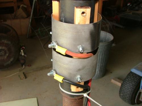

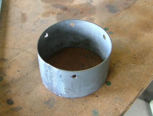

I've been working on a windmill slip ring design built around common hardware store components. I wanted a design that was simple to make with no special tools and used easy to find parts.
I've gone for a brass brush on a steel slipring. This combination may not be the best low resistance materials to use, but....
  • Brass and steel are common hardware store items.
  • Brass and steel have been used for car horn ( steering wheel ) slip rings reliably for decades
This is what I've come up with so far. The slip rings were made from some scrap zink plated steel I rolled and welded to make a ring. Exhaust tube would be easier, but I used what I had in my scrap pile. I drilled 3 holes at 120deg and a extra hole as the contact.
Two rings were made, and supported on 3 timber spacers around the windmill mast. The timber would be fixed to the mast with screws or hose clamps.

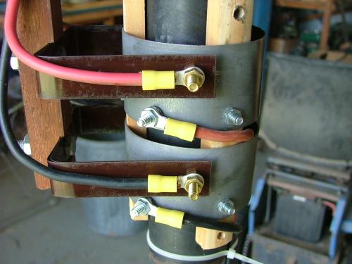

I have 2 versions of the brush holders. The first one uses 2 layers of steel strap ( used for packing, its very springy ). Each slip ring has two brass screws on opposite sides to ensure a good contact. Power it connected at the brass screw, I didnt want to use the strap to carry current.

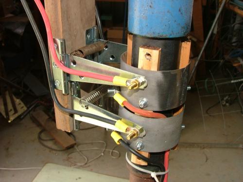

And this design uses door hinges and springs instead of steel strap.
Both designs have a lot of give, so no matter how much I wiggled the windmill nacelle around, the brushes kept a good contact with the slip rings.
So, before I put this hardware store slip ring into a web page for others to use, does anyone have any idea's or can see a problem with my designs? I'm open to suggestions.
In the web page I would mention the obvious, ie waterproof the timber, put a cover over the whole thing, etc.

Maybe a section of 100mm pvc sewer pipe inside the rings and a few pop rivets to secure them in place would give a optical pleasing look not that it would work any better.
The only concern that comes to mind is --- Have you just built a fire starter??
I know it shouldnt, but it could do?
I done a slip ring some years ago for a mini mill and etched some rings on a disc of pcb with some spring metal fingers dragging on the copper rings and this has worked fine for years. Ok not good enough to handle the current these mills generate, but 2 flat rings (one inside the other )are easy to mount and to work with.
The hard part is cutting them out without distorting the metal.
Thinking about it there is no reason why some heavy copper sheet could not be stuck to some fiberglass backing or heavy plastic and a layer of contact stuck over the copper. With the contact cut out where the copper was not wanted and the rings etched as you would a circuit board.
The centre of the rings is cut out to allow the pole to slide through with a spacer on top and a second plate over that with the friction fingers attached to it.(brushes)
The top plate is fixed to the mill head and the plate with the rings attached to the tower.
The rings would sit 90 deg to the tower and not parallel as Glenn's is.
Dont know if this makes sense.
Pete.
Janne
Joined: 20/06/2008
Location: Finland
Posts: 121
Posted: 03:18pm 20 Dec 2009
If the brass won't eat through the zink plating, and the combination of 2 different metals in contact won't cause corrosion.. Might even work =) Brass pipe and brushes are also not very hard to come by...

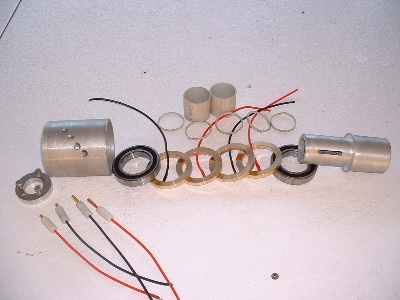

Hi guys ,just got a new gennie ,an Exmork 2.5 Kw machine with 3.8 Mtr blade set.
I photographed the slipring assembly ,,so I thought you may be interested.
Bruce

Very Good Glenn, My only concern would be that the steel pipe will go rusty when the zinc wears off. Certainly a cheap backyard idea.

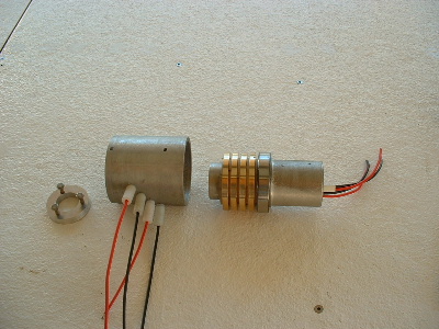

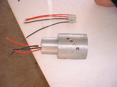

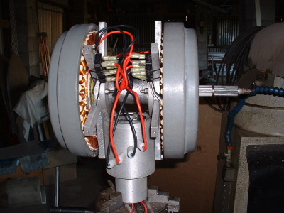

These photos are quite old, but I don't think I ever posted them before. Maybe someone can utilise some ideas from them too.
These photo's are of the inside of my slip ring setup. The 4 pole is what I use on my own double F&P White Pointer. The standard White Pointer Kit only has 2 slip rings. Basicly it is bronze rings and bronze brushes. The rings are seperated by PVC pipe and the brush holders are Nylon but could be made from any plastic, just drilled plastic rod and treaded to screw into the outer aluminium casing. The only thing you don't see is the springs to keep brush tension on the ring. The springs are inside the brush holders.

Yep , made a set long ago out of waste water pipe ,3inch and car brush holders .. A failure.. You have to really use chunky copper impregnated brushes and double up .
Pictured are the Exmork slip rings ,,very sturdy and chunky ,thick cables ,and doubled up sets.
These are pictured on the side ,,rotate 90 to see the actual install
BruceEdited by brucedownunder2 2010-08-27
