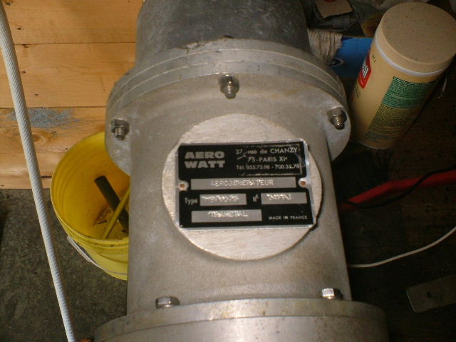

Yes Prof, it has this ,Type 115/60/9
                       No.24FPJ
That is the spec. tag

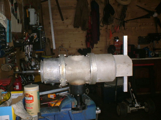

The shaft is 3/4" and I have a motor arbor on it and am also trying to make a tail for it. The shaft has a keyway in it and the center of the shaft is threaded,left hand thread so I would think it was designed for counter clockwise rotation.

Aerowatt made a model 24 FP7 which had a 1 metre 2 blade fan which was rated at 0.015 Kw. They made very tough machines. I think the numbers stamped on the body are just the serial number. I suspect that the type number says it outputs 115 Vac at 60 Hz (Just a guess). Note that Trametal is a European steel company.

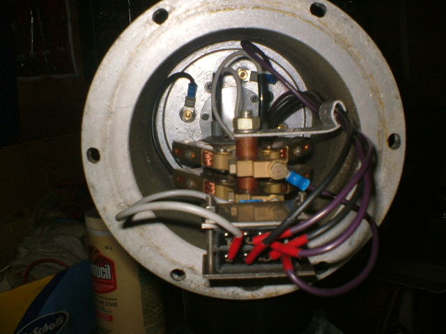

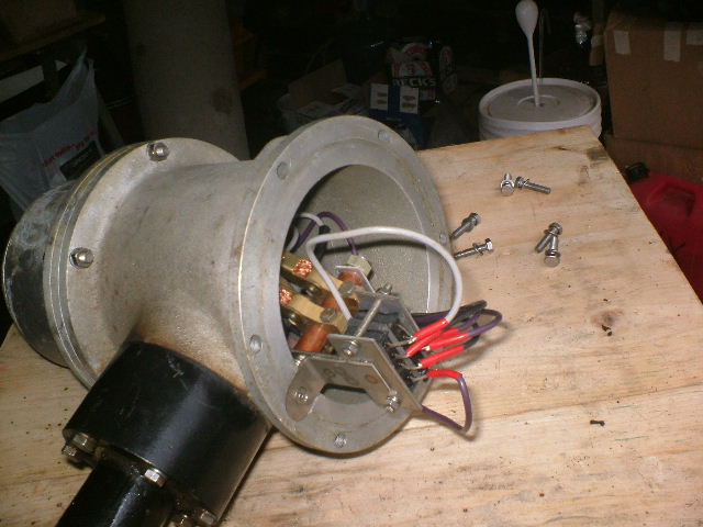

Prof., thanks for those sites they had more info then i was able to find on my own.I did not see any with the model # that I have 24FPJ so I'm still not sure of exactly what I have. Here are some more pics. of the middle section with the slip rings and I would assume a retifier,there are 4 wires that come from the altenator and connect to the rectifier and 2 come off and go the the brushes of the slip rings where another 2 wires from the rings come out of the bottom of the mount.
   Thanks for the help.
