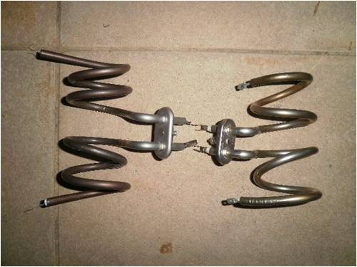

check out the article from the homepage on encapsulated resistors.
They are free (used dishwashers is my preferred)
Cut to length as required for the dump Volts x Volts / Ohms = Watts the resistor will use.
Easy unless you are immersing it in water then will need some more effort to keep water out of where is shouldnt be.

You can bend an element and silver solder it into a 2" ball plug with 2 holes drilled in it for the element to pass through.
If you can find a long element with a suitable bend already in it. than you could shorten it up to suit your wattage requirements.
It will make little difference if it is out of a stove, dishwasher urn or what ever but i do think the dishwasher and likes have a slightly heavier outer casing.
