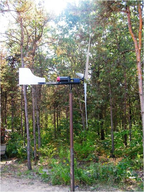

Been looking for a site that is dedicated to home wind power. I just recently finished my second tower 12-4-09 using GE Fanuc servo motors and they work great. Hope to learn a few thinks from the grey hairs and the ambitious people of this site.

nice looking mills! Is that a straight shaft? It looks as if you set the motor back to even the weight on the upright?

  readyakira said   nice looking mills! Is that a straight shaft? It looks as if you set the motor back to even the weight on the upright?
I was concerned that the axial torque of the blades might be too hard on the servo bearings so I made a bearing block and shaft and coupled the servo. I am close to the shore line of lake michigan and wind gust can be quite harsh.

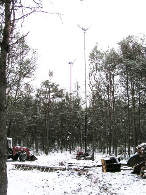

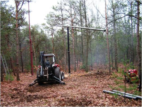

Here’s another pic of my towers. I designed them to break down for ease of service. I used boat/crank type wenches. Works great.

  Dupa said   Here’s another pic of my towers. I designed them to break down for ease of service. I used boat/crank type wenches. Works great.
wenches
Welcome aboard & if you got any more of these can I have one

Bearings in those things should be tough as nails,
are those the windgrabber blades??
Welcome, I too envy the towers more detail please

  KarlJ said   Bearings in those things should be tough as nails,
Karl
I made the blades myself out of aluminum tubing.
