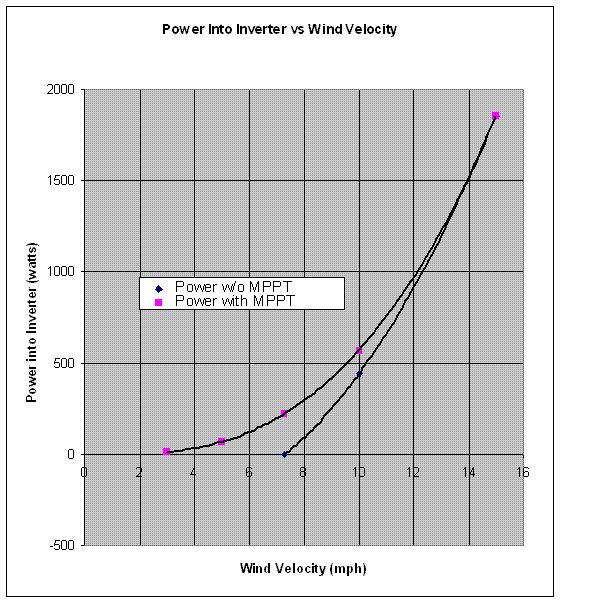

Shown are two plots; one with mppt, the other without. Notice the increase in power delivered to the inverter with mppt. This is especially significant for South Central PA with average wind velocities less than 8 mph.

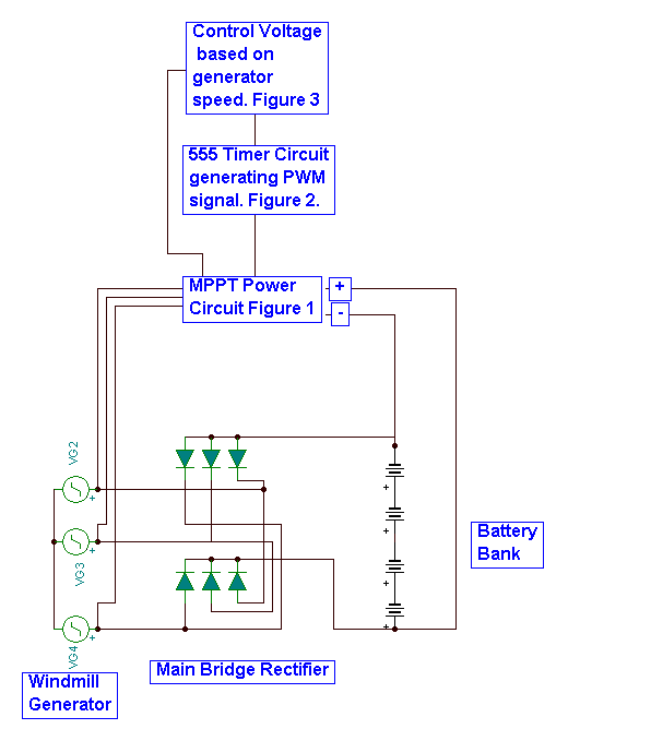

There are three basic sub circuits that make up the MPPT system. The block diagram for the MPPT circuits is shown below:
These sub circuits, are:

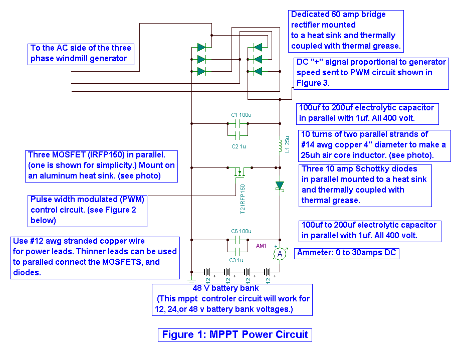

1. Power shown in Figure 1.This circuit takes power from the generator and transfers it to the battery bank. It receives a pulse width modulated (PWM) signal from a 555 timer circuit that is used to control the voltage at the bridge rectifier “DC+” terminal. Controlling this voltage sets the power transferred to the battery and regulates the load on the generator to assure MPPT.

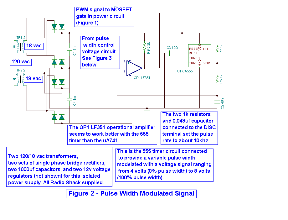

2. The 555 timer circuit is shown in Figure 2. It generates the PWM signal as a function of a voltage proportional to generator speed.
3. The circuit that generates the pulse width control voltage proportional to generator speed is shown in Figure 3. This voltage is also tailored to cause cut in and cut out the MPPT system.
The details of these circuits are shown, below:
1. Power (Figure 1)
The power portion of the circuit is shown here:
It is a relatively standard boost converter design whose purpose is to load the generator so it operates at the design TSR for a wide range of wind speeds. This is achieved by controlling the DC “+” voltage at the bridge rectifier.
2. PWM Circuit (Figure 2)
The PWM circuit uses a 555 timer circuit set up to create a 10khz pulse modulated with a voltage signal ranging from about 4 volts (0% pulse width) to about 8 volts (100% pulse width).

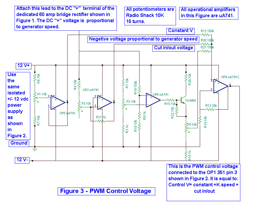

3. Control Voltage (Figure 3)
The pulse width control voltage portion of the circuit is the brains of the MPPT system. The circuit is shown below:

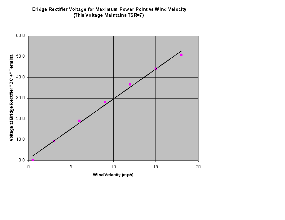

One question that could be asked, is: “How does this circuit provide MPPT through out the selected wind speed range?” The following is my answer:

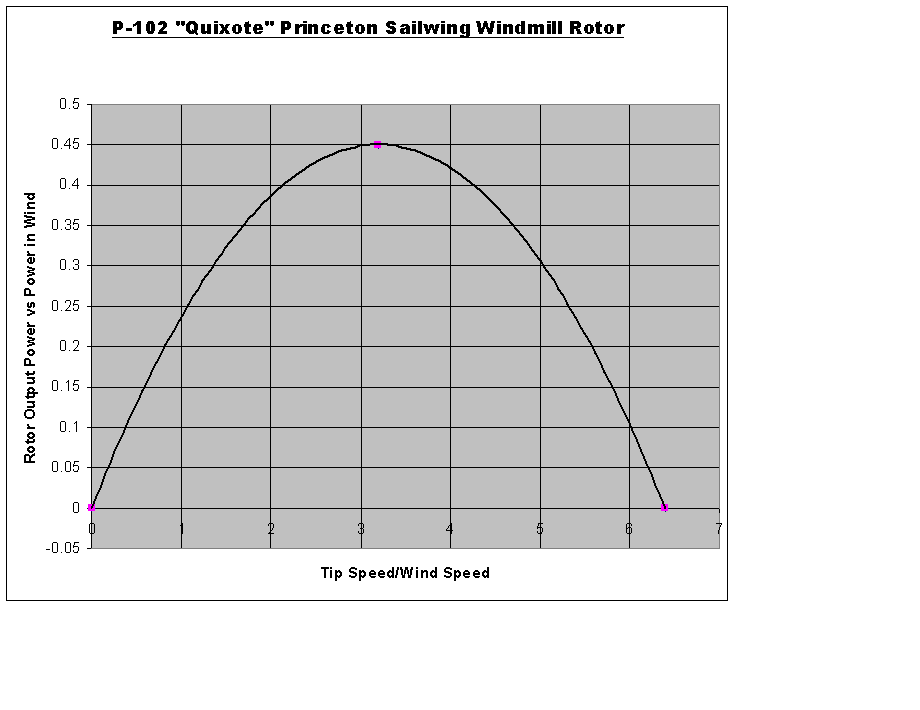

Optimally loaded wind turbines run at about half their unloaded rpm at their design TSR. This can be seen in measured data such as that provided by Princeton University for their sail wing design. Princeton’s data are shown below:
You can see that peak power occurs at roughly one half the unloaded TSR; For example, my 20’ diameter windmill was designed for a TSR=7. Unloaded, it will run at a TSR approximately = to 14.
Our windmills charging a battery bank without MPPT will operate at the design TSR at only one wind velocity. For example, my 20 foot diameter windmill starts making power (“cuts in”) at 7.3 mph with a TSR ~14. Its design TSR is 7. As the wind velocity increases, the operating TSR reduces from 14 to 7 as the wind velocity increases from 7.3 to 18 mph. Above 18 mph, the TSR moves from 7 toward 0. This all occurs with a battery voltage ~ 52 volts.
There are ways to load the wind turbine so it operates at its design TSR for all wind speeds above cut-in. One way involves changing the “apparent” battery voltage in proportion to wind velocity. The boost converter shown in Figure 1 does this by controlling the voltage (Vr) at the “DC+” terminal of the bridge rectifier. The output of the boost converter is clamped at the battery voltage.
Vr is related to the design TSR, as shown in the following equation:
Vr = generator voltage * 3^^.5 at design TSR - I * R drop in generator and line - drop across bridge rectifier
I solved this equation for my windmill and have plotted the results below: (Don’t worry; you won’t have to calculate this for yours, if you don’t want to. There is a simpler way.) I’m showing this for those interested in the physics.
Notice the almost linear relationship between Vr and wind velocity. This occurs because the IR voltage drop through the generator and line resistances are small compared to generator voltage. This simplifies the controls. It also, makes Vr proportional to generator speed, especially at low wind velocities where generator current is low.
The MPPT circuit potentiometers are adjusted to achieve the above Vr, as shown in the System Alignment section, below. In effect, it uses the Boost circuit to provide an apparent battery voltage as a function of wind velocity.

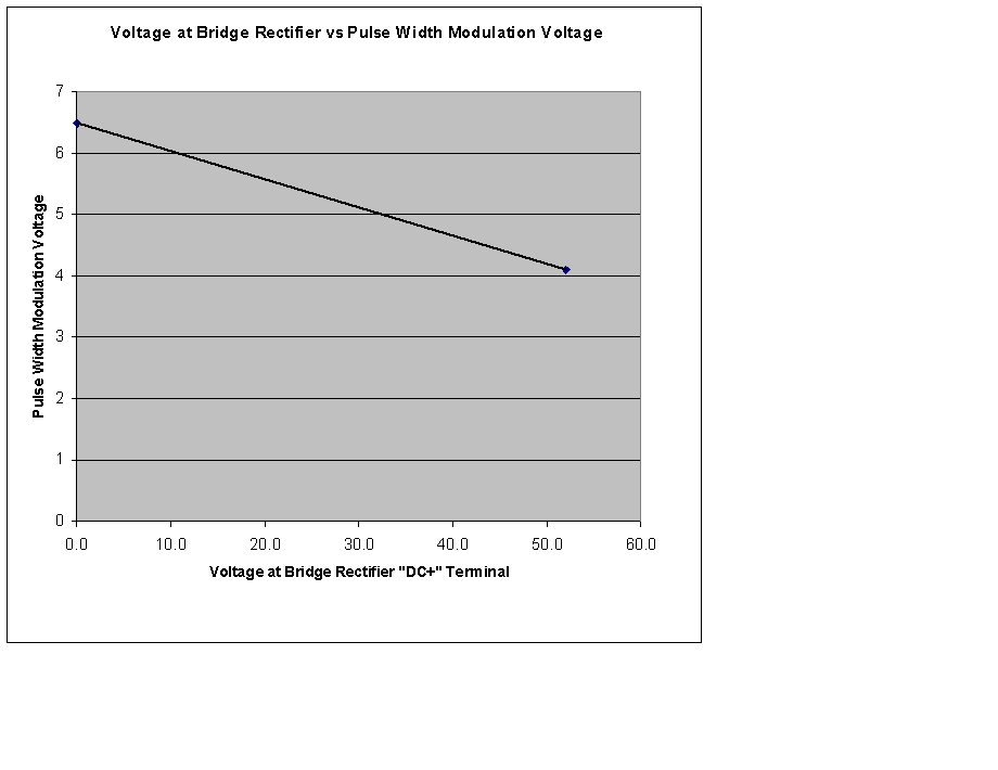

The 555 timer circuit of Figure 2 provides a PWM signal to the MOSFET gates in Figure 1. The pulse duty cycle varies in a way to provide Vr, as a function of wind velocity. The relationship that works for my 20’ is shown below:
This relationship can be achieved by analysis or by using the system alignment procedure covered below. The system alignment procedure is a better choice than analyses because it accounts for “as built” imperfections in the system.
System Alignment
The potentiometers in the above circuit need to be adjusted so the system does maximum power point tracking (MPPT). The following procedure works for me:
A: Preliminary Adjustment (can be done on the bench)
1. Connect all three subsystems together as shown in Figures 1, 2, and 3 with the exception of the three leads going to the three phase windmill generator. Plug in the power cord to the auxiliary +/-12v power supply.
2. Confirm the presence of power on the +12v buss and -12v buss.
3. Adjust potentiometer P2 to achieve the DC cut in voltage/10 that will occur during low (~3mph) wind speeds. I recommend about 20% of your battery bank voltage for starters. For my 48 system this corresponds to about 10.5v/10=1.05v. This cut in set point voltage can be measured on the negative input terminal of OP6.
4. Remove the lead from the DC “+” terminal and temporarily connect it to the battery bank “+” terminal.
5. Adjust potentiometer P5 to achieve 0.00v on the wiper portion of P5. This is also the “cut in/out voltage” at R21 that occurs at generator speeds above the cut in set point voltage of Step 3, above.
6. Adjust potentiometer P1 to achieve a preliminary voltage of about 6.5v at R12. This voltage is constant independent of generator speed.
7. Adjust potentiometer P3 to achieve a preliminary voltage of about -2.5v at R20. This voltage varies in proportion to generator speed. The PWM control voltage (OP4, pin 6, Figure 3) = Constant V (R12)-Kgen speed (R20) should = 6.5-2.5= 4.00 volts
8. Return the lead back to the DC”+” terminal.
9. Unplug the auxiliary power supply.
B: Final adjustment of P1. (should be done on the windmill) Make this adjustment during constant wind velocity conditions between the cut in set point (Step 3) and normal cut in of the main power path. For my system this corresponds to wind velocities over 3mph and under about 7mph.
1. Connect the three phase leads to the generator output upstream of the main rectifier bank.
2. Plug in the auxiliary power supply.
3. The ammeter should indicate current to the battery bank if everything is working properly and if the generator DC “+” voltage/10 exceeds the cut in set point voltage of Step 3, Preliminary, above.
4. Adjust the system to provide operation at the design TSR, by confirming that the generator speed (DC “+” voltage) doubles when the auxiliary power supply is unplugged (no MPPT) during a nearly constant wind condition. Check this in steady wind conditions at velocities under main cut in, but exceeding the cut in voltage set point in Step 3. If the generator’s speed more than doubles, adjust P1 to lower the voltage at R12. If the speed doesn’t double, raise the voltage. Warning: Do not exceed 7.5 v at R12 or you will risk turning the MOSFETS on 100% without pulsing. This will cause a dead short and possibly smoke them.
C: Final adjustment of P3: Remove the lead from the rectifier DC + terminal and attach it to the battery + terminal. Adjust P3 until the voltage at R20 satisfies the following equation:
PWM control voltage (OP4, pin 6, Figure 3) = Constant V (R12) - Kgen speed (R20)
= 4.00 volts
The 4.00v PWM control voltage will be reached when Vr = Vb and will result in a PWM duty cycle ~ 0 .
Return the lead to the rectifier DC+ terminal.
Repeat Sections B and C, several times to assure accuracy. Also, I weekly check the settings made by each of the potentiometers to help assure drift has not occurred. This check should continue until you gain confidence in the system.
You now should have an operating MPPT system.

Thanks for the post Bob, it got me looking up boost converter circuits
In Figure 1, are c2 and c3 electros?
cheers

Turnymf,
c2 and c3 are not electrolytics; I used them to help remove any high frequency spikes across the electrolytic caps. It is my understanding, but have no first hand experience, that electrolytic caps have low frequency responce and need a smaller cap to absorb the high frequency. Do any others have experience with this?

Parallel caps are used to bypass (or couple) a wider band of frequencies.
Putting a 1uF electro in parallel with 100uF electro will probably not get you much, if any, improvement.
A 1uF mylar or polycarbonate in parallel with a 100uF electro will.
The main parameter you are looking for is the ESL or effective series inductance of the components.
Also, there are "issues" with just slapping caps in parallel without regard to their ESR or effective series resistance. You may find that they do not bypass at some "unexpected" frequencies (they go parallel resonant with each others inductance).
If you want to be sure your bypassing is doing the right thing, get the component parasitics and throw them into a circuit simulator. RFSim99 is free and easy to run.

Looking very nice! Will be following your experiments with interest. First DIY MPPT for wind that I've seen so far.
One thing though, you are driving the FET directly via an opamp, LF351. This opamp can supply only 40mA of drive current (according to the datasheet), which is too little to switch the FET hard on and off fast (which is a requirement for minimum losses and heating of the FET). I think I'd add a proper driver IC for the FET, either something like the TC4420 or at least a totem-pole circuit of complementary transistors (BC327/337; not perfect, but at least better than a direct opamp output).
There are specific ICs made only for the purpose of driving FETs, which can supply up to 6A peak, like the TC4420: http://www.datasheetcatalog.org/datasheet/microchip/21419b.p df
Looking forward to more details and pictures of your project. Would have expected MPPT for wind would at least need a PID controller. Maybe your controller is overcritically damped if you have no oscillation/hunting issues with the combination of MPPT and windturbine. Still, nice and simple design with obvious power harvest benefits, by the looks of it.

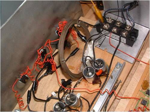

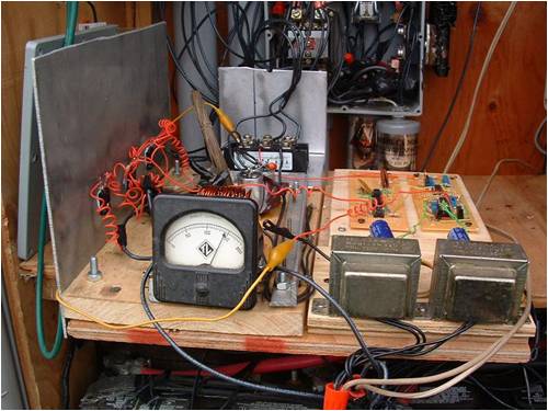

Here are the circuit photos you requested. The first one shows the complete bread board, as follows:
The +/- 12 volt power supply is shown in the front right; Mosfets and their heat sink plate (8"x12") are shown on the extreme left; bridge rectifier, back left, circuit boards, back right. The DC ammeter is reading about 14 amps.
The coil is shown here:
As stated in Figure 1, the coil is made from two parallel strands of 14 awg magnet wire, 10 turns wound into a 4" diameter coil potted in JB Weld.

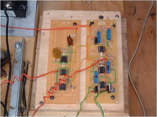

The circuit boards are shown here:
The next step is to package the components in an enclosure and mount it on the wall of the control shack.
Blessings and peace.

Peter,
Your suggestion for using a MOSFET driver like the TC4420 is most appreciated. I thought the MOSFETs were running warm for the current they were carring. You may have put your finger on the cause. Thank you.
With regard to being overcritically damped: This is what I know, so far:
The windmill rotor inertia sets the time constant for the system. It is on the order of seconds. The electronics have a much faster time constant on the order of miliseconds; the slowest one being set by the filter RC product downstream of the bridge rectifier. There is no sampling of power versus time (and its associated time constant) to determine slope for calculating the MMP. My observation is the electronics easily follow the rotor without causing an over or under damped condition and without significant hunting. I'd appreciate any more thoughts you might have on this.

Thank you. I love pictures of spaghetti!
I'm surprised at how much of the stuff you've used in your circuits I already have. This circuit is much more accessible to me (much more mechanically minded) than so many other things I've seen - the ones featuring big multi-legged chips that "do everything".
Breaking it down into "modules" was also a great idea. I would get swamped with it all in one diagram.
I've already got Gordon's cap multiplier circuit built on my desk and I think I know what my next winter project will be!

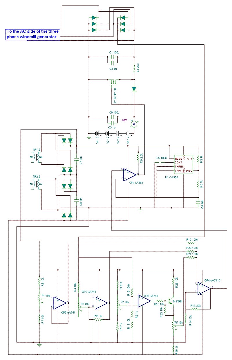

You asked for a schematic of the complete circuit. Here it is:
BobS
Posted: 01:53am 29 Nov 2009
Thanks Bob,
That makes it much easier to understand,
Pete.

Hi Bob,
My congratulations on the excellent presentation of your MPPTdevice.
As someone who has been tinkering with similar circuits for some time, there are a couple of things that I have found by bitter experience that might be of interest.
The low value caps in parallel with your 100 MF electros should not also be electros. Electros exhibit a relatively high internal impedance, and will not bypass the high frequency switching noise that your mosfets will generate, probably causing some local interference. This is more particularly so as your circuitry is not surrounded by metal. Ceramic capacitors are best for this, but anything other than an electro will be much better.
AS Dinges has indicated, the circuitry that you use to switch the gates of your mosfets looks as though it will be a bit too slow, probably causing the heating that you note. Mosfet gates are like capacitors, they require a low impedance in the switching circuit to charge or discharge them quickly to turn them on and off.
My partcular favourite for this is the 4050 hex non inverting buffer, with all of the elements paralleled. This both charges and discharges the gates very quickly. A word of caution though, it is possible to do this too quickly, destroying the mosfet. For this reason, you need a series resistor in series with each gate. Something of the order of 50 Ohms is a good starting point.
Keep up the good work!
Don B
marcwolf
Joined: 08/06/2009
Posts: 119
Posted: 05:21am 01 Dec 2009
Hi Bobshau
I have a couple of questions re choice of components.
Firstly you are using uA741 which are a dual supply Op-Am. Is there a reason that you are using this particular unit as there are several comparitable single supply units out there
Secondly with the uA741 you have 4 discrete components, where there are some OP-Amps like the LM324 which have 4 Amps on the chip.
I am starting to get into PCB design and would be interested in trying my hand at making a board for this.
Take Care
Dave
Coding Coding Coding..
Keep those keyboards coding..
RAW CODE!!!!!
