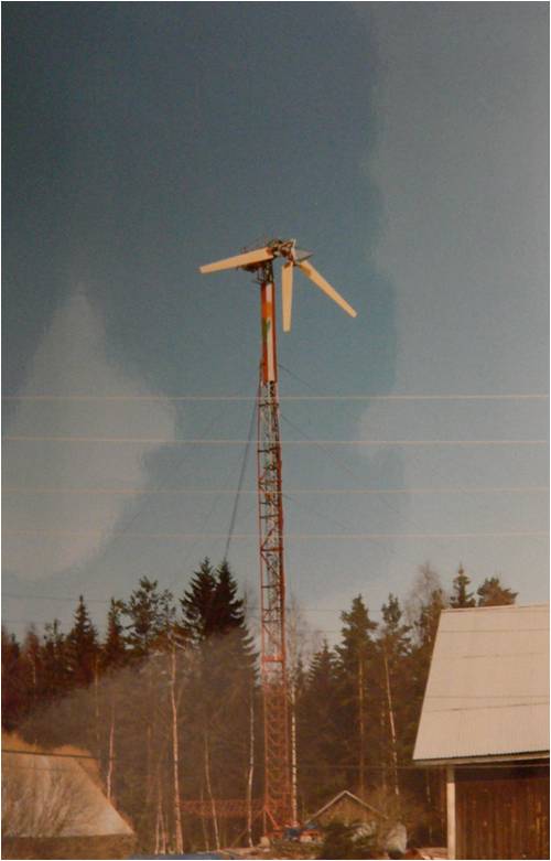

Though there is this old photo, in here the blade is hanging on with it's pitch control linkage. What propably had happened, is that the wet snow that rained that that night sticked on unevenly, and the resulting imbalance running first loosened some of the bolts holding it on, and then sheared the rest. But had it broken with more than a "just turning" speed it would have flown cleanly off for sure.
Sorry for the poor image quality.

Great picture Janne
If I was living around the base of that mill I would be very happy the blade to stayed at the hub, regardless of any damage to the rest of the blades
