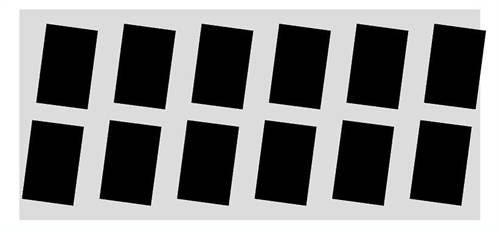

After a lot of procrastinating i have had a friend put my motor on his lathe and take 22mm off the rotor. This left the diamter at 84mm. I wrapped some paper around the rotor and the final measurements are:
267mm x 120mm. The picture is to scale.
The magnets i want to order are 46mm x 30mm x 10mm. I understand that since the stator has 36 slots i should use a 10 degree skew. It appears that i can only fit 12 magnets on the rotor.
Will the way i have set out the magnets create a cancelling effect ? or is there a formula i can use to lay them out ? (maybe another size magnet)
Any input appreciated.
Thanks.
Cameron.

Took me a while to work out what that picture was of, at first I thought the image resizing code was freaking out.
You didn't mention how many poles the motor has, 2 or 4, 6 or even 8. If your not sure you can work it out from the RPM. Is the RPM marked on the tag?

So this means i put magnets in every 60 degrees on the cylinder.
How wide can my magnet be ? Ans: no wider than 3 slots on the stator (36 slot stator)before you skew it 10 degrees.Edited by Smart Drives 2009-10-24

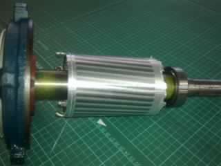

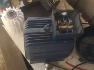

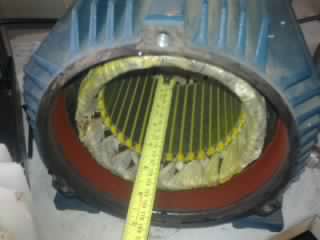

A few pics of the project

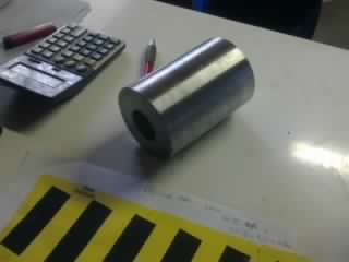

Magnets still haven't turned up, so here is a photo of the new rotor.
Thanks SparWeb it appears from what you said that i can slot the magnets in as far as i like with no loss of power.

[quote]Thanks SparWeb it appears from what you said that i can slot the magnets in as far as i like with no loss of power. [/quote]
No.. As you sink the magnets down into the rotor steel, you make it easier and easier for the magnet flux to "short" from the front pole top to the back pole.
If you make the air gap very very tiny, it will have much less effect, but with flat magnets in a circular stator, you will have a few more mm of gap in the center of the magnet face
If you sink the magnets in a few mm, it will have very little effect, but the further you sink them, then less flux will jump through the air gap, and instead jump straight to the steel rotor... and so back to the back of the magnet.
In the extreme case:
If you sink them right in, the flux from the edges of the front face of the magnet will go straight to the rotor, and it will be a dash through the door to see how many more can jump from the inner regions of the front face to the rotor until the flux is so thick there, that the rest have to jump to the stator and do the generating task you wanted them to do.
The harder you make it for them to short straight to the rear face from the front face, the more flux lines will be available to jump to the stator and so link the coils.
ie sinking them is a retrograde step if overdone. It's no where near so bad in the induction conversions as in the axial flux, as the axial expects the flux to jump a much much larger gap, so is far more inclined to take shortcuts and leak to the next magnet... or if sunk, then into the rotor steel... or both....but conversions suffer from much lower transition speeds, so needs all the help it can get.... it's never simple
Does that make any sense?
............oztulesEdited by oztules 2009-10-24

Unfortunately it does make sense....
so would 4mm be to much ?

I'm sorry Cam, it seems you've seriously misunderstood what I meant. I'm not sure if Oztules has cleared it up for you either.
You're asking about slotting the magnets into the rotor (the part which rotates). Your earlier question was about saturation in the stator (the part which is static). The two questions both go to the performance of the conversion, but they are separate subjects and we ara trying to tease them apart and talk about them separately.
I'm just lucky I guess, I received a thorough education about magnetic fields in college, but it's not common experience to most people. If you want to learn more about how the field lines of a magnet are attacted to ferrous metals, and how they can be diverted in different ways, it would give you a better "gut feel" for what the magnets do when mounted inside these generators.

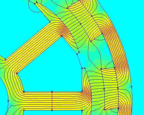

I can't find Dinges Femm of his conversion, so I will use this one from http://www.powercroco.de/magnetkreis.html.
Smartdrives, look at this. It is opposite to a conversion, as it is a motor... but the magnets and rotor steel are on the outside, and the teeth are on the inside, but the same rules apply.
In your case, this motor casing will be your rotor, and this armature teeth (2 of) will be your stator, and the magnets (2 of) will be your magnets.
Note the 2 flux lines linking the magnets to each other, this indicates leakage, and is worse when the magnets are too close together... or the gap is big.... the flux will take the easiest path home.
Note also, all the flux lines leaving the face of the magnet, return to the base of the magnet via a variety of paths... but they all must get there. No flux can go out without returning.... just like an electric circuit.
The small lines jumping from the sides of the magnets back to the casing, are the ones we are interested in with regards to sinking magnets. If you can imagine sinking them, it is easier and easier to return via this short path, rather than jumping the gap and taking the long route. Once again, a skinnier gap will help keep them interested in jumping the gap, a wider one will deter them, and they will cheat.... and jump directly to the case, or the magnet next door.... but they will go somewhere.... follow every flux line to get the idea.
4mm should not change things too radically, as the air gap should be very small at the edges of the magnets... but less depth would be marginally better I think...
Perhaps follow Dinges lead......if anyone knows what is going on inside these things... it is him and Sparweb.
