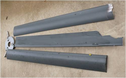

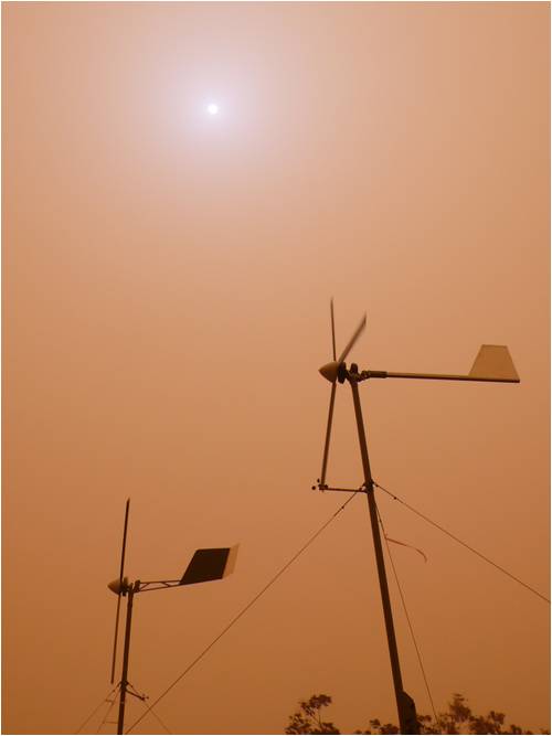

All happened a couple of weeks ago when the dust storm hit Brisbane , a freeky event with lots of wind and dust . In the middle you could look directly at the sun as it was just a big white dot in the sky and by the end of the day the Ax Fx had produced over 6000 Whrs and the F&P Dual over 4000 Whrs setting a new high for a day of over 10Kw , the Ax Fx also hit a new max output of 2.6Kw @ 500 Rpm
After that I had to fly out to work and a couple of days later another front went through when this happened

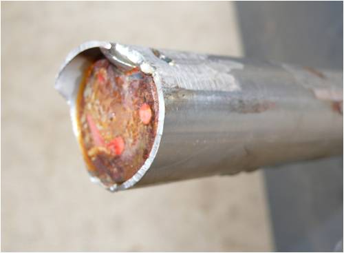

Below are some close ups of the failure , I have a pretty good idea of why it happened and what caused the first blade to fly of , the second blade came of due to the same failure but was accelerated because in the confusion the wrong shut down switch was thrown and the mill ran unloaded with two blades untill the second blade let go .
I'll leave it to some of the forum members to have their conclusions ..
I have heard of another set of blades having a similar failure , hopefully the pics for that will get posted as well...

Ouch Phil!!!....thats gotta hurt, especially after those record results you attained! So was it due to one of the blades hitting the pole which started the chain reaction, a clamp coming loose or rivets? I had been following the construction of your dual mill and have been modelling my mill along similar lines(progress slow but some pics included), but I think I may have to change my plans a little. Looks like your blade mounting plate held up.!!

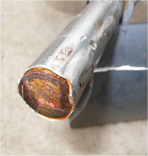

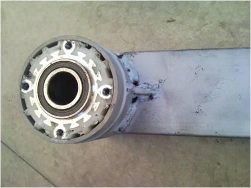

Marcus, the bearing hub to arm mount has to be able to take everything mother nature has to throw at it , and then some , the forces generated at the point where it welds to the arm are extreeme .

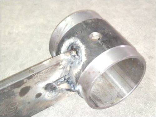

It appears you did not grind the galvanizing of the pipe before welding , not only does this give off poiseness gas , it makes it hard to get a good weld with good penetration.
I would suggest to clean some of those sl*g inclusions out and lay some more weld on to make sure it will not let go.
This is probably a little off topic for this , but keep up the good work...Edited by fillm 2009-10-12

sorry to see your misfortune again.Your mill is extracting large amounts of power from what I recall were pretty long blades.Looking at your posting for Ax Flux components it appears that the stubs have been machined down to a smaller diameter,where the clamps were placed.I think this is evident in the fractured shaft photo.There was discussion about Jimbo's mill shafts having a groove machined in them and how it might weaken them.Irrespective they may have ultimately failed without the reduction in diameter.Do you think the forces that caused the fracture were from blade flex front to back or side to side.Clues to this can come from the way the fracture formed and then finally broke.Although rust might make this difficult to see.

Good thinking, but no cigar
What you see is not a broken inner shaft, but the end of the inner shaft. So why did it break at the end of the inner shaft?

Thanks Glenn , Also this blade hub set is not the same as the new crimp clamp type , these s/s tubes are plug welded onto the stubs , also the first blade to fail was the one with no visible damage .

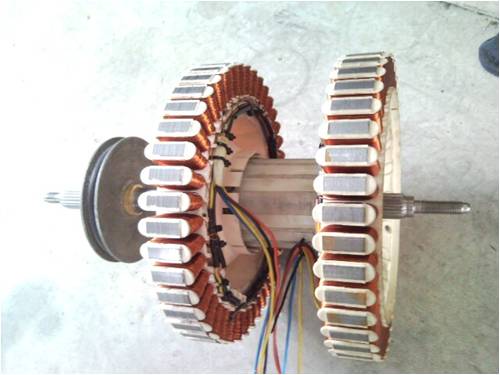

Also the components I put up for sale are not for a Ax Flux , they are for my F&P dual stator design which Marcus is copying .
If the solid shaft did fracture you would have an effect called 'beaching' raidaiting away from the origin then a crystaline final break ..

I doubt that caps could be to blame, as they are not used for power factor correction. In Phill's arrangement they provide voltage gain, to extract energy when the normal alternator emf would not be sufficient with the turns, and rpm combo provided too low voltage to effect battery cutin.
The mechanical strength of the components was likely just insufficient for the dynamic stresses seen during furling.

Niall , all the rivets are still intact on the first blade to fail and on #2 , although the one blade left on and the most damaged did hit the tower . No it did not hit the tower first and cause the the other two to fly off as my 13yo son was watching it through the kitchen window when the blade let go and went flying..
Herb , Caps had absolutly nothing to do with the failure
Oz , You almost have hit the nail on the head , fatigue and point loading did the damage but there is another quite obvious thing that contributed , anyway I"ll leave it for a bit longer as it is good to see how everyone perceives how this failure happened ..
I think Glenn has put up a "Havana Cigar" to the person who gets it ..

has the moisture that caused the inner shaft to rust caused some electrolysis that has eaten through the wall of the Stainless steel tube.Or was it struck by lighting.
Or don't drill and weld at the intersecting point of insert and tube.
Anthony.Edited by Jarbar 2009-10-13
Posted: 05:50am 12 Oct 2009
Dave's on the right track......
Hint. Whats different between Phill's build and the recommended mounting drawing on the PVC blade page.
http://www.thebackshed.com/windmill/PVCBladeOrders.asp

Jaybar, You are spot on , somehow out of an act of stupidity or bad measurement I drilled and welded right at the end on the load bearing point , when s/s is shocked with that heat during welding it becomes brittle , it can be annealed back but I didn't. You can see the weld has run through onto the end of the spigot as well and you can notice the break arround that weld area .
The fact that there is no radius at the end of the spigots may have also added to the load being consentrated , but it didn't break cleanly at the edge..
With the amount of force being generated from every direction from yawing/furling a 3.25m gyroscope , wind pressure , decelleration in wind shifts and every other force trying to break the blades off at that point and I put two welds there , BIG MISTAKE ..
I must also add that in hind site having the spigots double/tripple the length would be the wise thing to do as well as these are at a 10:1 leverage ratio , obviously the next set are under construction and will be capable of handeling the extreames mother nature has to give....

Hmmm. I partly disagree.
Your welding stunt didn't help a bad situation. If you think about it, when you are using these on the axial, and pulling 2kw and more, you are pulling serious torque. If you look at a comparable 3kw petrol generator, and drive it to 2kw, it will get a bit shaky, and it is operating at 4 times the rpm we are here.... so we have 4 times the torque that starts to load up significantly the 8hp combustion engine... this is not insignificant torque.
Add to that the pulse vibration/hammering that is being generated by the magnets hitting the coils (feel the vibration down the tower to get and idea). This is the killer added to the torque.
Now we use thin walled pipe, with a 10:1 leverage, and with all/most of the torque generated out near the tips, this has to fail from work hardened fatigue.
Remember, there is no "give" anywhere but that intersection. Any bending moment will happen there, and any flexing has to happen there........
Add to this already stressed design some wicked yawing and bucking in a storm and it will probably give up with or without the welding incident. I suspect it quickened the demise by giving it a focal point, but it would surely have given up eventually anyway.... same place, and same look.
The F@P has a much higher hammer frequency and massively less torque.... 1/2 the power at 1.5 times the speed. The chances of failure are probably only 10% of the axial of similar blade length.
So I figure, make the solid go at least a third and possibly half the length of the pipe, and /or much much thicker pipe if you stick to the 10:1 business.
.... oh, and don't tempt fate by welding near the stub end. If the stub went 1/2 the length of the rod, you could probably weld to your hearts content, and it would still survive.

I'll update the PVC blade page with a few pointers about not welding the plug holes too close to the end of the inner shaft, and adding a radius to the end of the inner shaft. I think that and keeping the inner shaft extended into the blade by 25% should work.
Another problem I've noticed, if the 25mm outer steel tube is not at least 80% to 90% of the blade length, the PVC blade will start to bend backwards after the end of the tube, permanently! Any more than 200mm of PVC must be supported by a steel tube, the PVC has no real strength of its own.
Its surprising how much force is acting on turbine blades at the mounting end, and breakages like this show you can never be to carefull. So long as the blades are built to the guidlines I dont think we will see any failures, but you never know. Yes the extra steel does add weight, but I would rather have a heavy blade than no blade.
