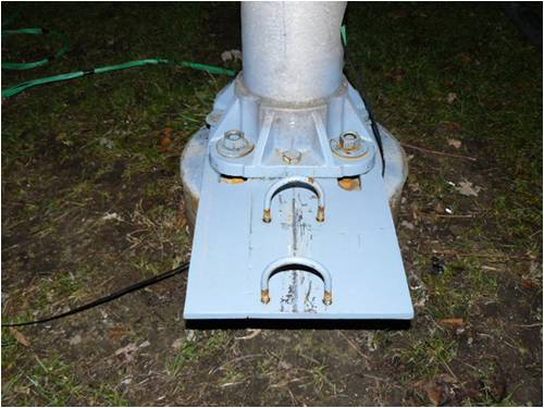

Marcus

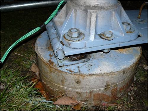

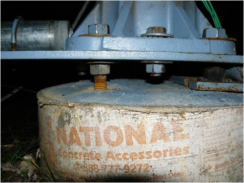

Here are some photos of the base plate I made. I made this plate because I only use three guys and it will only allow the mast to till North South. (in my case) It did take some doing. You have to be sure the plate is solid. It has to be bolted and or welded in such a way so it will not get lose from the foundation or the tower will fall. (East West) With no side support wires the gine pole has to be very strong and ridge or it will bend and that would not be good.
My mast is 14.2m

I still think that a four wire system is the route to go, safer and easier to work with. I just don't have the space to use four support wires.
The base mount is much easier to fabricate and you can place your mill at almost any height.
