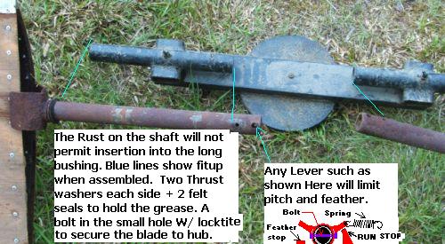

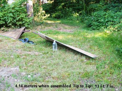

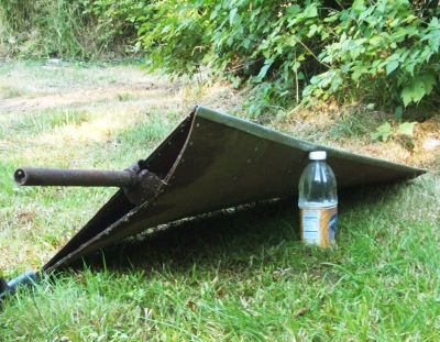

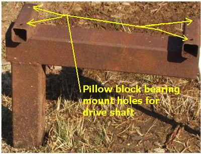

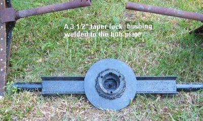

Posted: 03:01pm 28 Jul 2009
Pukwudji
Below is the Pic's. of a long abandoned project I had built it to allow the pitch to feather in high wind but never got to test any part of it. A fluid shock absorber should be added to this to dampen the effect of gusting wind and flutter. This mill was built to drive an auto air conditioner compressor in the winter to heat water as
a supplement to home heating, I figgered the Heat equalivent of 3 watts to 1 watt electrical would make the mill much more efficient than it would ever be as a generator.
