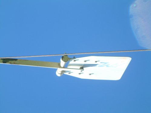

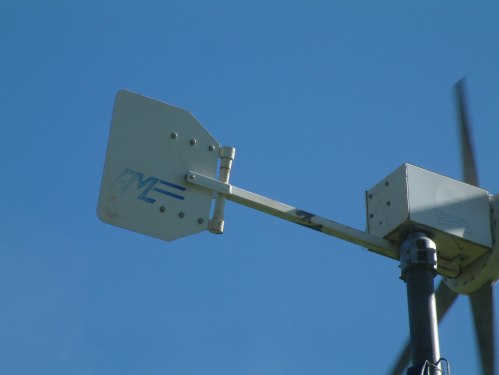

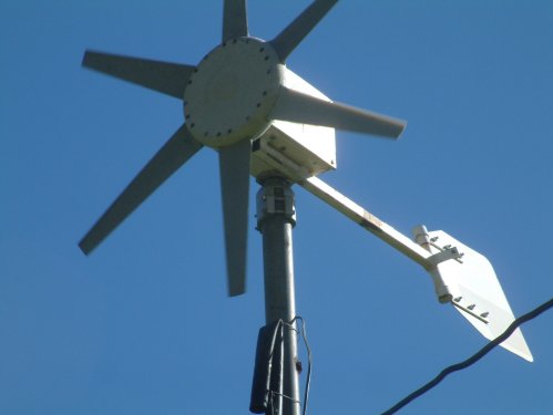

Posted: 03:18am 19 Jul 2009
Showing the offset yaw axis, hinged tail and tail stop arm fitted with rubber bump stop.
The tail rests on another rubber bump stop on the small tail positioning arm.
Looking up from the ground. The non vertical hinged tail uses no springs just gravity.

nice Explanatory furling pics .. ...so much for my memory then ...Edited by niall1 2009-07-22
