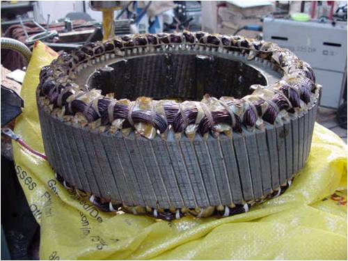

Because the stator stack is so small (easy to play with), it would probably be in the best interests of the project to strip the stator, pull the plates apart, and skew them.
Then you can rewind it to whatever specifications are practically possible as well....(and single phase if you must... but preferably rewind to 3ph so you don't need the caps and series arrangement) best of all worlds.
Here is an example of a skewed stator:
