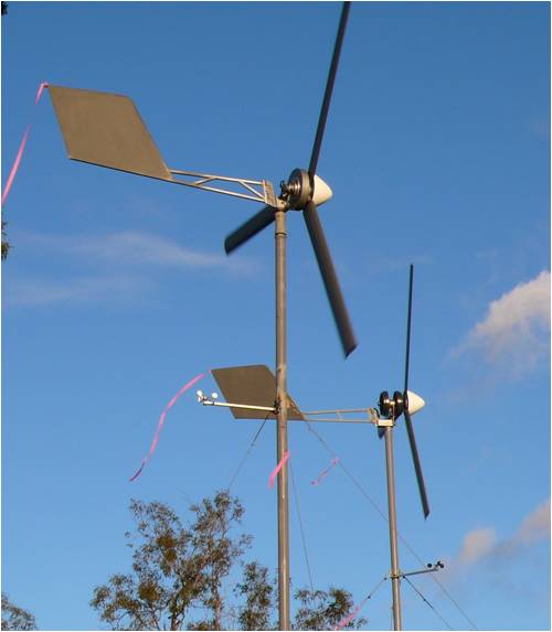

Hi All
I now have the two mills up and flying as you can see in the pic above , I was origionally going to title this thread as " The Ax Fx - Vs - F&P Dual " but decided to not pit one against the other as they are two entirely different machines with completly different costs and engineering involved in construction..

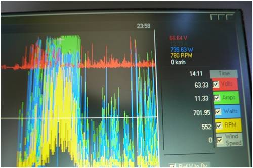

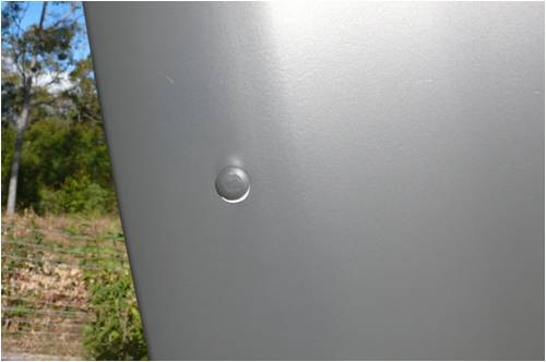

Where it all gets pear shaped with the F&P if you dont have your furling set up properly is after 500Rpm where the core becomes saturated and the torque curve is droping and there is basicly very little additional power that can be produced with out getting into a dangerous situation as in an out of controll wind mill as happened here as you can see 750Rpm @ 735W in 50+Klm . The F&P can not be stoped by shorting the coils in this wind only a mechanical brake would stop it or worse still, total destruction.. All in all a pretty good test for the PVC blades with concerns from some that they can't get up to high speed .. I have now increased the offset and it is furling in 35Klm as I don't want this happening again as shown in a pic of what was starting to happen to the rivit holes holding the blades to the tubes..

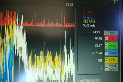

The max read outs for the Ax Fx speak for themselves 2500W @ 480Rpm in the same 50+Klm , the point where it was all getting out of controll with the grid inverter maxed the dump load maxed and batt voltage still rising , the switch was thrown and it stopped .

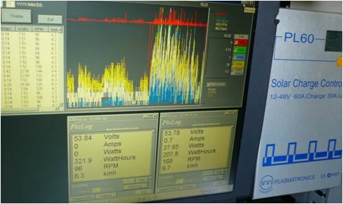

Dual piclog , reading both mills at the same time .

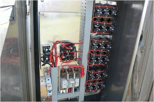

Elec box for the Ax Fx
A good reason to have your furling set right , approx 1mm of movement . Overspeed will take its toll on any blade and mounting system !

My main concern next is to re-design the tail , longer and to double the surface area and keep the weight the same . I am loosing so much power from the blades not being square to the low to medium wind , this could be one of the draw backs with such a wide cord at the tip as it exerts a lot more thrust through the offset in these conditions . I would guess at a 20 to 30% loss and it's really bugging me hence the streamers all over the place in the photos....Phill

Hey Phill, just checking, how many and what size rivets did you use per blade. I want to set a "minium recommended" rivet size and count to keep the PVC blades on the tube. Its obviously held up in your situation, so I think 1 or 2 more rivets per blade will be a good base line.

Glenn , the rivets are 3/16 and there are 3 front and back , also they are offset 20mm from each side . The movement was definatly with the force over 700Rpm as they had hit arround 650 on another occasion with no movement .
1 or 2 more would have to be good for 1000+, but I would not like to standing to close wathcing that
