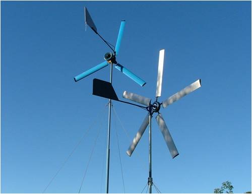

Glenn, have two mills up with new PVC Ex blades and very
happy with them. Both x3 blades with dual stators @ 2400
dia. Have set blades both @8 degree angle and seem to do
well there.
Nice thing with these blades is that they are so easy to
balance and put together. A real no-brainer.
And the really nice thing is these blades are quiet. I
like it!
Have no monitoring gear but ammeter is hitting 45-50amps
in good winds, that's both mills together. Am happy and
just need to get myself a decent inverter.

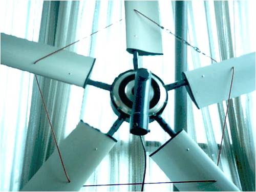

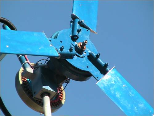

Have two mills up with extruded blades and no problems with movement on SS tubing or the 400mm root 25mm shaft.
One has joined blades and has 5mm x 10mm x5 rivets with x3 tapped screws into the 25mm x 400mm root section.
Other mill is as photo shows with full length blades and only three rivets. All OK so far and have had some reasonably strong winds to test them. But will certainly keep a close eye on it. Think next time have mill down with three rivets will add two more.
On my second mill instead of making the blade shaft adjustable I tapped a screw at approximate 8' and slightly elongated the whole in blade to make small adjustments to blade angle. These three screws have small washers to add more grip to blade.
Peter
....River Heads - Australia
The wind blows wherever it wishes; you hear the sound it makes, but you do not know where it comes from or where it is going.
