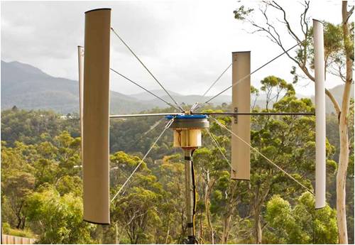

Hi Rubes
I had a look at your mill in the Photo and I think I know what the problem is for it not starting, The ones I made required a starter SV rotor to get them moving as while they are stationary they just waffle around in the wind not starting.
I used a SV rotor on the top as that got them going, with later ones I made the SV rotor vane spring loaded so as it spun up they spun out into a cylinder shape to minimize high speed drag.
I have made a few large ones years ago and found them very reliable and low maintainence, but lower overall power for frontal area than a HAWT, I will make another one as soon as I get some other projects out of the way, as I feel they have their place in the scheme of things.
The ones I made where 3m dia and 6m high.
They worked from 5 mph up.

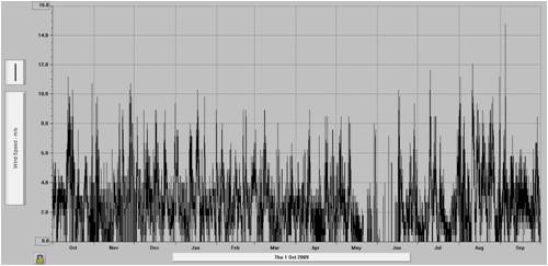

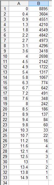

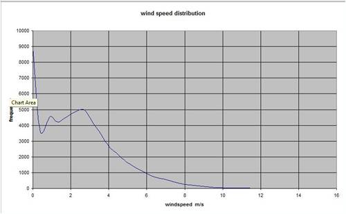

Posted: 12:40am 20 Oct 2010
Hi Al,
To help you with your decision, I have just run some numbers for windspeed data logged at my site for the last year. This would be a guide to what you need to record and process. I have a Davis weather station and I record with weatherlink 5.1. The station provides 10 minute average windspeeds and records these. I have prepared some data and graphs.
graph 1 is the yearly logged 10min ave windspeed graph in m/s.
I have then manually extracted all occurrences of each logged windspeed and recorded the occurrrence for each.
graph 2 is the plot of the windspeed distribution.
On the matter of the occurrunce of high winds.
in the last year, my location which I would classify as OK only for wind, recorded only 1, 10min period in 55000 recorded [0.0018%] during the year of wind with an average of 15m/s, and only about 100, 10min periods in 55000 where the windspeed averaged over 10m/s. look at the tail on the graph above.
Once you have the windspeed distribution, you can design the windmill for it. There is not much point in designing for the big numbers if they don't occur very often.
At my location, wind gusts are approx twice the speed of the 10min ave speed, these would need to be considered in a design.
Gordon.
