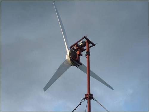

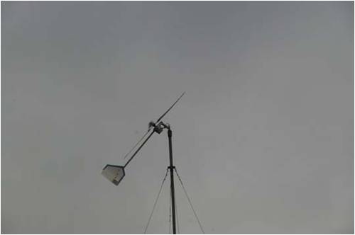

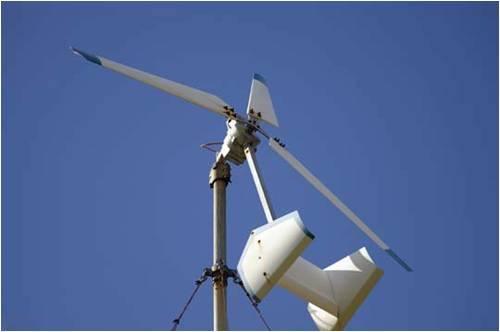

this seemed to be hidden in the dark creepy vaults of fieldlines
at least for me anyway ....
by micks
..........ergo the angle grinders being warmed up for the old mill...
its downwind....
its got a minimal tail...
and it furls......
cant help wondering if a car shock absorber could be used
to dampen the return movement ?
edit...seems like when it is trimmed out using the counterbalance pole this isnt a big issue

I have seen this as well and it looks to be a good solution.
Only minor tings is that your windmill looks like i is running in reverse :>
Also be very easy to change just by enlarging or reducing the furling sail. This could easily be done re some PVC plates with expansion slides.

its pretty interesting ...the furling action seems to be in one plane ..unlike the normal ..tail sideways and up.. at the same time ..
kudos to that man ...

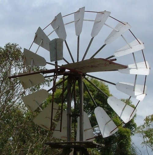

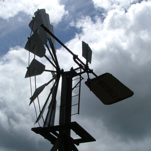

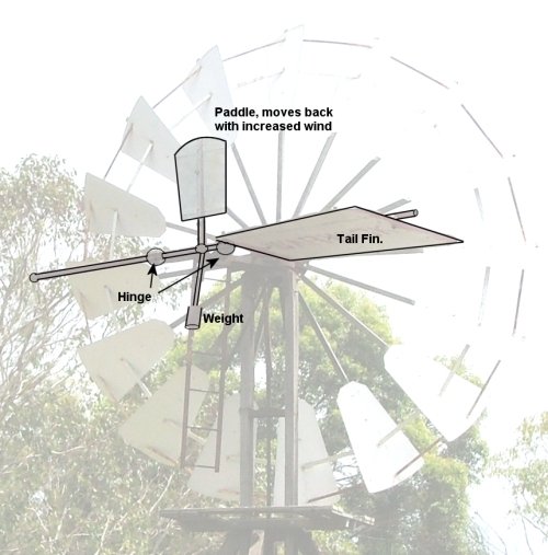

I have a pic at home of a furling system for downwind turbines, I'll uplad it tonight.
Posted: 08:37am 12 Jun 2009
This is the furling system I saw on a old water pumping windmill. Hopefully the pictures explain how it works.
The turbine blades are angled back to give better wind following. A horizontal shaft is held out in front of the windmill by a couple of hinges( bearings ). At one end of the shaft is a tail fin. Mounted off the middle of the shaft is a paddle and weight. The other end of the shaft is there as a counter weight to the tail, to keep it all in balance for longer hinge life.
In normal operation, the weight ( opposite the paddle ), is held down by gravity. This in turn keeps the paddle vertical, facing the wind, and the tail fin horizontal. As the tail is horizontal, it catches no wind.
As the wind increases, the paddle is pushed back, acting against the weight. This turns the tail fin up from the horizontal, catching wind, and turning the windmill out of the wind. As the windmill turns out of the wind, a new balance is found as the wind pressure decreases against the paddle.
Is a simple system once you get a grip of how it works. The weight is adjustable, making it easy to change the furling characteristic of the windmill.

Posted: 07:40am 13 Jun 2009
Well, I didn't see that one coming
Simple solution... not one I would have dreamed up, but looks pretty useful anyway.
There's just so many ways of doing the same thing .. it's amazing.

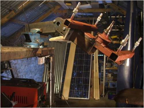

i,ve taken down my mill ,dissambled and weighed it for the first time
axial alt, blades , mount and hub come in about 50 kg .....so its off to the scrapyard next to find a butch pivot of some kind to hang it on and try to get a feel of what,l need to happen next .......... lots to think about ... Edited by niall1 2009-06-16

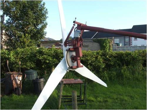

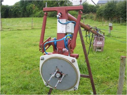

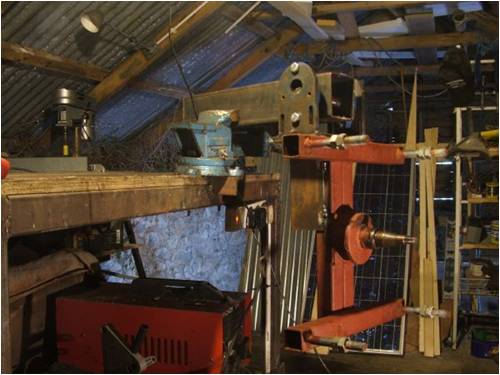

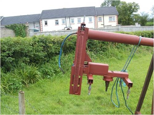

after getting the grinder out and some head scratching i,ve decided to try to copy this type of downwind furling idea
http://www.fieldlines.com/story/2004/1/10/164855/803
, the mill becomes a kind of pendulum and should try to furl vertically , no tail then..... but lots of unknowns...

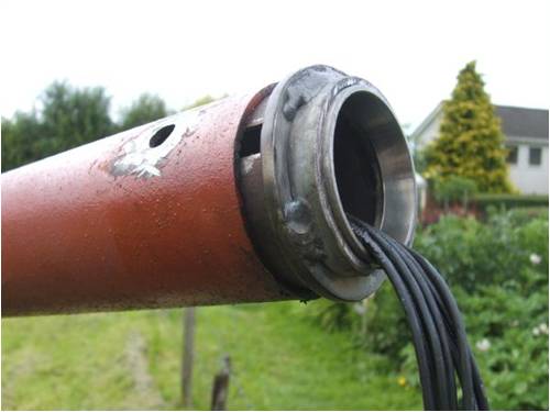

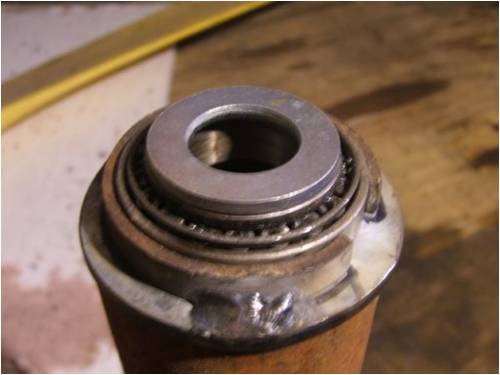

the pivot is make up of two pillow bearings and a one inch shaft ..all a bit butch then but works smoothly with no play
i doubt the tower will take too kindly to it... .., it doesent weigh much more than the origional upwind but it will be kind of .....hanging its bits out there ...
i,ll try to put a thrust bearing at the top of the yaw pipe , just to see if it suits a downwind machine better ( i know that can cause issues with upwind ) dunno how this will work as it,ll be hard to keep the grease in and the crud out but should be worth a try
you know when you,ve got to much time on your hands when you start ............ Edited by niall1 2009-07-04

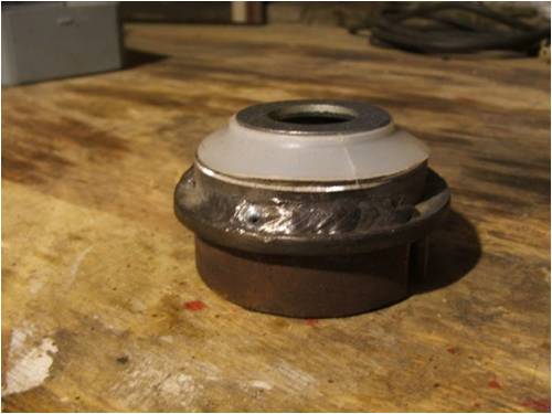

Niall, that's an interesting way you have to make a sleave for the bearing to ride in. I'll have to remember that. You might find a cup or shallow bowl to cover it if you are concerned with crud infiltrating the bearing.
This is an interesting project. I think it will work out well. Keep up the good work.

Posted: 06:50pm 03 Jul 2009
Hi philb
mmmm .... now after thinking about a cup seal i figure theres one or two ways to fit a homemade one ...... alot will depend on how much clearance there is and how central the bearing is ...should be fun

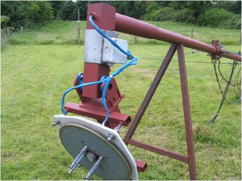

Posted: 08:24pm 10 Jul 2009
first test fit on the mast ...strange fish indeed...
the alt (at least this one) seems to take a fair amount of force to rotate it on the pivot...the pivot is smooth enough , but the alt is heavy ..hopefully it,ll get a run next week ... i,m probabely underestimating what a high wind can shift anyway ... ..worryingly i,m beginning to day dream about pre-loading the furl with an adjustable spring ... ..i tried to read up on static balancing but the head began to hurt and in the end i gave up
ps ...Philb,s dust cap ..a light hacksaw cut around the washer and the milk bottle top clicked in

looks like you are only a few steps away from having the unit in the air! I'm looking forward to seeing it fly. It has great potential.
If you are concerned about the late furling, could you add more weight to the arm on top of the unit?
A pulsation dampner came to mind instead of a attaching a spring to the pivot. This might keep the unit from slamming the tower in gusty winds, while allowing it to furl easily. On second thought, it might take a big gust to do this since your generator is away from the tower.
I like the way your yaw bearing fits into the mast also. That makes it easy to service or replace. In my area, I would have had to make the dust cover extend down a bit (2 cm) more because of blowing dust and rain making a grit grinding compound.

I agree with Philb, a damper would probably need to be included. Not to prevent it from slamming into the stops, but to prevent it from oscillating: what you have now is a mass-spring system that, once excited, will oscillate back and forth around its equilibrium state. The oscillations will slowly dampen (due to natural damping, because of friction). The process of damping could (should?) be accelerated by means of a damper, in essence turning it into mass-spring-damper system. Ideally, you'd have to tune the damper to be critically damped (not over- or undercritically): http://en.wikipedia.org/wiki/Damped_spring-mass_system and http://en.wikipedia.org/wiki/Harmonic_oscillator
But time will tell whether you'll really need this damper or can rely on natural damping.

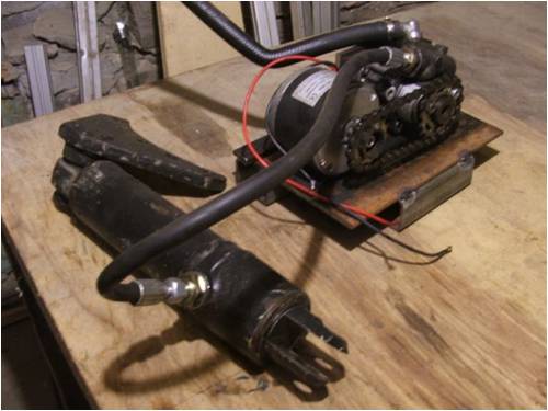

this next bit was going to go in other stuff but it might have some relevance here ...in a less lucid moment i thought about adding an active hydraulic ram to furl the mill
its an ordinary power steering pump and single acting ram out of the scrapyard , the pump is hooked up to a 36v scotter motor (lately these pumps are appearing with their own 12v motor built in )
i set it up with a lever and pivot and sat on the other end thinking this this would keep it retracted ..even with a little old 12v strimmer battery it had other ideas and proceeded to gently lift my 80kg,s towards the shed roof...
all power hydraulics come with a health warning so i left it to one side

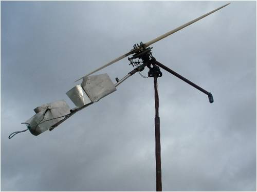

Posted: 10:14pm 28 Jul 2009
progress on the contraption .....has been a bit slow ...stuff is almost fitting backways ...... .....but, usually dosent...
the springs i,m not sure about but.... as with the suggestions theres only one way to find out...and then think again
the springs have no leverage in the normal position...once (if it can ) the alt does try to furl they might sort of come into play ..(the cattle trailer approach to influencing
furling then).....
plenty of warts are waiting in the long grass ...
updated a bit ....finally up ..but not much wind...

Posted: 10:45pm 28 Jul 2009
Hi niall,
you mention a fair amouint of torque to rotate the machine around the top of the pole, even with a tapered roller. You could consider adding a counterweight to the upwind side of the assembly. This will reduce the twisting moment on the tapered roller bearing. The weight will be inversely proportional to the distance it is placed from the vertical pivot axix.
Good luck.

Posted: 09:20pm 29 Jul 2009
hi Gordon
your right about the yaw bearing ...its smoother than pipe but not a true thrust bearing set up ..this looks like it could be a bit of an issue (its hard to tell yet but i suspect probabely a big one ) with this setup tracking light winds......
now its up.... the mast at least seems happy enough with it ...(the upper stays were able to go a good bit higher)..so any counterweight is fair game Edited by niall1 2009-07-31
