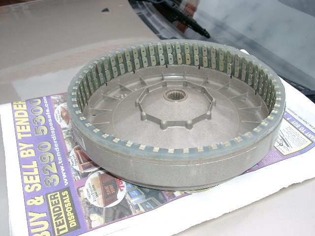

Matt Lyons visited my place some time back and we stripped a Ceramic rotor and retrofitted some Neo's he bought up with him.
He angled them slightly and after they were lined up _they magnetically stick to the steel backing in the rotor,so that's a help- we then mixed polyester resin and poured it into the small spaces between the magnets by making a "dam" with Gaffa tape around the inside of the rotor.
They seem to be very powerful on my stators-almost a 2 man job to pull the bloody thing off the stator, but I'm a bit concerned with the cogging ,still too much,I reckon.
