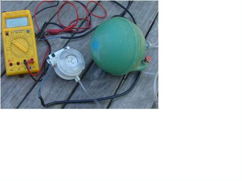

Posted: 12:19am 17 Jun 2009
I did some test runs today with the differential pressure switch connected to an old float ( sphere, thank's to Glenn ) ) diameter 150mm with a hole on top 3.0mm.
I was holding it out from a driving car, so test results are not to accurate , not important because its ajustable anyway. I just wanted to know what range I get out of it:
This pressure switch has a range of 20 to 300Pa.
at 20Pa it was switching @ 25km/h = 7m/s
at 100Pa @ 40km/h = 11m/s
at 150Pa @ 60km/h = 16m/s
at 300PA - didn't bother to test, anyway beyond the range required.
Harald
I have to new switch over, they are nearly 100 Euros new, A$60 incl. shipping each.
BTW: works upside down as well
