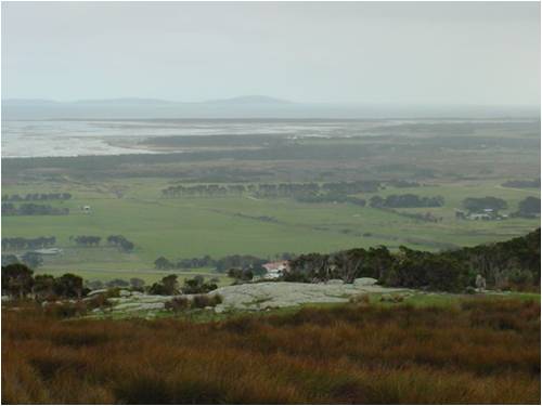

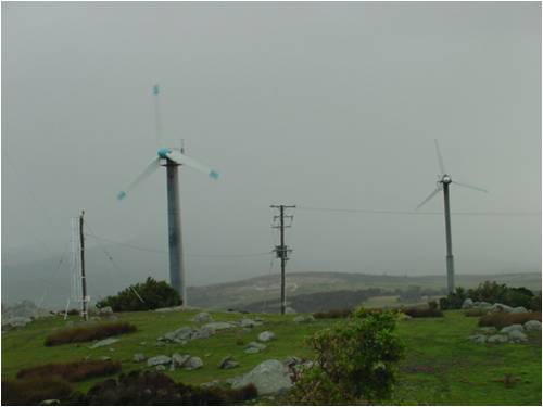

First from up the top of the hill:
The site is about 800 feet up above the surrounding countryside, and the prevailing westerlies. No real attempt has been made to get them very high up, as they don't need any more elevation..... as seen here:

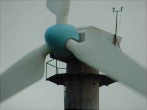

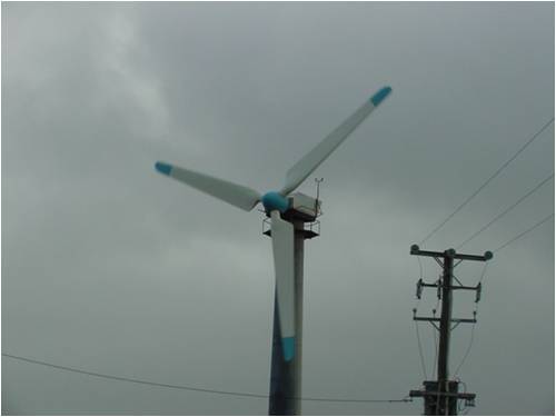

Here is a telephoto of the bigger one.. it is around 55 feet diameter... I'm not sure as the owner is not sure either... and he built it.... and I ain't gonna measure it either.:
Another shot of it. The blue tips are the tip flaps that go at right angles in an over speed condition.... very useful adjunct. The walking platform can be clearly seen.

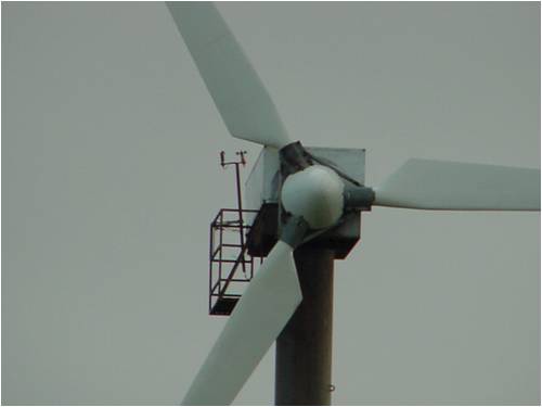

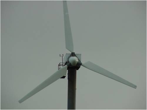

Here is the little one. it is only 30 odd feet diam. I was fixing this one today. It was in the auto return cable twist electronics. ... fixed. Even in mild winds in which it wouldn't start, if you kick start it with the main contactor, it putted along at 2-8 KW... not bad... thats in about 4-6m/sec messy wind... not coming from the west, but along the ridge top and
into it.... not good, or usual wind.

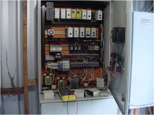

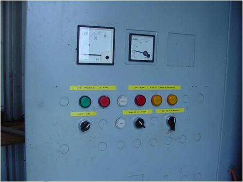

Here is the control system for one of these things. It is like auto electrical work... you know it's simple, you just can't find where all the wires go because someone used all the same colors..
Looks better when it's closed though (means it's fixed)

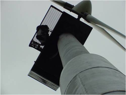

There's the owner installing the direction sensor I have just rebuilt.

Posted: 10:21pm 30 May 2009
David,
The sky is the limit as to how you wire these things. They essentially all need to have the same basic attributes, but an almost limitless list of possible adjuncts can be added.
You need to know the windspeed, direction, power condition (freq, voltage and are all three phases present), shaft RPM... and your good to go. You then need the systems to pull on the brake (under a variety of shut down errors), rotate the yaw, control the twist condition.
All of those electromatic modules you see in the picture control a single aspect of it's operation independently. They all have adjustable time constants where applicable and set their internal relays accordingly.
Simply series the outputs you need for a particular condition and it's done.
In truth, a simple plc controller could do most of it ... but this was done before they were hip.
I probably would not do it this way, but having said that, this thing runs 24/7 for the last 25 years or so...pretty hard to argue with that technology I guess.
They are not what I would call big machines, but they mimic the systems of the big ones pretty well as I understand it (different electronics obviously)
............oztules
