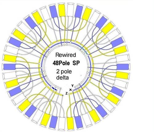

There is a drawing for SP delta only wiring.
cheers
Harald
PS: no garanties that this is correct, I am not yet perfect.

Hi
I mixed up the numbers.
It schould read 42 poles.
I am surprised nobody noticed or didn't bother.
cheers
Harald

Hi Harald,
Nice work, have you had time to run it yet?
This along with Glenn's staggered winding will be an interesting read .
I thought about the 48 "thing" ,but just let it go as I just know you are too smart to make a mistake.
Bruce
