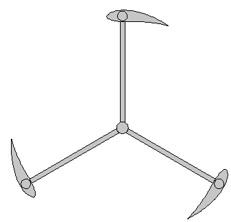

I have one 3m length of the sample PVC blade left, and I'm thinking of cutting it into 3 and making a 1m high H rotor.
I plan to use 1 inch timber dowel up the middle of the extrusion instead of the steel tube cause I dont need to hold the blade from one end, I can screw it together with timber screws, and its lighter.

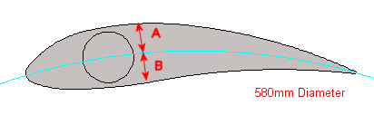

A Darrieus works best with a profile that is symetrical on the inside and outside of the swept path/diameter. The extruded blades have a curve, so I worked out the ideal diameter that would pass through the center of the blade profile. This path is shown in blue, and you can see how A = B along the length of the blades chord. This gave a diameter of 580mm.

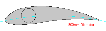

If I go bigger in diameter, I gain power. I do loose RPM, but will ignore that for this exercise. I wonder how much I can increase the diameter before I upset the air flow and get a decrease in power. Below is at 800mm.

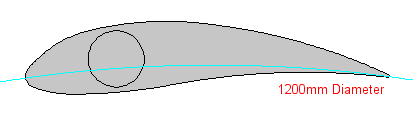

Still looks ok. At 1200, below, I think I may be pushing my luck. I'm also loosing solidity by increasing the diameter.
Any comments? I've never played with a Darrieus before so this should be a fun project. I'm aware I need to spin it up before it will start to power itself, I'll use a pull cord to test at first, and later try a smaller Savonius made from PVC pipe. I have a servo motor as the load, this is too small to drive a F&P.

What is the blade chord you have?Those blades should easily selfstart with the right solidity.You may want to keep it pretty narrow with so few blades.I think .3 is a good solidity for the giro.
Thats just me though.
Have fun and nice to see
Posted: 11:17pm 16 Apr 2009
Hey vawtman
The chord is 160mm. If I use a 600mm diameter with 3 blades, to work out the solidity, total blade chord of 480mm ( 160 X 3 ), divided by the circumference ( Pi X 600 ), gives approx 0.25
Is that right?

Yep and should selfstart and run great at that.

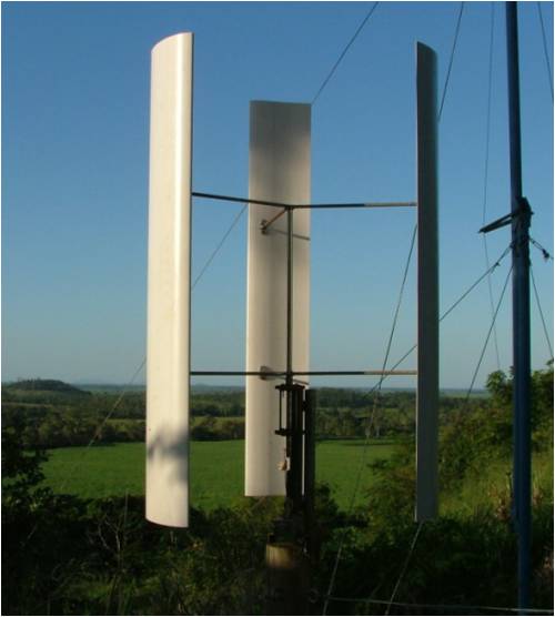

I finished it off today.
No load yet, and no wind either
Will post another update when I see some wind.

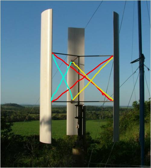

Just a thought Gizmo. How much flex is there when you push on a blade by hand? The rods appear to be thin.
Gordon.
oztules
Joined: 26/07/2007
Posts: 1686
Posted: 11:34am 19 Apr 2009
Just too too cool ..... you will start a whole new VAWT thing I'm sure.
......oztules
Posted: 11:46am 19 Apr 2009
  GWatPE said   Just a thought Gizmo. How much flex is there when you push on a blade by hand? The rods appear to be thin.
Gordon.
Hey Gordon.
I was thinking the same, buts its actually a lot stronger that I though it would be. The center shaft is 12mm and the rods are 8mm steel. Its only 1000mm high by 600mm wide, so not a lot of wind frontage. It runs on a couple of bearings.
