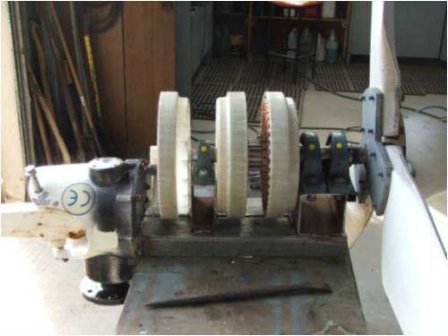

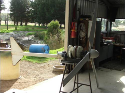

some photos of progress so far.

Posted: 07:28am 16 Apr 2009
Hi Pluggy,
the mill looks like a chop/shop job on a chinese type mill. How far ahead of the tower pivot is the blade rotor? Looks quite a way, and this will change the furling.
Gordon.
Hi all
The mill is an Modified chinese that dident work properly (49v in a cyclone).So chopped it up for this project. As you say the furling has probly changed as hub is approx 200mm further forward.I suppose there is no way to test this on the ground.Trial and error when flying?
I am making the tail larger as the original is to small ,so this will also have some effect? The question is How big does the tail need to be?. Still lots of things to work out.Main thing still to work out is the wiring of the stators.
in the pic the end spare rotor is a stripped out hub which i plan to make into a manual brake.
Rgds CarlEdited by PLUGGY 2009-04-18

The original chinese mill (Ebay) was supposed to be for a 48v system 1000w@48v had a crap controler with it which I modified to get it to work.Gen was quite solid and well made but had it going for a while and the highest i ever saw out of it (very briefly) Im a howling gale was 49v AC before the controler no load.we tried to rewire it star & delta also rewind stator but gave up.to hard .This was about 2yr ago.
If i new what I know now we would done more.
BUT you see the shaft in the pics,that is the original rotor shaft so as you can see there is no turning back Unfortunately.
The original mill rotor was a brushless 6 neo magnet rotor .Has 3 slip rings on the yaw pivot.
Regds CarlEdited by PLUGGY 2009-04-18

The low output could be from overheating. The units usually produce the rated voltage. 49VAC gives over 68V peak DCV. Would probably have been a good candidate
for a voltage doubler. No way back now.
The long distance of the blades from the original length will still need to be adressed in the furling. Will probably furl too early if mill head geometry is not changed.
