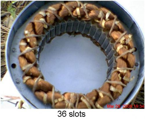

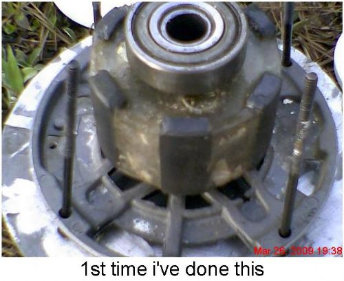

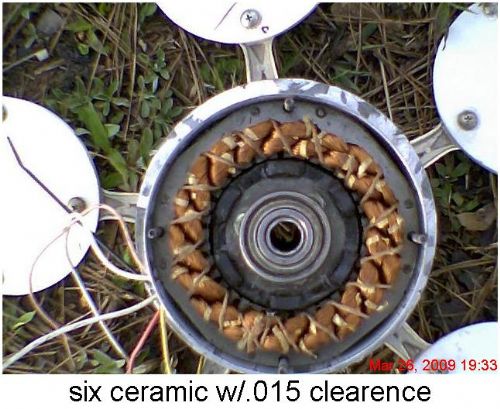

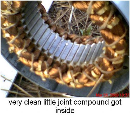

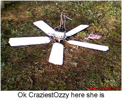

Ok time to put the kids to bed ozzy, and send the wife out of the room. the show starts now!!!!
any sujestions you have on rewiring this baby. Please let me know. I don't want to destroy it. but if it works great. ifnot I have other motors in preop. waiting to go into surgary.

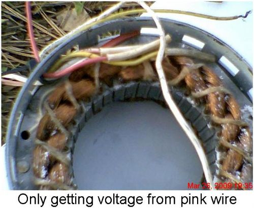

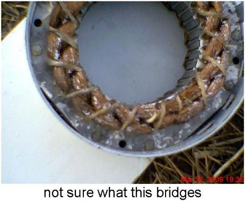

Posted: 03:16pm 30 Mar 2009
ok I found a dead short in the wiring. time to cut and rewind the stator. removed the wires. I'm going to try a test winding this weekend. i'll post some photos. the rain finely stoped. we go 5 inchs in 7 hours. every river is now over flood stage in tthe area.
