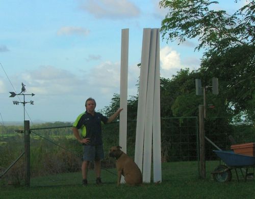

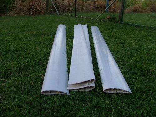

Hi guys.
Well they have arived, my sample PVC blades. Cant wait for the weekend
These will soon be available for purchase at a very good price compared to other options. They should be cheaper than those extruded fibreglass blades, and if your timber challenged like me, a lot easier to put together.
Each lengh is 3 meters and weighs 4kg. Chord is 160mm
Exciting stuff.

Looks promising Glenn , has a price been set yet ? ...Will be interesting to see the hub arrangement you design and their performance , do you require your piclog back ?

No price set yet, but the idea is they will be too cheap to not consider, even for the hard core timber blade fans.
I forgot about the Piclog. Only if your finished with it, I can put another one together if I need to.

Wow those pvc blades look scary be interesting to see how they will perform.

Those look really nice. I almost want a set for myself! (No I'm too far away in Canada)

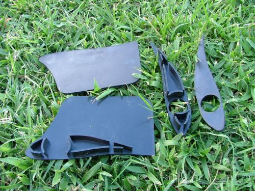

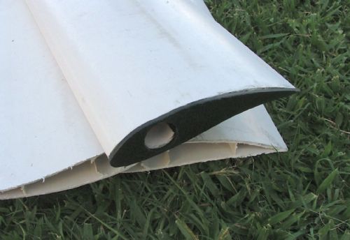

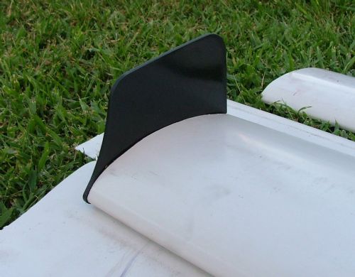

Do I see a closed cell in the trailing edge? That will help torsional stiffness. The biggest part of the torsional stiffness will still be the tube down the center and the end caps.
Very ambitious, adding a "plate" to the tip's end cap. I hope you have lots of spares because it will take a lot of testing to prove what works and by how much.

I'm going to fit a set to my dual stator windmill this weekend, 2.6m diameter. Standard 1 inch exhaust tube will fit up the middle of these blades, and for the first 400mm from center ( most stressed part of the blade ) I'll slide in a length of 22mm steel rod. The 22mm rod is a neat fit inside the exhaust tube. I'll buy these today and post some pics as it comes together. Will keep an eye on the weight as I go.

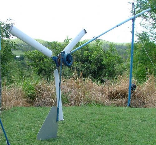

Posted: 08:32pm 25 Mar 2009
Great, Glenn! Now forget your job, drinking and eating and leave your wife and children so you can do lots of testing of the new blades!
Hub mounting of a formerly available extruded alu prop: The pipe of each prop was bolted via two U-bolts directly to the hub. This allowed altering of the angle-of-attack.
Winston Churchill

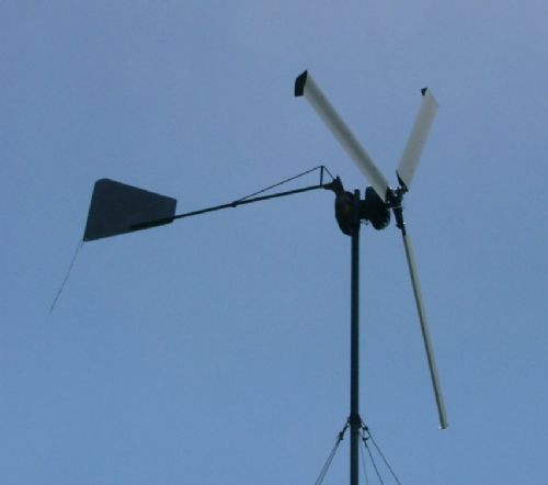

Posted: 08:52pm 25 Mar 2009
Just what I was planning Dom. I'm going to use the hub I made for testing the Chinese fibreglass blades.
Makes it easy to change angle, though I think I would prefer a 3rd U-bolt for each blade.

keep an eye on the weight. Low inertia is hard to beat. My wooden blades weigh 600g each. The amount of steel and the adapters needed for the PVC ones will add up. UV protection with a decent thickness of UV block paint will add more again. I hope you can keep the weight below 1.5kg per blade.
Gordon.
PS edit : 3m for 4kg! you may be looking at up to 2kg per blade.Edited by GWatPE 2009-03-27
Posted: 12:20am 26 Mar 2009
I agree a low inertia turbine with give a small gain in a gusty location, but thats not what I wanted.
My timber blades weigh 1.2kg each, my PVC blades on the 2.6m turbine were 2.3kg each, and I had 6 of those! My Southern Cross windmill has a dozen steel blades, the whole turbine would be over 25kg. All these turbines worked perfectly well for me.
I could replace all the steel blades on my Southern Cross windmill with hand made carbon fible blades, save 10 or more kg in weight, and maybe it would pump a few more liters per day, but does that mean I should abandon the Southern Cross windmill just because its got a heavy turbine? No, because what it has works perfectly well.
Yes if I spend the time I could make a lightweight blade, but that is not what these blades were designed to do. Remember these blades were meant to be cheap, cut to length and easy to put together. We used the same profile the Windcharged turbines have used for many years, see http://www.royalfabrication.com/. The PVC used already has a good UV resistance ( I would need to contact Wes to check the exact ratings ), but yes your would still need to paint them, PVC white isn't a pretty colour.
I could have a high performance lightweight blade made, using fibreglass or carbon fibre, in a range of lengths and TSR's. But it would cost you many times what these PVC blades are worth, and you couldn't experiment with them.
These are blades for the people. If you want the best, then dont buy these, go and make your own. But if you just want a turbine thats a little heavier, a lot cheaper and easier to make, and has 80% or better of the performance, then these are a good choice.
