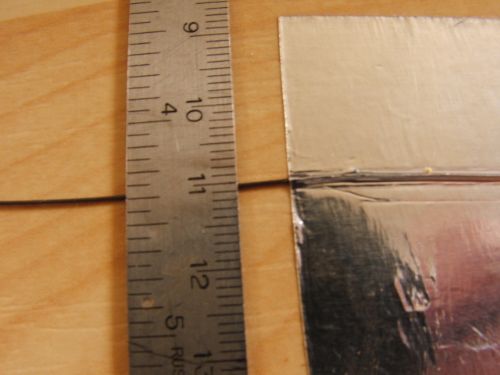

hi richard
heres what i tried almost 1mm thick
the origional bergey ridge really is very small about .2mm
it just looks like a slight manufacturing fault

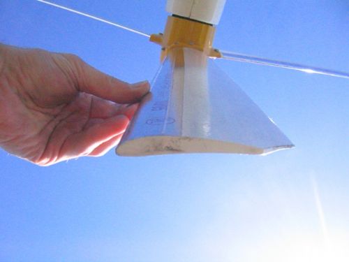

hope electronbaby doesent mind heres his mod
i used aluminum tape which sticks pretty well (to well as trying a slightly thicker line will be a pain in the )
somewhere around 1mm might be a good starting point ...3mm sounds big though

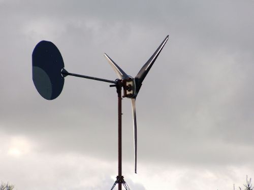

Sorry Richard, i assumed mine would be the new type as i only bought it last nov. but it has straight blades so we are running on different tracks. Am a novice with these bloody computers so wouldnt know how to put a picture on here even if i had one!
rgormley
Joined: 22/02/2006
Posts: 245
Posted: 01:20am 02 Apr 2009
look like this?
or
Edited by rgormley 2009-04-03

Gday Richard, sorry i never got back to you, my mill is the one in the first picture with the barn. Thanks Glen, the mod to the blades works great, dont know why or how, but dont have to! Yep those masts, especially the mounting plate leave a lot to be desired....cheers Pete.
