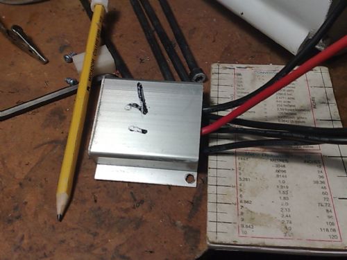

Posted: 11:27am 17 Mar 2009
This shows the rectifier/regulator unit

Looking at the PL-20 wind sheet 2 info, it appears to me that the electrons flow directly to the battery and not through the PL-20. So how can pwm regulation be achieved?
Please keep in mind that my mill is theoretically capable of 40a+ so needs to be connected to the L- on the PL-20 via a relay. (And my lack of electronics experience)
On another note, I plan to replace the current rectifier/controller unit (this is inbuilt). Is it better to use one high current bridge or three smaller units (the gen is 3 phase). I would like to try your voltage doubler as I only have 5m/s average wind. Is this viable on a 12v system.

http://www.virtualvillage.com/Items/007901-004?&caSKU=007901 -004&caTitle=3%20Phase/DC%2075A%201000V%20SKBPC%20Bridge%20R ectifier
The above link is the rectifier I used for the wind mill
I mounted it on a 8mm piece of aluminium and pulled out the slip rings ( these gave me grief ) drilled a holt out the body and run the wires outside ( when inside without the slip rings the wires twisted up )
So now it seems to work fine .
