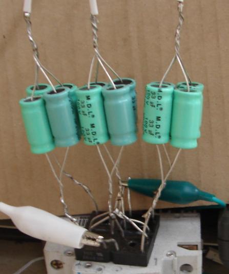

Posted: 09:03am 07 Mar 2009
Hi Richard,
here are the caps and rectifiers I put together for the voltage doubler on my F&P mill. These were 66uF[2x33uF,100VAC, from Jaycar] F&P frequency dictates smaller caps, approx 1/4 the size of those required for a 500W chinese mill.
the caps I recommended to use were 470uF, so yes the 100uF are 1/5 of the necessary size.
More importantly with the setup, did the windmill change how it responded to the wind when the doubler was connected. ie, did it slow down when connected.
What is the minimum current you can measure with your meter?
The caps do dissipate power, so it is important to not glue them together tightly. I use hot melt glue on the larger can type caps, where the gaps are quite large, and only to tack the caps together at the ends.
On my mill, I have measured current from 10mA up, once cutin is reached. for example, today I checked mill cutin at 40Hz [approx 90rpm], and by 50Hz [110rpm], the current was 0.2A [6W]. by 60Hz [130rpm], the current had increased to 0.4A [12W]. This is all power that would not normally be captured as cutin would be at approx 170rpm.
more wind and bigger caps will provide a better result.
