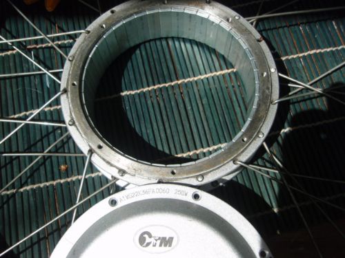

Would this be the item being commented on.
Its 250 W at 36 V with dimentions of 160mm dia and magnets 40 only at 40x10x3.

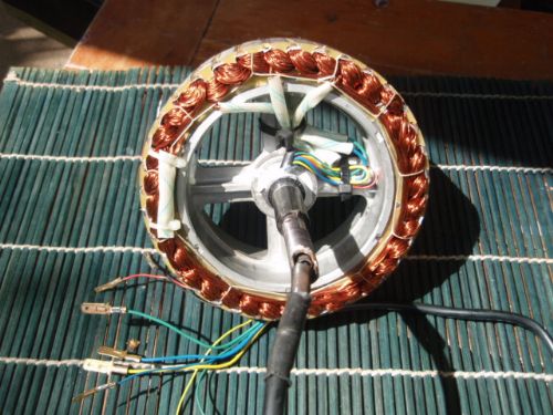

Posted: 09:08am 01 Mar 2009
I have one of those hub motors. Mine has 46 magnets, 52 stator poles, and the stator is about 200mm diameter. Its rated at 300 watts. There is no cogging, and its easy to spin by hand. I've been meaning to put together a test jig to see how it performs.
The weak link in these motors is the wires that lead in through the axle hole. The stator itself uses multible strands of .8mm wire, giving a bundle diameter of about 3mm. This is then connected to 1mm wire to feed out the axle . I think with 3mm lead in wires these motors could pump out much more than the rated 300 watts.
To use as a windmill alternator, I would mount the rectifier onto the stator, then connect the -ve output to the axle shaft, and feed a single 3 or 4mm +ve wire through the axle hole.
I dont think the axle itself is up to the job as a windmill without some strengthing.
