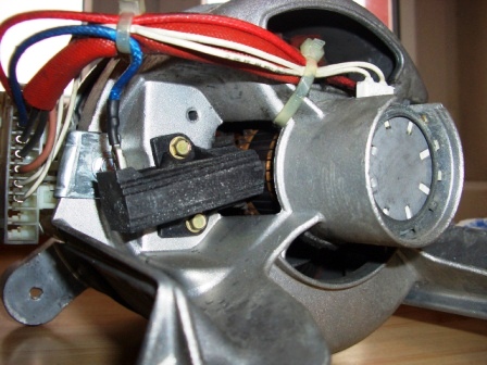

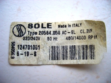

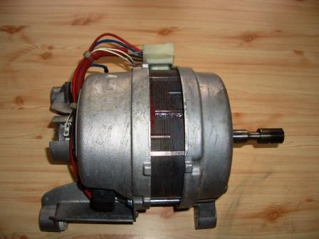

Posted: 12:50pm 26 Feb 2009
HI All
Here are some photo's of the Zanussi motor...
Is this a good candidate..?
Matt
