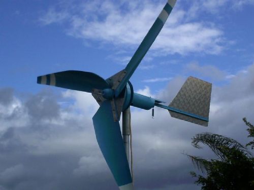

Has been awhile since posted here but over last few months have managed to get up two dual stator mills up
and quite happy with the result.
This joint project between one technically minded and one practically minded has been much fun and many
challenges.
Have spent likely no more than couple of hundred dollars and used mostly salvaged parts and six F&P's to put
together. Blades are all aluminum and seem to work well. Wiring of stators is not my bit but are mix of
star and delta.
My question re batteries, we have two cloride sodium and two lead HD batteries, maybe 400amp total. Both mills
through one controller. Is it not so good to run mixed batteries? Run a 1200watt inverter which runs shed etc.
Some pics. In moderate wind, below 10km with two mills getting 5amps and up to 35amps in 30km+ winds.
Cheers for now goin fishin.
PeterEdited by RevUpWind 2009-02-24

... More appropriate to the topic: Thanks for posting the pictures of the windmills. Congratulations on the twins!
Are there any major differences between the two mills? The tails look different, for example. Seeing two identical machines side-by-side makes me think of a plethora of little things that I could change on one, and then compare to the other, to see what difference they make.

Just one big happy group and clever too. Have to say that without you would not have a clue how to get an F&P together.
SparWeb the mill with firey tail went up 3 months ago and the red, white & blue last week.
A lot of mast and hardware were a case of beer from local Ergon Electrical supply contractor. Nice fully hot dipped galvanized HD pipe. New mill is a local tree which is working great.
Both blades are aluminium and basically same shape, although first was done on a brake and second one rolled, on a fence post would you believe.
Both tails work fine, main change I made that have not seen was to use the F&P plastic bearing mounts and shortened shaft welded into the mast using spacers to allow the wire down the inside of mast. This works very smoothly.
Used 90mm RHS for yaw and main shaft mounts.
It is interesting to see them work together and bring up the averages from 2-5amps to 5-10amps and peaking at 35amps. With some better cabling on latest should even get better.
As for wiring first Flame mill #1 stator is 2x6 Delta with two poles tmp unused #2 stator is 2x4 Delta and 2x3 Star wired in series to make a 6 pole Star and the newby Red, White & Blue #1 is 2x7 Delta and #2 is 2x4 Delta
and 2x3 Star. This one achieves higher RPM without stalling and does not idle aimlessly in light wind.
Flame mill idles slowly in low wind without effectively making much power so will change to same as new mill.
It is good to have two mills to compare. Edited by RevUpWind 2009-02-24

  RevUpWind said  main change I made that have not seen was to use the F&P plastic bearing mounts and shortened shaft welded into the mast using spacers to allow the wire down the inside of mast. This works very smoothly. Used 90mm RHS for yaw and main shaft mounts.
Hi RevUpWind,
I see no evidence of wires inside the mast/tower in your photos. I see the plastic yaw bearing mount, but photos 1 and 3 show wires running down the outside of the mast/tower.
As Robbo has mentioned, It would be interesting to know the Watts. Are these series80 stators? Have you seen the windmills furl yet? How much of the inverter loading power do the windmills supply?

Stators are both 80 series and will wire both the same. First mill, Flame has a pipe mast and the wire goes into the side of the yaw mount and down thru pipe. There is
a hole already in the bottom of plastic bearing mount that I drilled out to 13mm. The wire is a rope from the tail to the ground to stop rotation which does not seem
to be a problem here anyway. The new mill is on a timber mast so just a loop and down a guy wire.
New mill has not furled yet but the Flame one has at approx. 30km+ which new mill has not seen yet.
