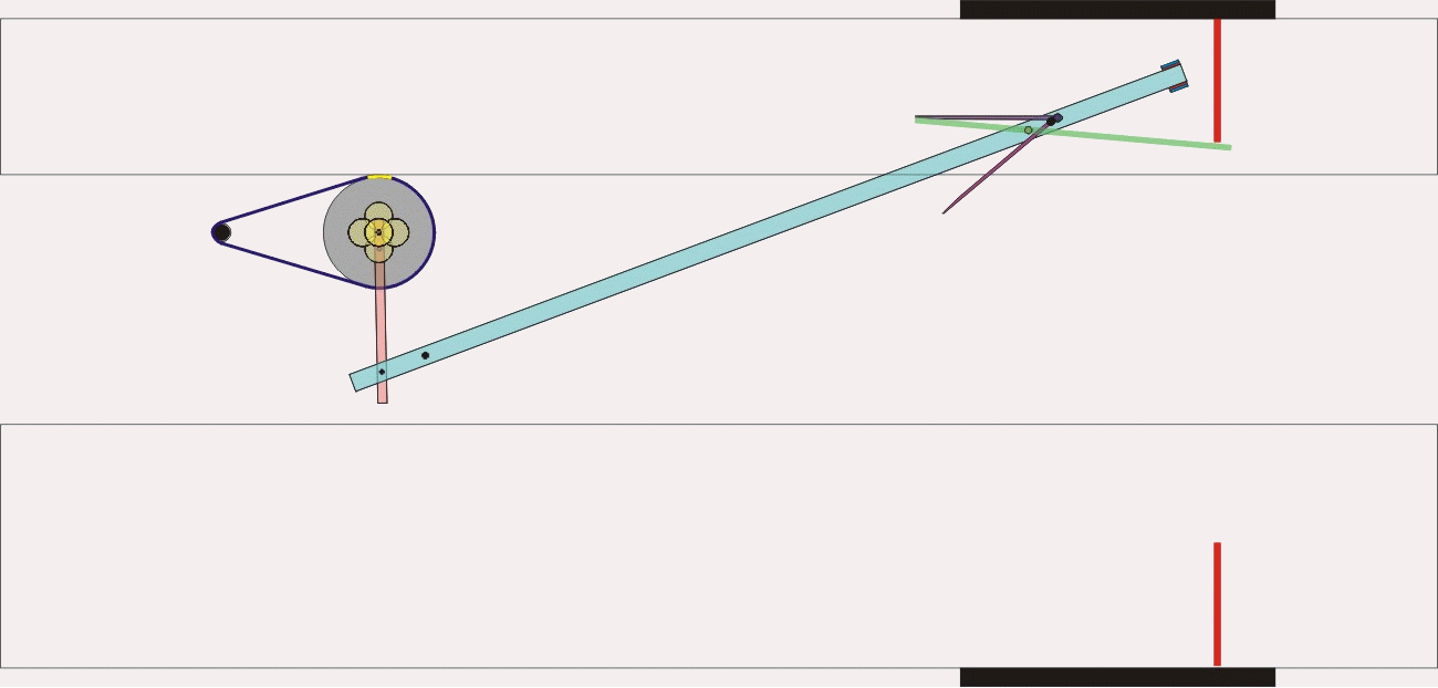

this project is for fun and for the challange.
my idea to create a wave like wing that when facing the wind it will rise and once on the top i will have amechanizem that will change the direction of the wing to face downward and so on, up and down. the question is
Will It Fly....give me your thoughts.

  faroun said  my idea to create a wave like wing that when facing the wind it will rise and once on the top i will have amechanizem that will change the direction of the wing to face downward and so on, up and down.
Hi faroun,
You really need to show a mechanism that alters the angles, so we can see. I think you mean that the blue bar is actually a wing section and the angle of attack is altered, to change the lift.
Gordon.

ok, i am slow at this, but i will draw the mechanism that shows the pitch change and i will post it soon.

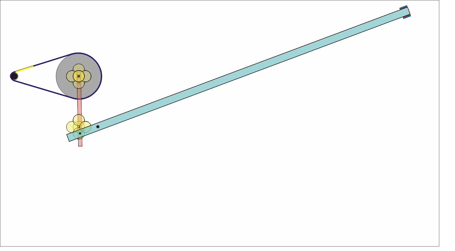

hi there guys,
John check it out i managed to show the mechanizim on how it is supposed to fly...i gusse...
the question is,..is it worth building just for fun?!?!
what do you think?

Hi faroun,
This is not as I imagined, but would probably still work. You may be able to use magnets as latching devices to hold the vane during the power strokes, a bit like cupboard door latches. Automatic furling if the wind is too strong with the magnets unable to hold the vane. Gravity would come into play and return the unit to the bottom of the cycle and reset the action.
I cannot see this being more than a talking point though.

i am glade to suprize you with my crazy howto, thanks for the extra tips, you could be right, regarding it is just a rendering. i just need to get unlazy and start building the sucker...lets wait and see what others might think....thanks

Looks like fun, you may power a few leds... well .... maybe, but a talking point for sure.

True. But your frontdoor isn't connected to a generator and being loaded. The frontdoor behaves more like an unloaded windturbine in a runaway situation. It's important to distinguish between energy and power.
To the OP: Don't want to sound too harsh and rain on your parade, but this entire contraption looks silly and overcomplicated to me. I count 6 pivot points/bearings, and a belt. Not sure why you are wanting to convert linear motion into rotary motion, when it'd be much simpler to start with rotary motion in the first place. I expect it'll be noisy too, as the flap moves over twice each cycle. The repeated up and down acceleration will be hard on the mechanism as well (think 'reciprocating engine' vs. 'gasturbine').
But if you really believe in this idea then definitely go for it and build one, then report back here. Should make for an interesting story once it's finished and working.

Converting linear motion into rotary motion (or reverse) isn't very hard to do normally. It was used in reciprocating steamengines as well. However, in that case the linear motion is longitudinal, whereas in Faroun's case it's transversal. And that case is a bit harder, requiring an extra linkage...
