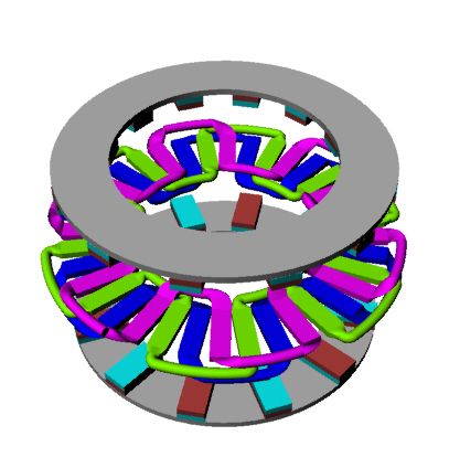

'Innovative ideas' are usually cheap or free and when it comes time to innovate ... well somebody forgot to tell the designer there had to be an economical way to fabricate the parts. With that in mind, I present a novel approach, or not so novel if one immerses oneself into older publications, on building an axial flux generator.

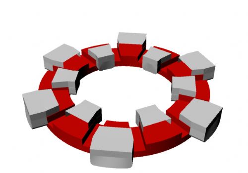

The first model is of the stator and magnet plates. This shows a wave wound thin stator. If my numbers are correct, I should get ~50 turns #19 AWG wire I should have twice as many 'cuts' of the flux as a 12 magnet 9 coil machine and a greater flux density. (.0359" diameter wire, slot is .345" X .25" deep and 60% fill was used.)

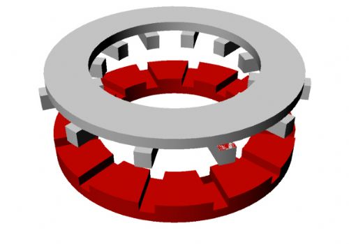

One question is how can it be wound. My second model should explain the top and bottom coil winding I plan on starting off lining the slot with 6mil polyethylene with a couple of straight pieces of fiberglass as used in roving or chopper guns. Then, the copper will be laid in trying to keep the lay somewhat straight When the turns get to proper fill, more glass fiber will be laid in. The coils will then be clamped with the jig shown, the top pulled, a calculated amount of resin and hardener applied and the plastic wrapped over the top and back into the clamping blocks.
After curing, the coil will be removed. A second coil will be wound in reverse and treated the same. A third coil form will be used for the center coil. The three should mate and fit flat I'm not sure how I will bond all three together. I do have some ideas. I will try to leave turns at the outside and inside as free of resin as possible for heat rejection. I will use a lot of resin saturated glass for strength.
Proposed magnets are 1" X 2" X .5". Inner circle is a 4" radius, outer circle is 6" radius. Magnets will have a layer of glass fiber (edit: finer- typo) laid on tops and sides, bonded on before placing the magnets on the rotor plates. There will be minimal epoxy used to bond and pot the magnets. A few turns of stranded glass will circle the magnets as well as a strand or two of Kevlar.
Coil length figures 61" a turn or about 304' per coil, 2.45 ohm. Total copper weight about 3.5#.

Ron, are there 12 coil legs and 24 magnets, or am counting wrong? thanks, pepa

You are correct "12 pole".

Hi wdyasq,

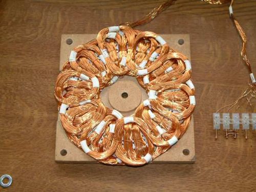

I suppose my AxFx machine is not wave wound, but has interleaved coils at least. I am intrigued by the amount of wire needed, 3.5 pounds. My completed stator with wire and glass filler only weighs 350g.
What expected power output and what output voltage are you hoping for? If you are planning on leaving the inner and outer turns free of resin, I am intrigued as to how this stator can then be mounted.
Gordon.
PS edit: the arrangement you have is difficult to picture. There appear to be too many magnets, but this may be the 3view. On closer inspection with the top plate reference, this will be OK. Escher would be pleased.Edited by GWatPE 2009-01-21

Ron,
Leaving the blue phase as it is, you will have to rotate the purple phase 10 deg. CCW and the green one 10 deg. CW. Either that, or reverse the start/ending connections of the blue phase, if you want to end up with true 3phase with 120 deg. phase shift between the phases.

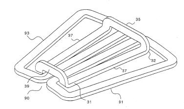

As you already mentioned, the idea is not new:
Your wavewound method will yield you the equivalent of 6 normal (round) coils per phase, so 18 coils for the entire generator, whereas the common axial flux has 9 coils total (3 coils per phase) in a 12/9 dual-rotor axial flux generator.
If you can build it mechanically, I think you're on to a winner. You will have much more copper (kg) in it than in a normal axial flux, which should translate to lower resistance and thus less I^2*R losses. If you can build it flatter than the normal axial fluxes too, you'll have a stronger magnetic field as well, so can get away with even less turns of copper wire, i.e. less resistance and power loss.
I think I would try to wind all the three phases in one go on a mould (with some glasscloth already in it before winding the first phase), then impregnate with epoxy, rather than your plan of winding the three phases individually and then try to mount them together, but we already discussed that.
The stator will take more effort, time and care in building (needing more and elaborate moulds), but it should be doable. And yield a superior generator.
Aren't there laws against thinking outside the box?
Peter.
Edit: you may want to look at this patent (5.744.896) too: http://www.google.com/patents?id=iesnAAAAEBAJ&dq=5744896 Not a wavewinding, but still... the method described in this patent using discrete coils looks more easy to execute in practice.

Ron,
Very nice rendering. Interesting design. What power are you aiming for, at what voltage....It would be helpful if you would provide enough information to form a useful opinion on this design (hehehe insert evil grin here...)
Ok, your stated resistance is incredibly high, and I would hope that you are aiming for a high voltage machine... otherwise I^R losses will kill this off for any useful power . In star it will be 5ohms or so. I don't fancy putting too many amps through that setup. Mine is about .6ohms, for 48v 130rpm cutin and I keep it to less than 20-30A at furling.
Without the voltage figures and expected power outputs, we can't determine how effective you will be with the cooling idea...... which brings us to the mounting as Gordon has pointed out..... how is this to be achieved?
This article on Fieldlines discusses the pro's and cons of this design.
I think that this is effectivly what you are describing.... may have to look closely:
To get useful output you need to aim for sub 1ohm resistances at 48v in either star or delta. I assume you will be going star?
If your voltage is 250v or so, then 5R is ok, if at 24v then at 240 watts you will have 10A through your 5ohms in star... so losing E=IR = 50v lost in the winding or 500watts?... in Delta, it will do considerably better r=2.5/2x10=12.5v or 125 watts lost.
Need more information.... but looks pretty sad on these figures.

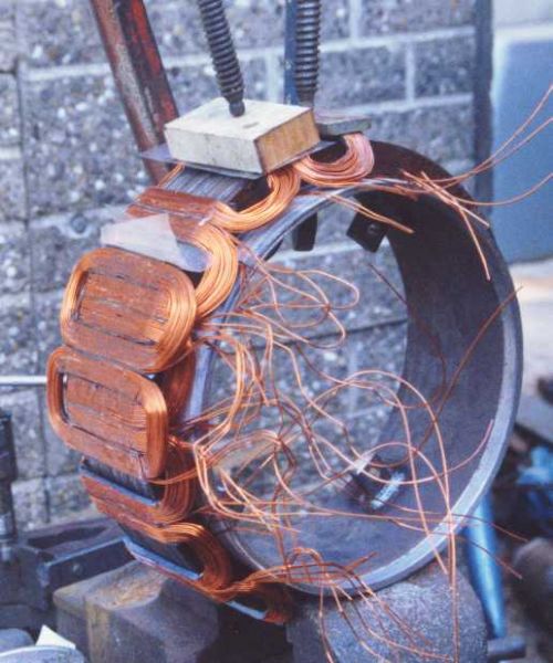

In regards to the "flattening" of the winding space for 3 ph design, this picture from Les Vincent (from Scoraig wind site) shows a radial version of the kind of layout you seem to be trying to achieve in your axial winding
this does 1kw@320rpm @70% efficiency.
or a completed one from Thomas Moore (NZ)
Perhaps Dinges, you should do this with your induction motors Edited by oztules 2009-01-21

It seems as though something else I have made has now been patented by someone else, many years afterwards. This goes in the same bucket as SplitPiConverter.
I was able to wind my coils in such a way as to keep the phase to phase resistance the same though.

I am bemused. My AxFx alternator has similar magnet volume and probably similar power rating, yet the fully made stator including encapsulant resin and glass fibre weighs in at 350g,[12.5oz]. You calculated the wire alone to be 3.5#, or 56oz, or 1568g in your configuration. This is 4.5 times more copper. I have some internal pics here Gordon's AxFx alternator pics
I hope your testing comes back with really high volts/turn to justify this extra copper.
Gordon.

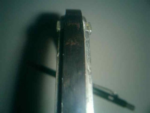

Hi Ron,
Thanks for the rap. I wish there was a way I could mass produce it.
The wire is not square. The wire I had made was 10 in hand, 34#.   these are 0.15mm dia enameled wires. [pretty close to coarse hair]
I see no benefit with the longer magnets in a small dia axial flux arrangement. You may as well use more smaller magnets at the larger dia. There is an awful lot of air, that serves no useful purpose, in the segmentation gaps between the magnets. twice as many square magnets at the outer radius will give twice the flux transitions at the same rpm. I pushed more magnet in by placing the magnets side by side. I would like to have used segmented magnets, but square was all that was available.
I do not wish to put you off, but the simplified way that axial flux mills are made now, with the wider airgap and round magnets and round coils seems to be the way to go. I am tempted to make one this way, but with a closed rotor, with an internally mounted stator. I am not keen on the elements having free reign access to the magnets and stator.
Oztules seems to have a good combo and low resistance is a must.
Gordon.

I had wondered how to describe the way I wound the coils on my AxFx alternator. The spiral in spiral out does nicely. I started at the inside turn, and wound both ends out, simultanously and in opposite directions. This is what I used the mould for, that I gave a pic of here.
I had considered stacking of multiple units as well. The problem that is encountered is assembly. Supporting the rotor and aligning of the stators between sections will pose some engineering problems. In my design, the axle could be through bolted. The rotor could also be through bolted around the perimeter. The inner bearings would need to be removed. The rotor would only need to be supported on the outermost bearings. I would imagine you could throw a lot of crinkly at the problems and get a solution though. There are real engineering problems with designs that incorporate large amounts of permanent magnetic material. I guess this is why usual power station alternators use iron and electro magnets.
Multiple stators could make a more compact alternator, but I could not justify the complexity when I built my AxFx unit. I don't think too much has changed since then.
Gordon.

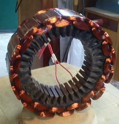

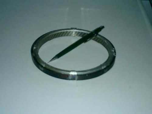

Oztules, I've actually considered doing something like this. About a year ago I checked the motors whether they had a perfectly round outer stator (no flats/slots/etc.). Only one of the 6 or so I checked was perfectly round. I'm saving that stator for exactly this purpose.
Recently I stumbled upon this rotor from an old ceiling fan:
After removing the aluminium casting bits that were in the way, I ended up with a perfectly round laminated iron core, 10mm wide, 153mm outside diameter. This should make a nice little (100W?) non-cogging iron cored radial flux generator. Likely will never happen though, as it'd only be a plaything. I'm not going to invest my time and effort building small generators, when nearly the same effort would result in an actually usable large generator. But maybe someone else has some use for this idea.
Peter.

Thanks for the response, and the link to the Otherpower.com forum. Actually, the photo of the multi rotor machine sent in by Powerbuoy on 26-03-06 is very similar to the mechanical construction that I had in mind.
While I take the point that large diameter single airgap machine may make more economical use of materials (and perhaps be more efficient?) than a multi-rotor machine, there are some points that should be considered before we all walk away from the multi rotor concept.
The first point relates to the number of phases that you can readily fit into a single stator. Generally, the more phase coils that you have, the wider the air gap that you will need to accommodate them, and I imagine that the 4 phases that Gordon has used would be about the practical limit. A wider air gap means a less efficient use of your magnets.
The old bugbear of audible cogging (or clogging, if you are in to tap dancing) under load will diminish as the number of phases increases, and many phases are possible with a multi-stator machine.
As a flight of fancy, a two phase 90 degree displaced wave wound stator could be produced using something similar to a double sided printed circuit board. The problem is that the copper in PC boards is in the wrong plane (bad for eddy current losses), and is ordinarily way too thin anyhow. If you could somehow get thick copper each side and photo or laser etch the winding so that an adequate area of copper could be obtained with the thickness in the axial plane, you might have the basis for a mass produced multi stator alternator. Not really a back shed project though.
At a lower flight level, it may be possible to use wave or even double spiral lap winding with copper (or aluminium) ribbon, interleaved with insulating material a la capacitors? That would at least put the conductor width in the appropriate axial plane. Or you could do the smart thing, and use a kind of Litz wire, as Gordon did.
On the Otherpower site there was some concern expressed as to the effect on flux density of having more than one air gap per pole. Some seemed to think that having two gaps would result in only half the flux density in each, or somesuch.
While I would not have expected this with multiple magnets, flux density was also of concern to me, as, should the flux vary significantly across the air gaps in a stack, then the voltages produced by the stator coils would vary, and cause problems.
I have made up a rough rig and taken some flux measurements of different air gap arrangements with magnets that I have on hand From my tests, it seems that, as long as you have the same length of magnet per air gap, the flux in a closed circuit stack of magnets and gaps remains pretty uniform (length does seem to matter, in this case).
