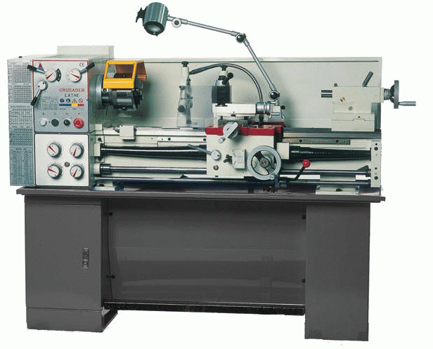

Here we are Tinker, nothing terribly fancy, no digitial readouts or CNC, a basic lathe that is big enough for anything I am likely to do, maybe bigger than I was looking for but this one came for the price of a smaller one.
The only difference between this picture and mine that I can see: All one colour (no yellow or red), the light shade is a different shape, it is not called 'Crusader', mine does not have the nifty socks on the feed screw.
810mm between centres, 310mm maximum swing, 38mm spindle, 2HP(when fixed), 9 speeds (75 - 1810).
