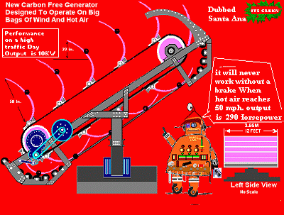

The Different windmill,, The text was copy and paste from
MS notepad. I'm not a whiz at Typing, I saw no reason to type it twice Though the format was not to my liking it was
a little difficult to find my way around on a new site.
Interested persons can view a drawing at http://www.instructables.com/community
Green/Santa ana. My user name is (Yeasayer)
Posted: 02:08am 13 Jan 2009
Here's a link.
http://www.instructables.com/community/Santa_Ana_Wind_Engine /
I think there would be too many losses through friction for it to work for wind power, though it should be ok for hydro. Why not replace the belt loop with a wheel, much less loss and less moving parts.

Yes, I too fear too much friction to be viable as a wind machine. Besides, this is a drag machine and has none of the power generating lift that a good aerofoil can produce.

I am aware that this machine would have operational friction and although the drawing is a basic concept it is not a blueprint, there are ways to improve the rolling
efficiency of the belt such as fabric only with rubber
faced rollers. also the push plates should be equipped with caster wheels or similar to lawn mower rubber tires.
Used in a track to fold the plates and also to carry the
plate on the return. this is a later Drawing of this thing.Note; I am not trying to sell this I'm not making parts for it to sell.
Please note the tilt up angle for operation and realize that I have down rated the output due to Wind shaded plate area. a slight side angle to wind direction would allow full plate area exposure and would also increase
the belt speed. Pardon the YAK YAK

Anyony can get large numbers when quoting high wind speeds.
My 2m dia windmill AxFx, has raw wind energy rating of around 30hp at a 50mph windspeed. The windenergy available is only that calculated at a particular windspeed and a particular wind capture area.
I rate my windmill at 450W max, due to mill preservation constraints. Your design would sound like a factory with all the mechanical components etc.
