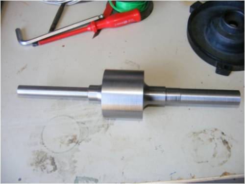

Hiya Guy,s
Well after dinges prompting I've decided to start on this conversion. I've machined the new rotor to spec's
Now to get the 43.75 degree angle today I spent 4 hours just to find out my division plates on my dividing head wont do the right angle.
To get the right angle I need to make a 105 hole division plate and use 96 holes and 4 turns. This is what took 4 hours to work out.
Cheers Bryan Edited by Bryan1 2009-01-07

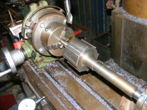

Posted: 11:27am 07 Mar 2009
Hiya guy's,
           Well finally I got some time to back to work on the 2hp conversion and tonight I milled the rotor.
Tomorrow I'll install the magnets and epoxy them in and hopefully on monday I'll be ready to give it a decent test on my lathe.
Cheers Bryan

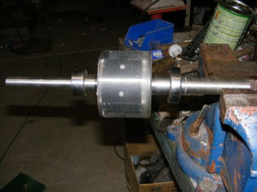

Bryan1
Joined: 22/02/2006
Posts: 2298
Posted: 08:55am 09 Mar 2009
Wellguys I bit da bullet and superglued those broken neo's in. I also epoxied them in so wedneday night I'll be machining the rotor and I'll put a pic up of the finished rotor. The superglue held the broken mags in place nicely and my crude but simple pole tester using a ugn5303 hall effect sensor a resistor and led worked a treat.
O'well lesson learnt about handling neo's be bloody carefull.
Cheers Bryan Edited by Bryan1 2009-03-10

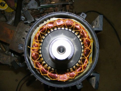

herbnz
Joined: 18/02/2007
Posts: 258
Posted: 06:47pm 15 Mar 2009
Hi Bryan
Just a thought I see you have a winding in, you have not got connected in any way ? particularly in delta as with phase shift due to displaced magnets you would get circulating currents would feel like cogging.
