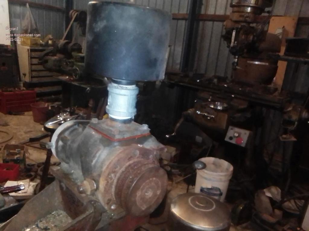

Bryan1
Joined: 22/02/2006
Posts: 2298
Posted: 03:20am 21 Feb 2022
G'Day Guy's,
            Here is a pic of the screw compressor
Now I have some 6" diameter thrust bearings with 1/2" ball bearings so one will be used for the drums to sit on. I will be using 50mm diameter thick wall pipe as the centre pole and below the thrust bearing frame I'll put a 50mm flange mount bearing and use the 2 grub screws on the bearing to lock in so the thrust bearing will be set. Then another flange mount bearing will go on the base to complete the shaft setup.
Now in order to brace this frame to the ground side plates will be welded to base frame and holes big enough for star pickets to go thru then when fully hammered in welded to the base plate.
I am now thinking of going 3 drums high and this will make the total height about 3.5 metres. Now as the wind is different a couple of metres up this should provide an easy startup.
One use I will have for the compressed air is pumping water out of that 60 metre deep 3" hole that will be about 50 metres away from the unit. So when all of my air tanks are full the air can be used for raising water and keeping all of my dams full.
Cheers Bryan
