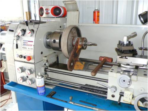

Hi Gordon and everyone ,
Hopefully soon I should have a test bed set up for doing the performance tests with caps , I looked at setting a dual stator up direct into the lathe chuck but feel a little hesitant about the start being so quick , also the speeds do not give much away for low speed performance data [spindal speeds are 65 100 180 200 235 280 300 330 360 500 550 700 840 910 1095 1200 1400] .. This may be ok for initial tests but misses a lot between 60 to 275 rpm , so as time allows I wiil make a pulley drive that mounts into the chuck and mount the ststors into the gap bed with an idler that can slowly engauge the stators at 2:1 or whatever ratio is required .. Any thoughts are muchly appreciated

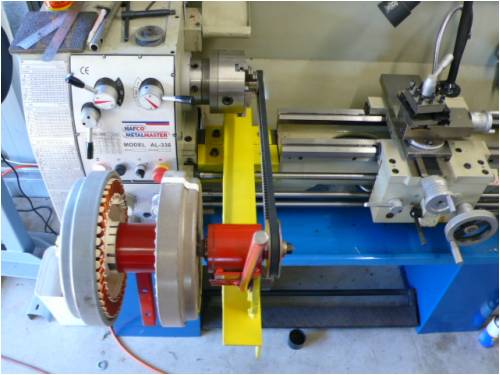

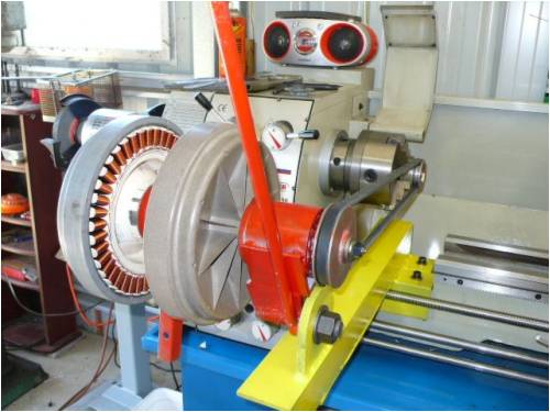

Posted: 11:46am 18 Dec 2008
Hi All ,
Finnished the test rig for testing , I have taken Gordons and Herbs advise and built it so the torque arm between the dual stators can be rigged with a spring scale or I was thinking of a set of digital kitchen scales and a roller bearing on the end to push on the scales , I have drilled a couple of holes in the arm to allow the arm extension to go on later as I am not sure what length to have it .
The reduction of the lathe is 1.6:1 and I have a larger pulley to use that will probably be 2.8:1 so I should be able to cover a fair range of speeds below 400rpm .
Hopefully as stated , with the mesurement of the torque , the tests will not be masked by other variables ...
As you can see I have used one of my dual bearing housing to allow the whole dual stator to be floating , of course the test does not have to be a dual as one stator can be removed . I was running it today at no load , no declogging and the small 200g scales I have were reading 170g @ 40rpm , as I do not know the caculations for the HP or watts at a certain length I will leave that to be informed of through the forum as I am sure someone will know and will be able to give a standard torque arm length .. Regards ..
Posted: 12:22pm 18 Dec 2008
Hi Phill,
you have been spending too much time at Bruces. Too clean for me and all that fresh paint. Only kidding!
Great job.
