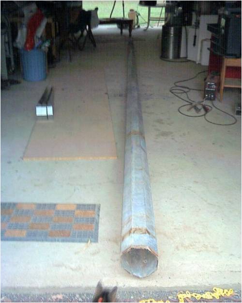

The guyed tower consists of an 8m octagonal pole as used for street lights with a 6.5m length of 3" water pipe ontop of that and then around 3m of 2.5" water pipe at the top giving a total of 17.5m.
This is the base of the tower after rewelding it back together as it was found in two halves.

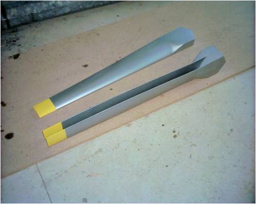

These blades are carved from laminations of 18mm plywood as per Hugh's instructions although I measured them today at only 1150mm long so the dia is 2.3m. They were then given kevlar leading edgesand carbon on the MAC and coated with woven cloth and epoxy resin. The finish is 2 pack paint.

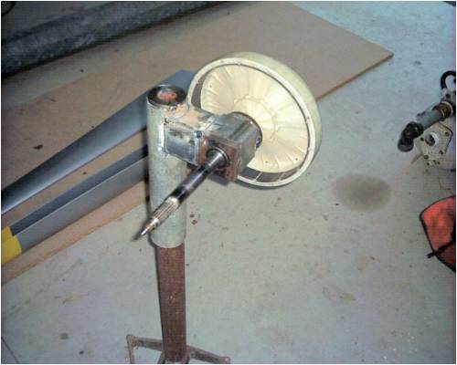

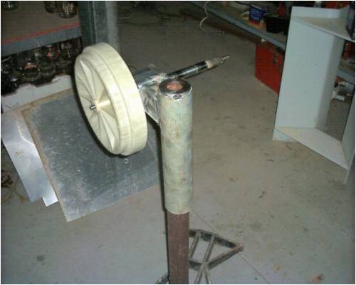

This is were I am up to with the head of the machine. It's based on a 60 series F&P which is wired for 2 pole star or delta. I wish I hadn't rewired it now as I think I am going to have trouble getting the voltage I need.
I still have to sort out the furling system. I had an idea to make a spline for the prop drive. I'll drill a series of 20 holes, 2.5mm dia on a 19.5mm PCD into a piece of 50mm bar. Then machine the centre out to 19.5mm which should leave me with a spline which should provide enough drive for the F&P system. Then weld the 50mm bar to the prop back plate and away I go. The dimensions might need tweaking but I'll double check that before I start machining.

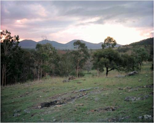

The tower will stand somewhere here. The tall tree's will be lopped. My problem is that the tower will be approx 82m from the batteries plus the height of the tower so say 100m. That seems a long way to run a potentially high curremt. My questions is, am I better off running the ac down tho the batteries and rectifying it there or should the rectifiers be up the top of the tower? I want to be able to switch from star to delta from the ground so I am guessing a three phase contactor will do the trick on top of the pole but I am unsure where would be best for the rectifiers.

I think the 2.5" top section is too weak.

It is a tall order to expect that a 2kW mill would survive lifting from the horizontal, or any decent wind on a 2.5" water pipe for the top section.
Gordon.

Thanks for the info Gordon. The street light pole I am using for the first 8m is tapered but it starts at 200mm and tapers down to 125mm with a 75mmOD heavy Tube on the end which will be a snug fit inside the 3" pipe. Any idea of a good source for wire rope?

The wind loading of a 2kW mill is far greater than that presented by the original street light that would have been attached to the 75mm section on the top of your pole. The mill nacelle will be at least 1.8m above the guy point for a 2kW mill.
Good luck with a 75mm pipe!

The top of the pole is the problem, above the guys.

well,, I guess Phill's lesson should tell you a bit about forces ,Chris.
A 2Kw mill is not a toy,and unless you really construct the tower very strong ,then you are in for big time trouble. Remember ,that street light tower only had to hold a 10 Kilogramme light fitting ,and, more important, they are constructed so as to fold quickly when a car or motorcycle hits them,for safety.
My tower is 4x4 x 3/8 structual tower steel (off a tv tower) with 1 inch dia bolts clamping the steel back to back..the guys are 3/8 inch tensile steel hard drawn 7 starnd with 1/2 inch thread turnbuckles.
and my mill is only around 600 watts,she still screams in a big blow .so what would a 2 Kw job do?
