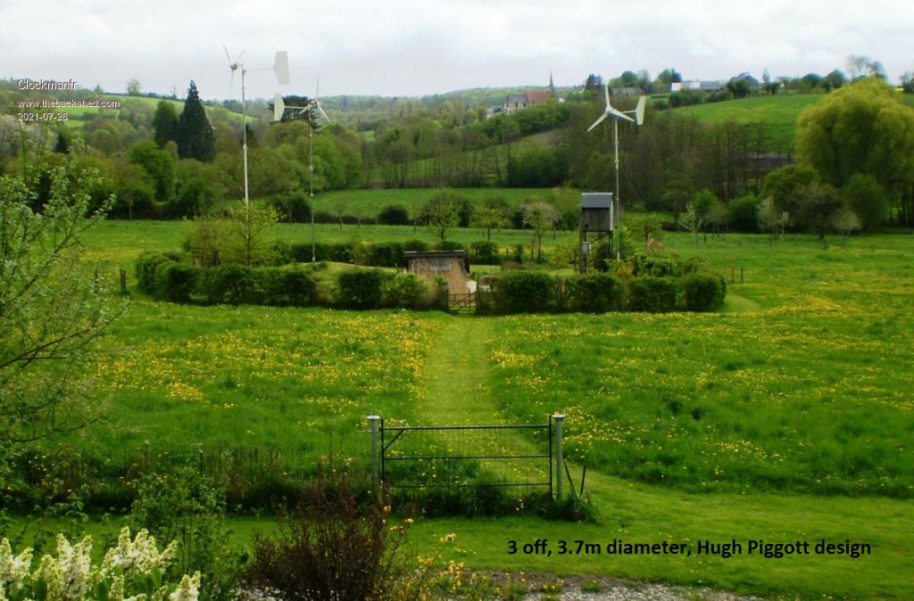

I have 3off Hugh Piggott design 3.7m diameter Wind Turbines, had them up 16 years now.
We have wound the 3 phase coils for DC battery charging at between 46v and 61v and are directly clamped/connected to the 48v battery. Any excess electricity is diverted by controllers to dump load heaters. .
The design of the blade and the PMG permanent magnet generator, are very well matched together for optimal output.  The tail design has the ability to pull the wind turbine out of the wind direction if the wind increases to dangerous and excessive levels.
But before i give you how they work etc, my main advice is DONT do domestic wind turbines, as the PV prices are really good todate, and a static array has no moving parts.
Next in real life we rate a 3.7m diameter turbine at 1kW, but the unscrupulous Chinese would call that a 3kW output, yes i have seen 3kW on one of mine just for a second before it self furls out of the wind.
I can write pages on this and controls and differing designs, but i say again honestly PV is far more productive.
I am on some Wind Turbine Forums around the World, and me saying DONT, does not always go down so well with the Armchair wafflers. But hell after 16 years flying mine. ??
I still fly mine, as its a physical visual statement but every year each need a service and re-balancing the blades and servicing 3off can take up to 2 weeks of my time. So PV every time now. At present only one is working as another needs balancing again and the other has a broken blade. Hopefully by September i will have all three up and generating again. Water ingress into the blades and hub is always the main problem.

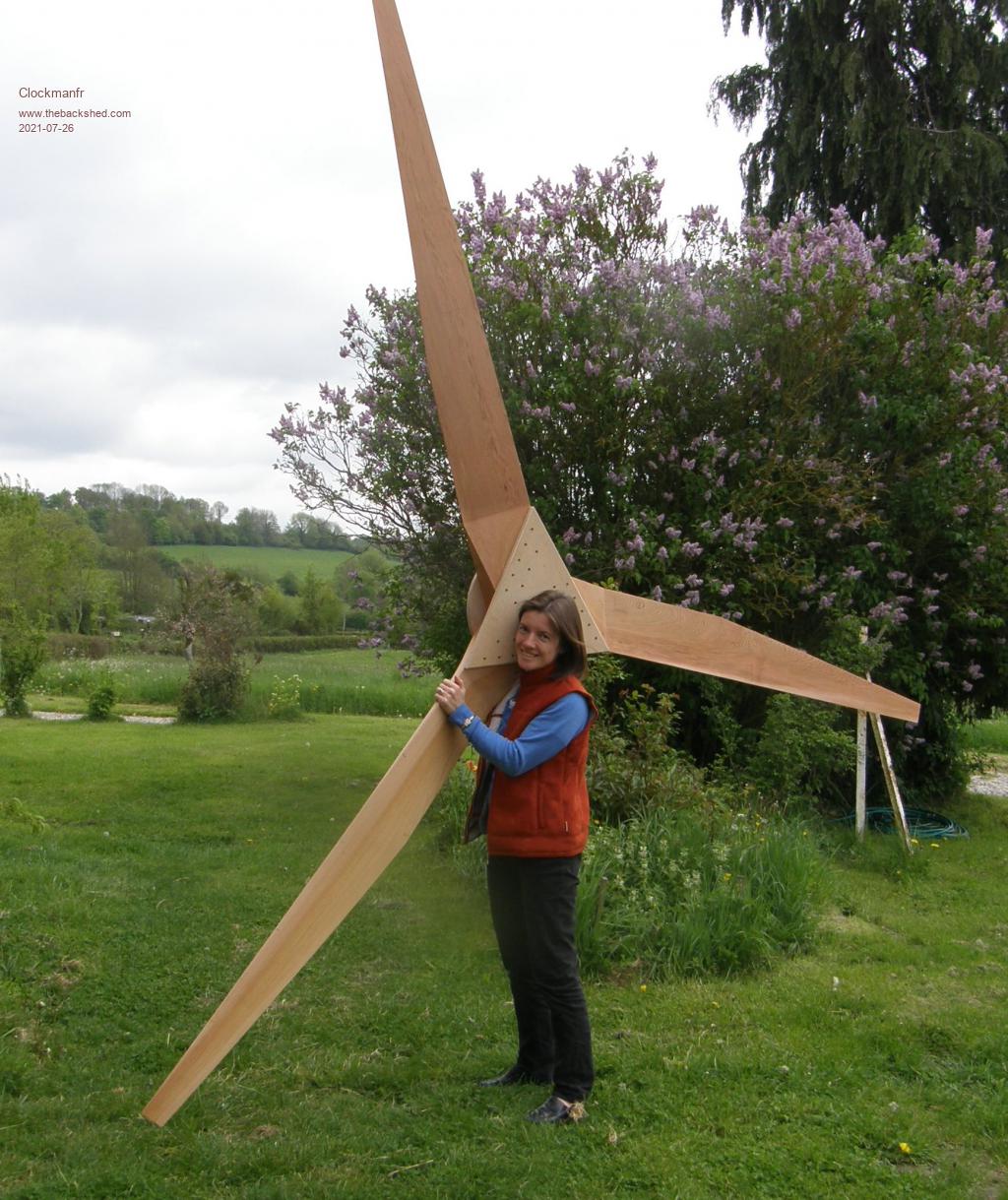

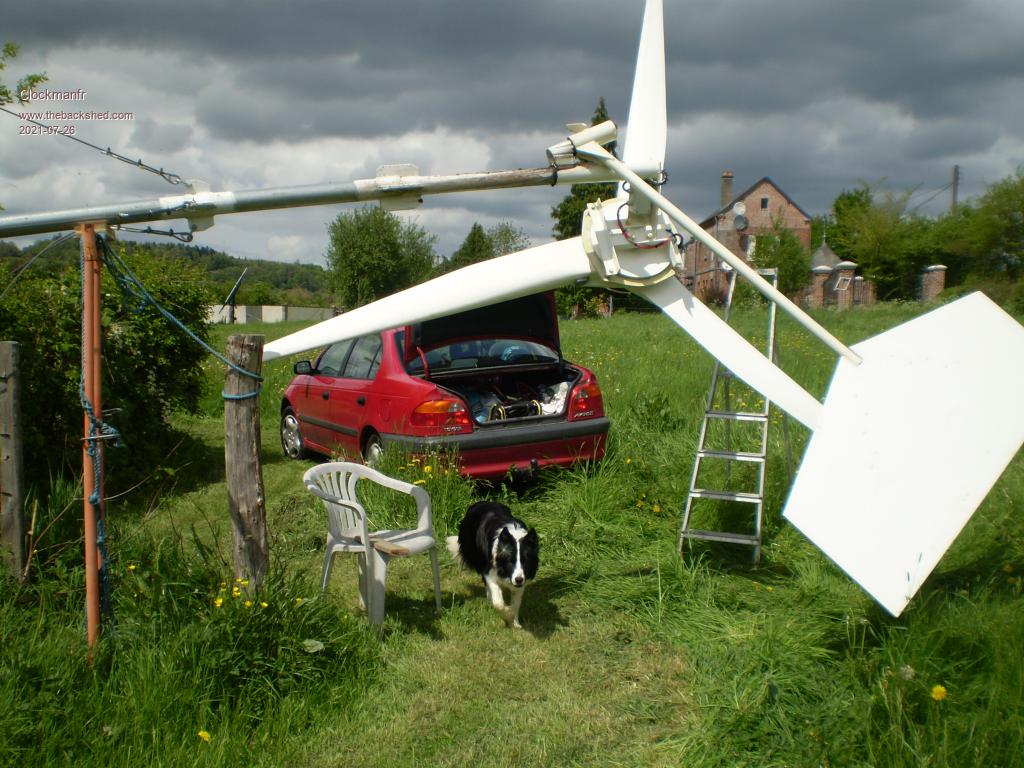

A few photos for you, Ist is Mrs in 2007 with the blades following Hughs design.

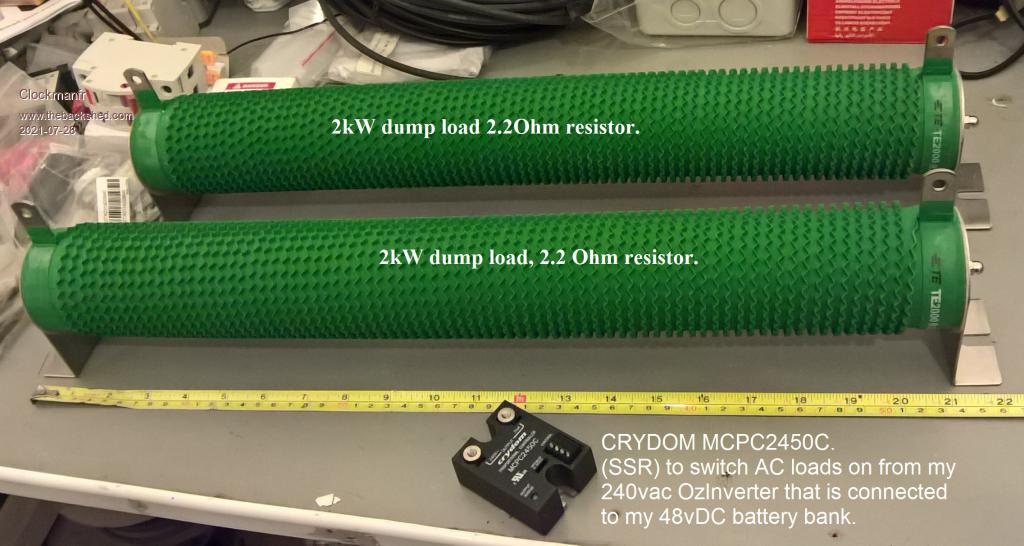

What controls will you use? High voltage AC coupling through a SMA Windy Boy?
Or to DC charging and using the battery as a Clamp?
And control chargers like the cheap but good Morningstar Tristar that divert excess voltage and keep your battery correctly charged, ie i have 4off and dump up to 8kW into other loads that are permanent connected as dump loads.

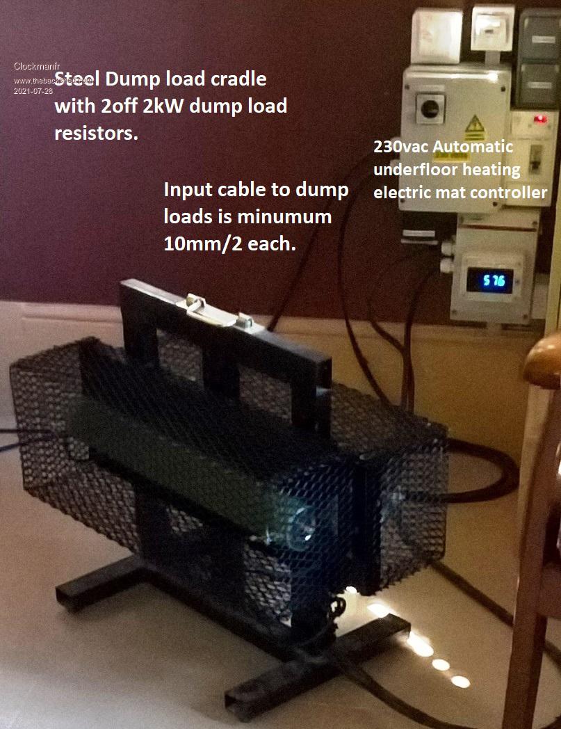

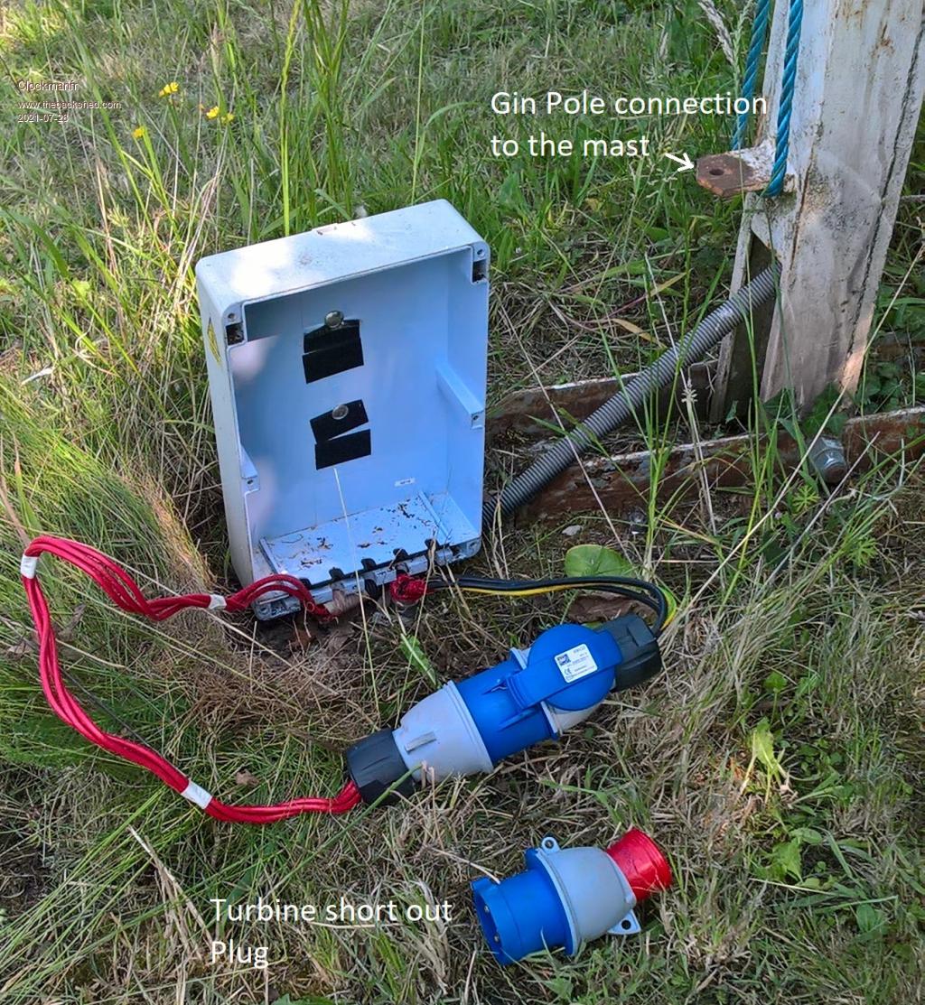

Remember without a load the turbine will go supersonic, and then its just bits. And just turning out of the wind is not fast enough.
In all options the Wind Turbine MUST HAVE A LOAD.  Its a living thing when it gets above 1kW like a horse kicking merry hell up in the air on a mast.
There is the short out electronic system that is supposed to control the Turbine like the US SKYSTREAM, but again i have not seen the short out system controllers survive more than a few years.

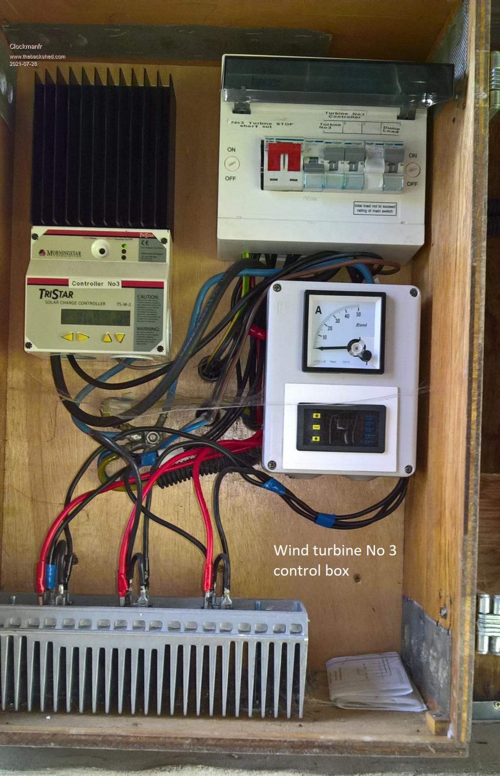

If i wish to stop mine i short out the 3 phase windings in the PMG at the turbines base, with a short out plug or at the short out control board.

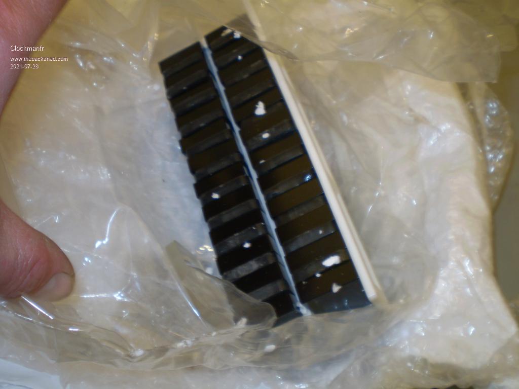

No3 Control board box.  After a year i fitted large heat sinks and better quality ac to DC rectifiers that were double the ratings.

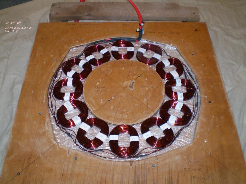

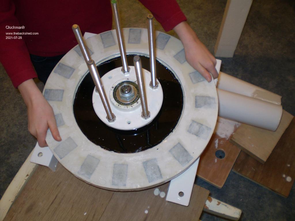

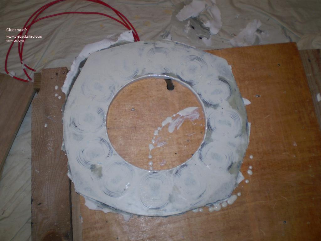

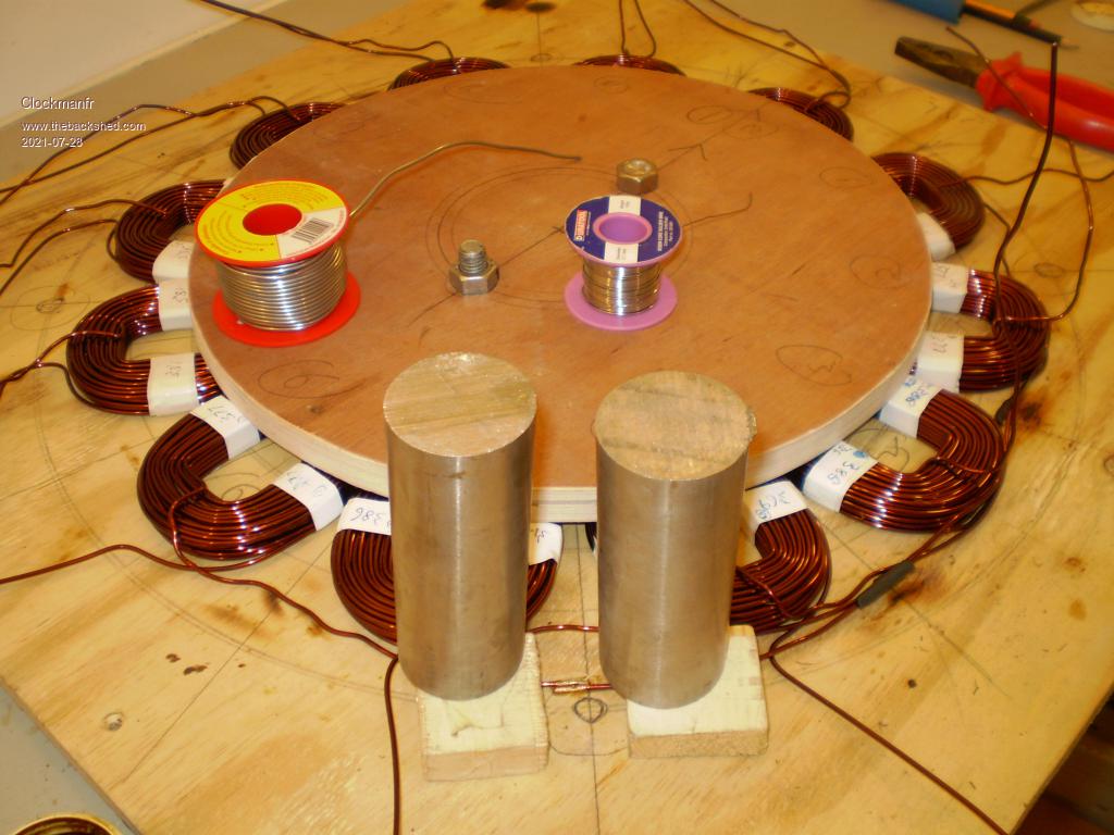

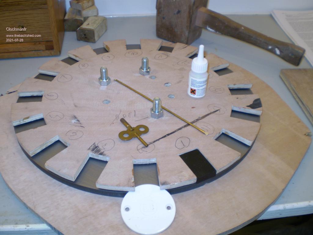

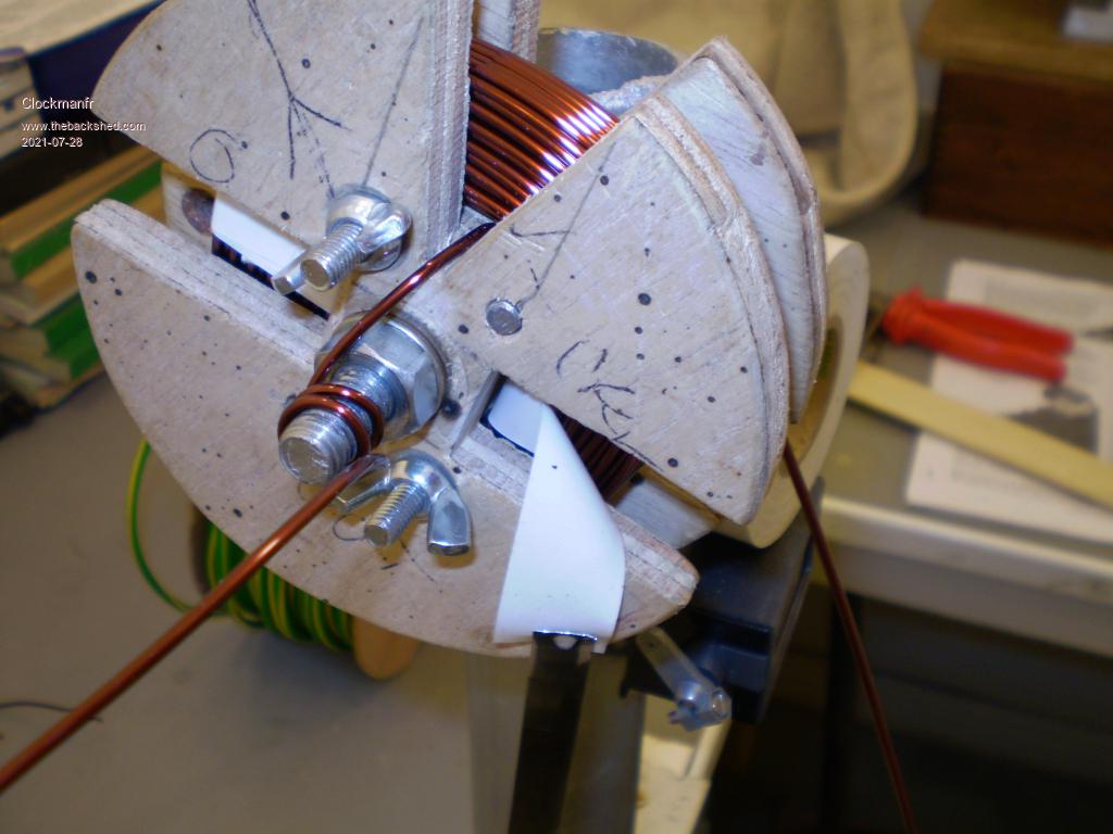

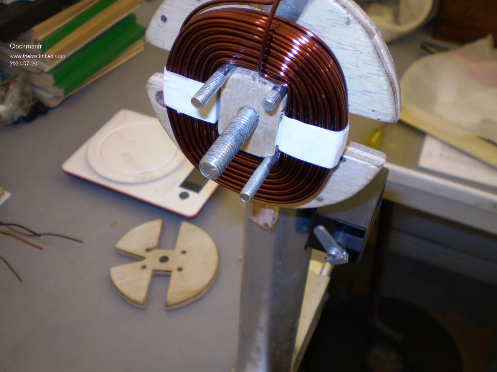

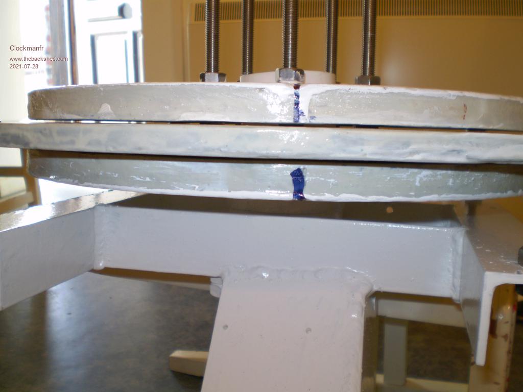

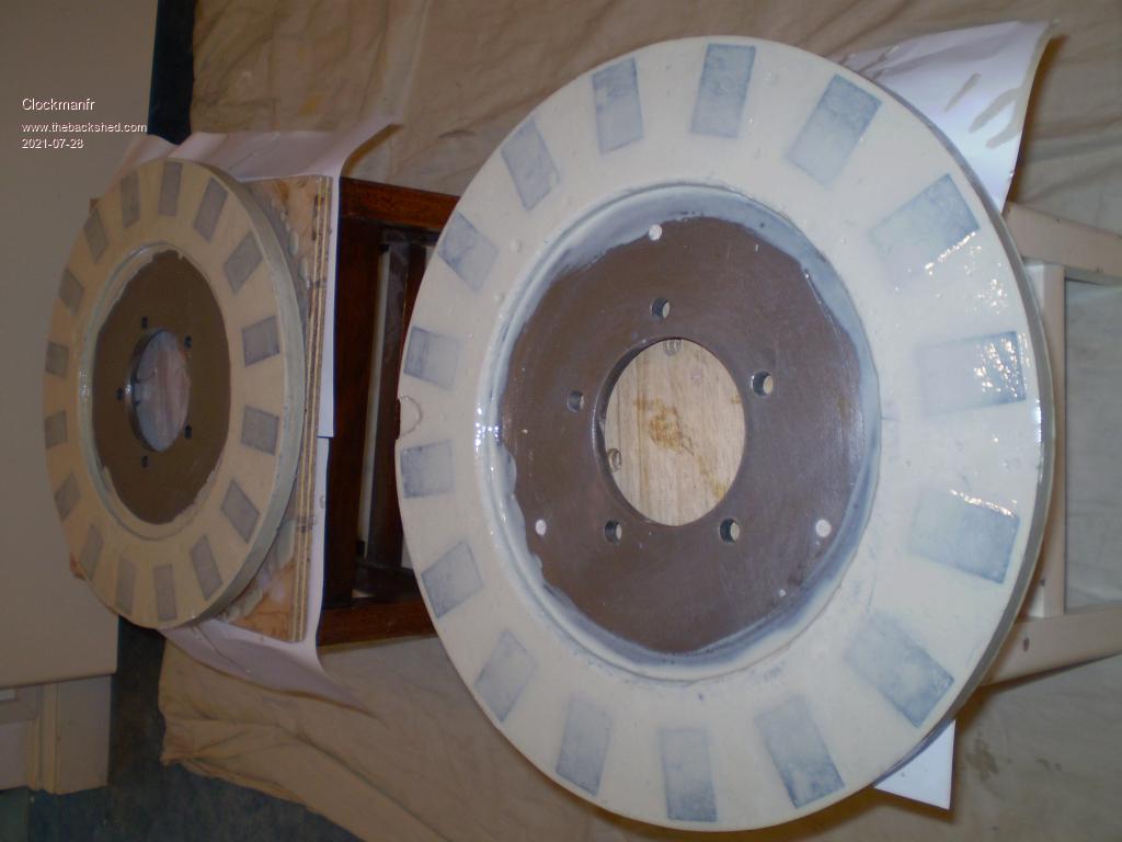

Hughs Design for the PMG, permanent Magnet Generator, for DC charging a 48v battery bank, and yes for my 3 girls, i would recommend 800ah as a minimum.

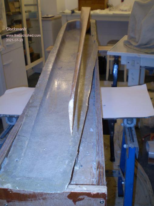

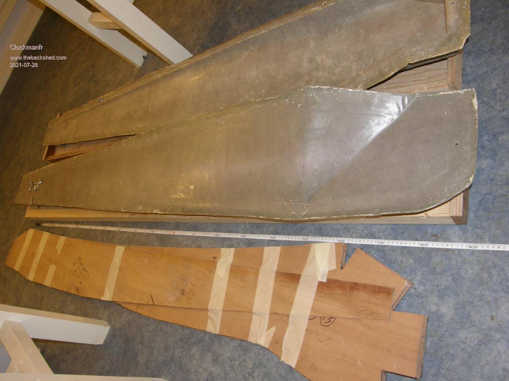

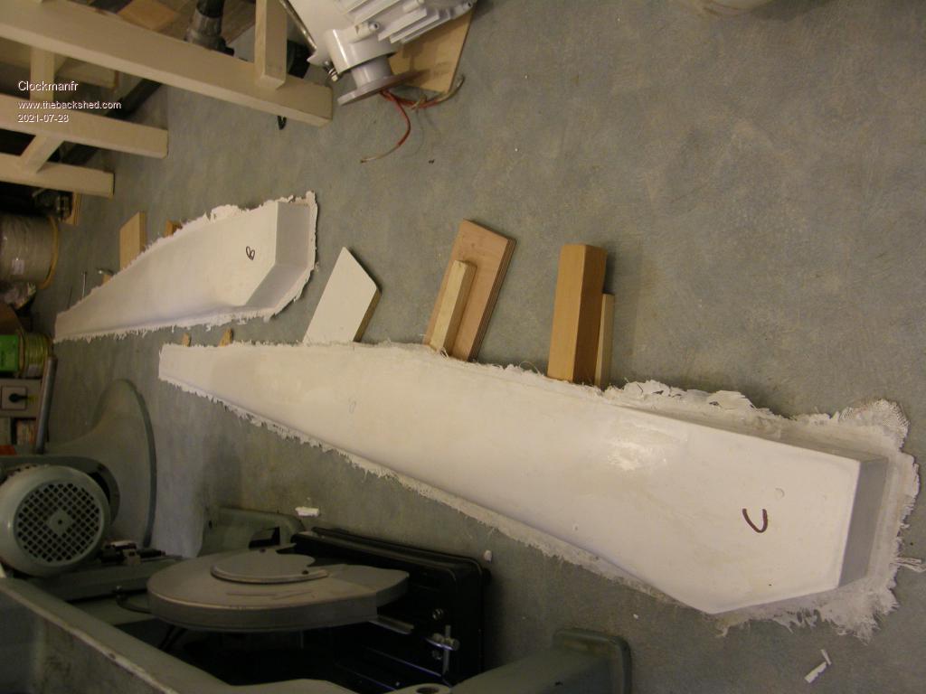

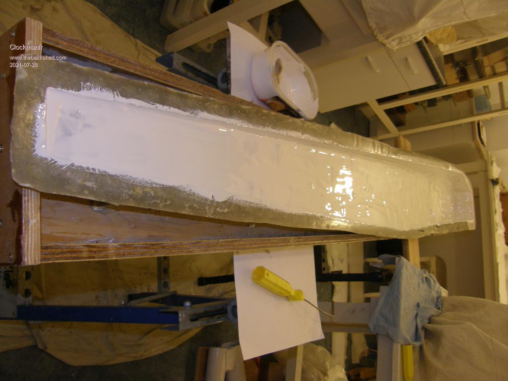

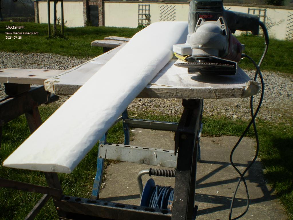

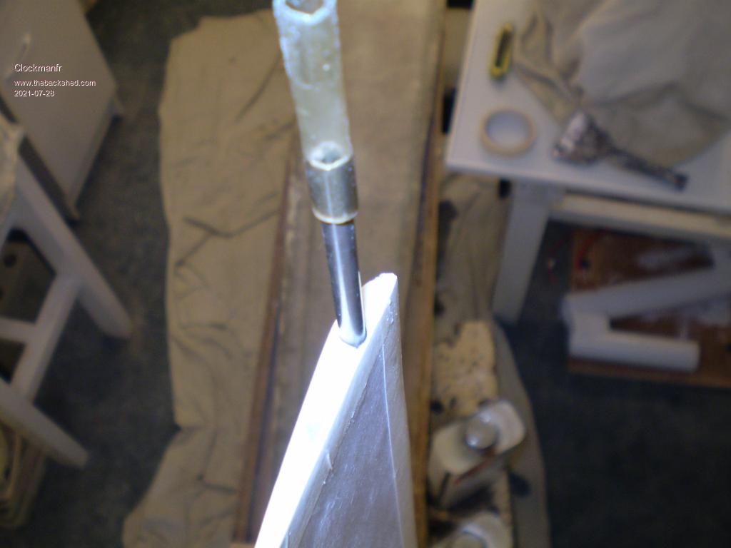

Then there is the blades.
But that is another story, again never seen any Chinese manufactured blades at 3.7m diameter survive more than a few years.
Hugh suggests Cedar wood blades hand carved to a good TSR design that he helps to show and instruct on how to carve the correct form.
My No1 was wood blades but after 4 years the water got in and these need balancing every year.
My No2 had a new design of Fiberglass blades to Hughs design, these were experimental and water got in them real quick. I will replace these with Cedar wood this year.
My No3 has my perfected fiberglass blades, and these work well but again they need balancing every year, and they are 3 times as heavy as the cedar wood blades, so balancing is critical. And yes i did discus these fiberglass blades with Hugh.

  Clockmanfr said  Hi  OOfgrid,
Hugh Piggott's design is one of the best, and he publishes a small book ON HOW TO BUILD, and explains installation, materials, site, and everything.
http://scoraigwind.co.uk/
