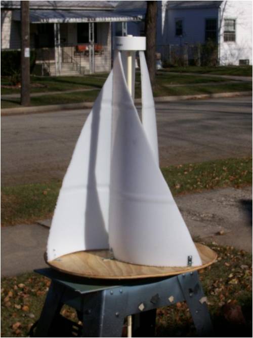

Posted: 03:27am 24 Nov 2008
This is the sail shaped Savonius type VAWT that I made as a trial. It works very good. No special shaping of the 'sails', they are simply cut direct from a 55gal white plastic drum. There are lots of mistakes in it, but surprisingly it is a very forgiving design and works well. Next is to connect a small PMM to it and make some electricity.
Dave Brown
Green Bay, WI

Posted: 11:25am 24 Nov 2008
Hey there Dave,
I like the "sail" look. I think that its always important to make these things look attractive, as they will stimulate a lot of conversation, especially in the suburbs.
I always enjoy it more, when the design looks nice.
This design would be easier to have balanced from the bottom only as well. Reducing the need for the ugly "top" part of some frame.
By the way, how much torque is in there. Put a Pmm motor on the outside of the wheel for gearing effect. Could easily power some garden lights !
"the Earth was not given to us, by our fathers, rather, it is lent to us by our children".

Posted: 11:26pm 25 Nov 2008
nice work quahogwi,it looks simple to build.
i just recived my rpm and wind guage and i am going to test my output on mine. you have a good start with your unique design, just dont stop and i am sure you will find a way to improove it.

Thanks for the compliment. I've got to admit, though, that I started off trying a different design. What I was attempting at first was to make a crude double helix type design. I first marked off the the halves of a plastic barrel at top and bottom. I numbered them 1 & 2 respectively at both ends of the barrel. Using a piece of twine I connected T(op)1 to B(ottom)2, then T2 to B1, traced a line and cut. The result, I had imagined, would have been two helical pieces which I could slide apart as the two halves of a Savonius turbine. I learned the hard way that this isn't the way to make a pair of matching helical buckets. Didn't work. Either that or my AADD took over and kept me from aligning them properly.
I remembered seeing a cloth rotor of a near conical shape. That gave me the idea to make a couple more cuts resulting in a number of triangular pieces, curved to make a belly in the "sail". A few PVC parts and a 1/2" steel tube for the axle and a plywood disk. I used ball bearings with some light oil. The result is what you see in the picture above. I haven't done any testing, but it starts is pretty low breezes. I made one earlier simply cutting a 5 gal pail in two and sliding them apart to form the typical Savonius "S", only slightly overlapped (about 10% or so). This I mounted in a simple box frame. It starts turning in much less wind than does the tri-sail one. But both do start turning in very light breezes.
I haven't done any testing but I have picked up an inexpensive bicycle speedometer/computer. With the magnet attached to the bottom of the disk and the induction coil firmly attached to the stand, and it will make a reasonable RPM gauge. As I understand it, you set the "wheel circumference" to a fictitious number of 16.66 or 166.7 or something along that order. The result is the computer calculates what it thinks is km/h, but in fact is displaying true RPM at that particular moment. I've tried it, and it works quite well. I just haven't recorded any information as yet.
I've been suffering from analysis paralysis and have to break out of that rut. I just have a couple of questions to get answered. I'll put them up seperate from this reply.
Anyway, thanks for the compliments on the configuration that I ended up with. Add some LED's, a little electrical power, and maybe some paint and I'll have s spinning Christmas Tree.
