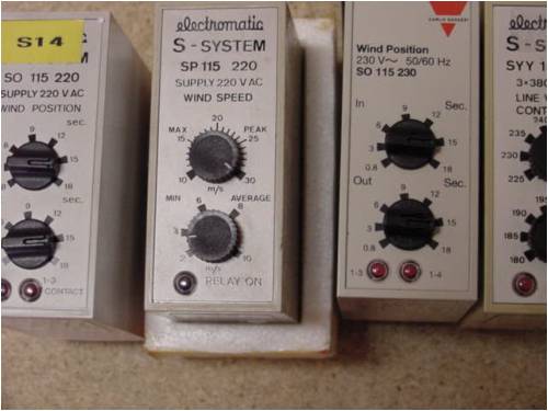

I am currently rebuilding these ones which are faulty..... they have their problems I'm afraid.
..........oztules

I have been wrestling with the furling (standard gravity style) for a bit now, and am less than enamoured with it's natural characteristics. It bucks, kicks, wanders around, get's blanked by the main rotor and starved for air.... all up it seems to be a compromise between out of control, and no power at all.
Having said that, it is important to remember that this installation (and I use the term very loosley) is only a few feet above the ground. It is very gusty and fickle with direction. This means the poor old furling has a devil of a job to stabilise.
However, as it amplifies the shortcomings of the system, it makes it easier to see where it has difficulties.
I like the idea of no tail and power yaw. It is not as simple granted, but in a poor wind site (close to the ground, or shadowed by trees perhaps), to stick to a direction unless over powered, or a true wind change occurred, then you would pick up a substantial increase on KWH over the current method.
In it's current position, it spends a lot of time in the 300-700 watt area, when it could easily be in the 1kw area constantly if it had a dynamic pitch control, or a smart yaw system.
So I am still waiting to see the Dingesman super yaw system.... so I can run out and copy it.... might even have welding gas by then.
