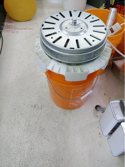

Here's my idea. First, my rotors are metal, with a bit of plastic hub with a metal spline ring for the shaft retention.
I want to heat the epoxy adhesive, but without damaging the hub. I think I will try surrounding the hub with ice and running water, while I spin and heat the outer most rim, where the magnets are held. If I do it fast enough, it should work before the heat overcomes the cooling method.
Edited 2021-04-23 12:57 by Kamak

Thanks for the tips. I might just try that. These are metal rotors, so I wasn't too worried about using heat to remove them, other than the bit of plastic at the hub.
As for the spacing, yes it does have to be precise with relation to the windings, evenness, and number of pole pairs. there are 24 pole pairs on these rotors (48 mags in total), with 36 total windings of 12/leg x3 so I'll probably stick with that, but as long as the pole pairs aline with the common winding of each leg throughout rotation it'll work, just creates a different freq.
