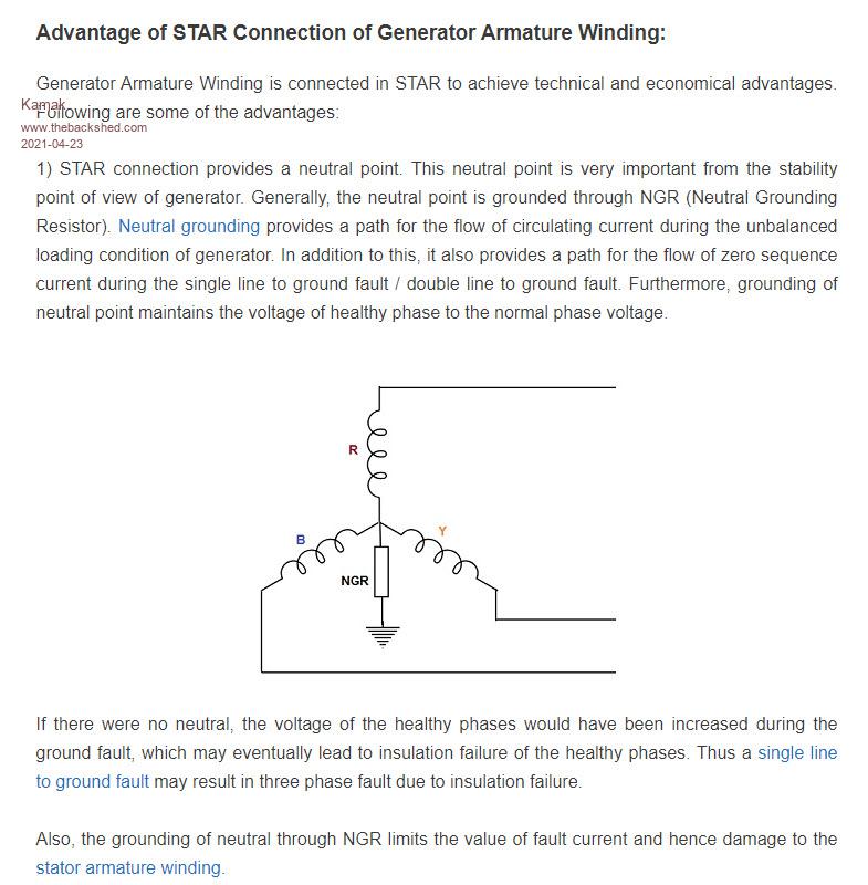

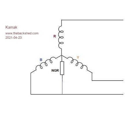

Maybe also important to note. You would have to put the load across one of the phase leads, and the shared common, in a Star wound generator.
https://electricalbaba.com/why-generator-armature-winding-connected-in-star-not-delta/
Why Generator Armature Winding Connected in STAR, not in DELTA?
May 13, 2018, by admin
Alternator or generator armature winding is always connected in STAR, not in DELTA. We know that a rotating magnetic field in the air gap can only be created if the phase winding and phase currents are 120deg displaced from each other in space and time respectively. This can be achieved either in star connection or delta connection armature winding in the alternator. But star connection is always preferred over the delta connection due to its advantages.
Edited 2021-04-23 00:27 by Kamak

And what you'll get is some unwanted cogging vibrations, as it loads one leg of the star windings.
