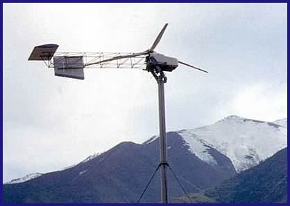

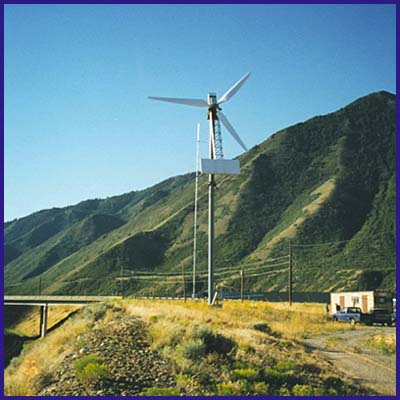

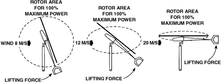

A company in Hong Kong made a range of wind turbines with furling over the top rather than to the side. The company seems to be gone now and all I have from them is a few pictures of how their wind turbines looked.
In one of these pictures you can see its size in comparison to a small building and vehicle.

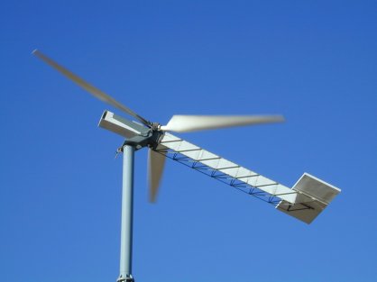

This lot use a similar system.
Soma

The wind turbine pictures I posted of the larger machine use a weight that can be lowered down inside the tail and the wind speed at which it furls controlled remotely. Clever and fool proof, if anything should ever break it means the machine will always furl early.
